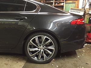

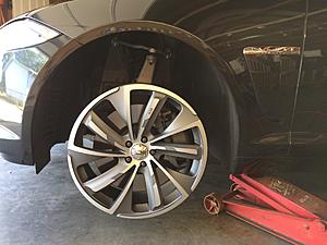

I went with the Continental Extreme Contact DSW 06 Max-performance all seasons when my factory Dunlops were recalled on my 2013 XF 5.0SC. They have been good, but the sidewalls are very spongy.
I bought a set of aftermarket 20" wheels and installed Pirelli Sotozero winter tires on them. I choose to go with 255/35/20 rubber (correct size to keep speedo correct) on all 4 corners as skinnier tires are better on snow. I used them 1 season (about 4 months) and they have been sitting in my shed for the last 1.5 years as I no longer drive her in the snow.
If you want, I would make you a killer deal on my winter set. Ready to go, even has the color matched tuner lug nuts. I am not that far away from you, I would be will to meet you half way. Private message me and I can give you current pics and more info if interested.
