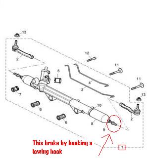

So 4 days ago I sent the car back to monterrey on a towing bed hoping to get the above issues repaired..... Now comes the worst part, the towing guy, hooked the car on the end of the steering rack and broke it when unloading it. (He has no insurance).
Now the dealer tells me the part is 7k, I called jaguar in houston and they also told me that I have to buy the whole steering asemply for just the end joint. but they sell it for 4k plus 250 core charge... and that the screen might not be coverded under warranty...
Could you please help me by pointing me out where I could source a steering rack (I dont know if the xfr is the same as de xf), and maybe someone has also a clue about the black screen.

car-part.com is the US used parts recycler web listing site I use. Ask Jag Houston to let you know if the XF, XFSC and XFR all use the same part number for the rack.

Here is one on ebay for $448 + shipping any shop should be able to change out a rack and pinion.

Also forgot to mention I had already seen that ebay one but, it states it is not for supercharged verisons and jaguar houston could not tell me if it was the same part number for all xfs...

Well some good news.... I found a new xf inner tie rod. I just need someones help to veryfy that the left and right tie rods are the same and also that all xf inner tie rods regardless if it is an xfr are the same.
