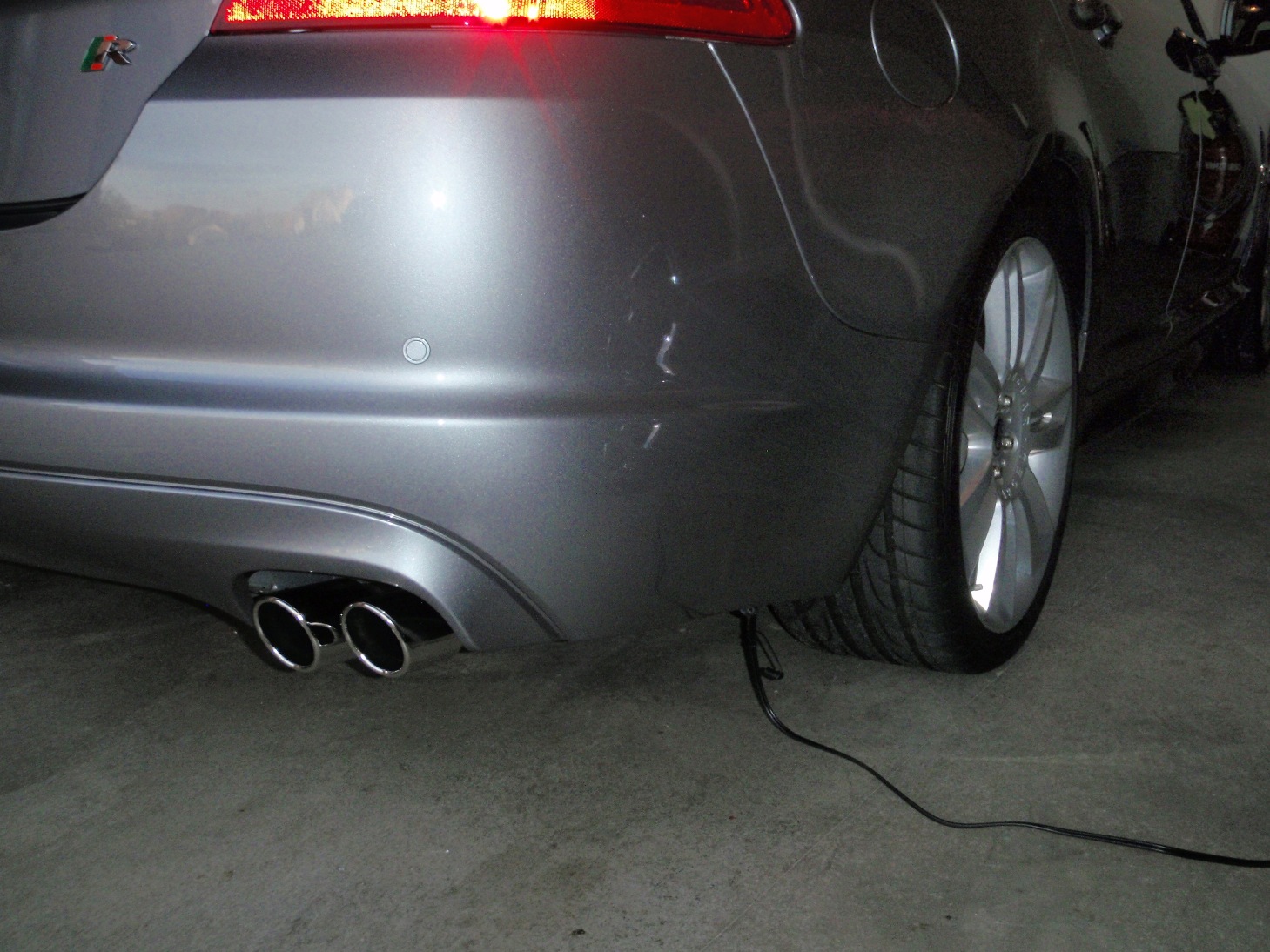

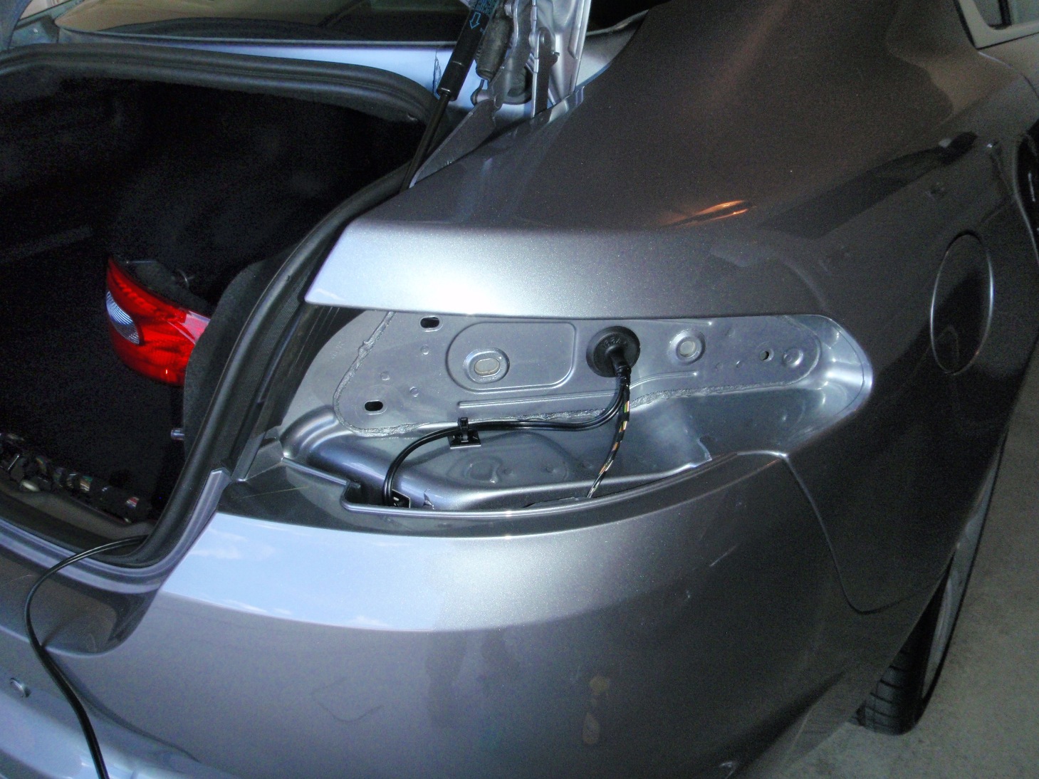

Another big fan of Deltran "Battery Tender" units. It's usually the first mod I do to all my vehicles. Best thing about Deltran are their multi-bank units - you can manage multiple vehicles with one multi-port Battery Tender.
I also leave all my non-primary use vehicles plugged in all the time in order to keep the batteries constantly at full charge. Deltran is very good about having many options for lead wire lengths, extensions, etc avail so doing a permanent lead install can be done rather easily. All lead wires come with weather-proof caps at the end so having the lead exposed on the outside of the vehicle is not an issue.
Installing the lead wires on the Jag was quite a bit more challenging as the battery is in the trunk. Obviously much more difficult to install the lead to an inconspicuous place on the outside of the car. I used the conveyance for the right rear tail-light wires as an access point - then ty-wrapped the lead wire along the inside of the bumper cover, dropping it just behind the right rear tire. While not COMPLETLEY convenient for plug-in and removal, it really isn't that bad to do. Positive lead was attached to the battery, negative lead was attached to main chassis ground.
My goal (and the best thing) is that a charge point is always readily available (simply plug it in), it completely disappears when not plugged in, and will not interfere with car covers or any other accessory. The only con of this install method is the lead wire must be chopped at one end (in order to fish the wires though the rubber grommet), then soldered back together inside the trunk.
Here are some pics of the install and the finished result - they may take a few secs to pop-up:
Attached Thumbnails XFR Trickle Charger-pa140065_sized.jpg   XFR Trickle Charger-pa140066_sized.jpg   XFR Trickle Charger-pa140068_sized.jpg
