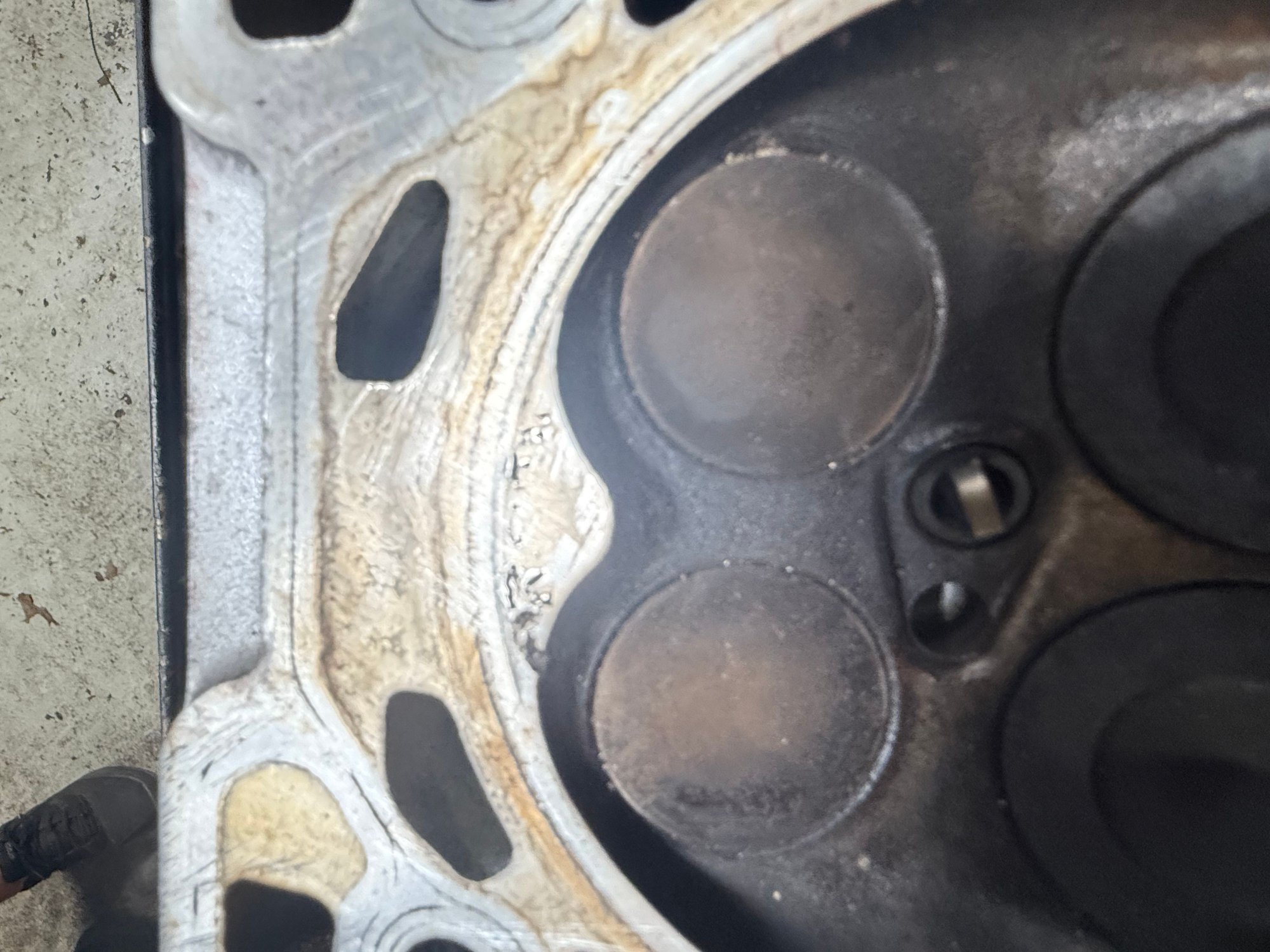

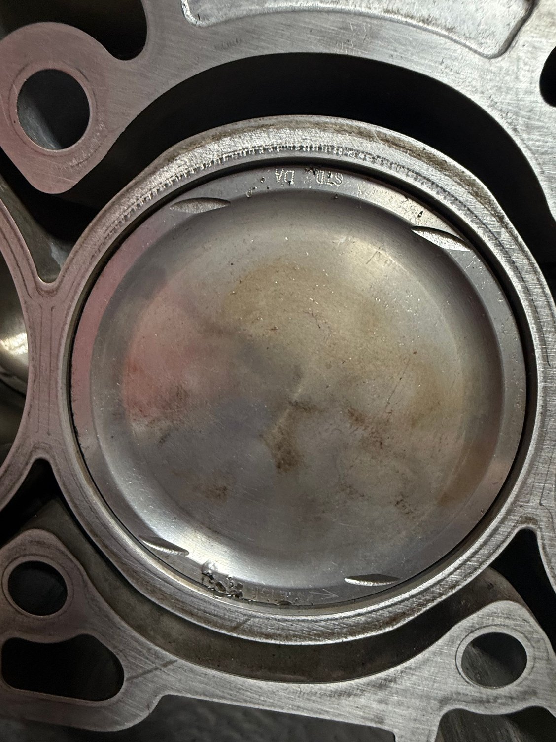

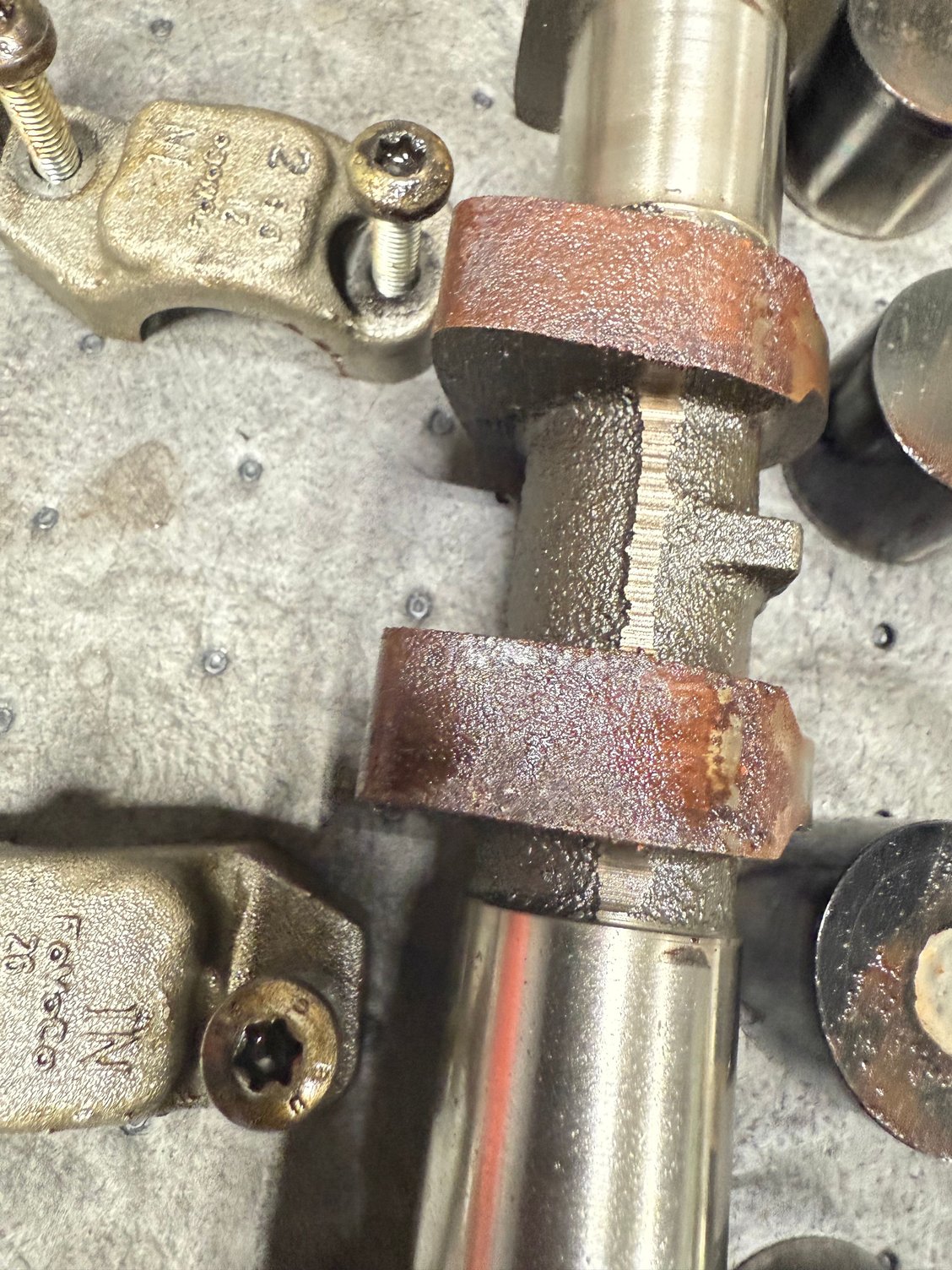

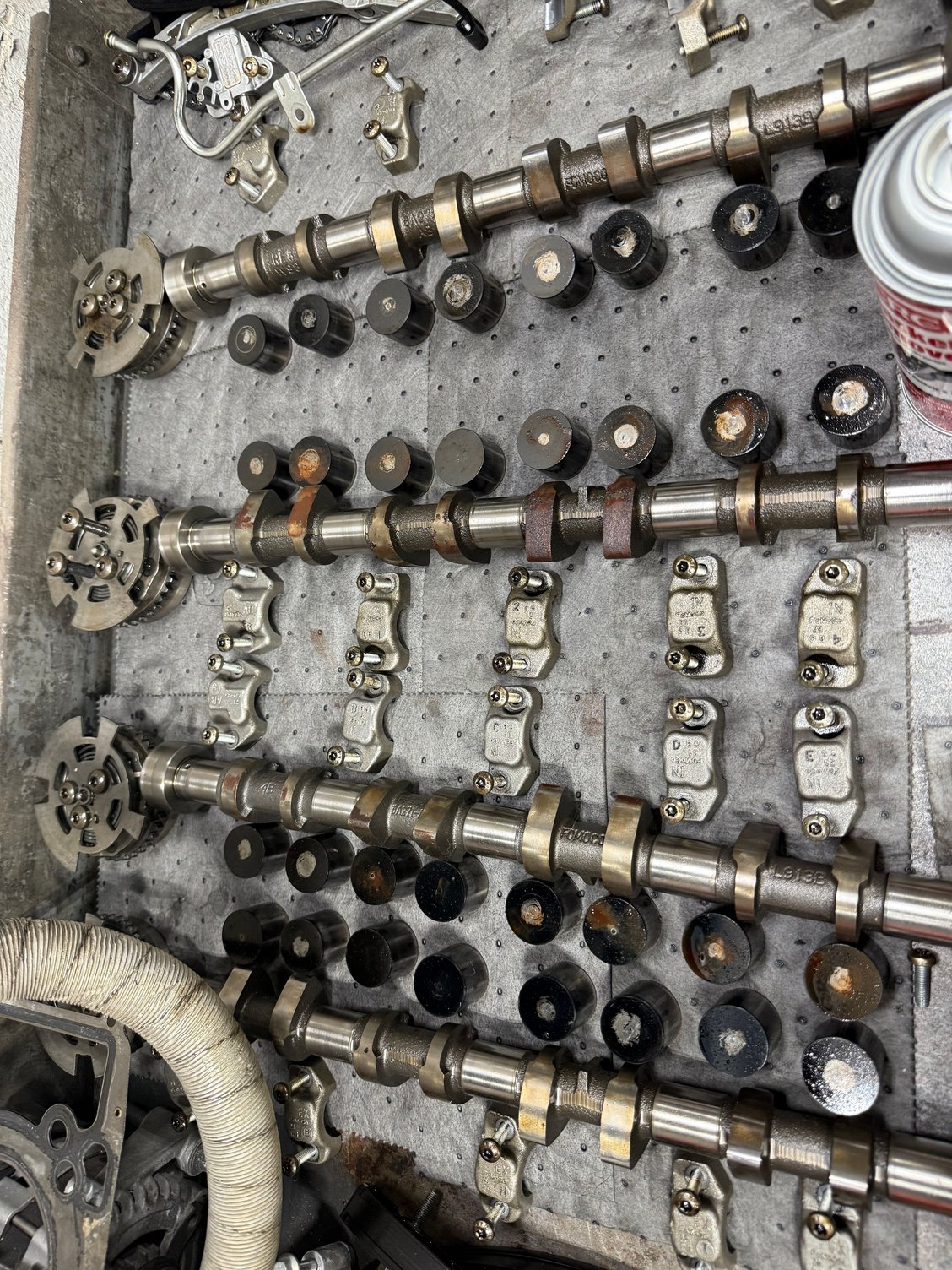

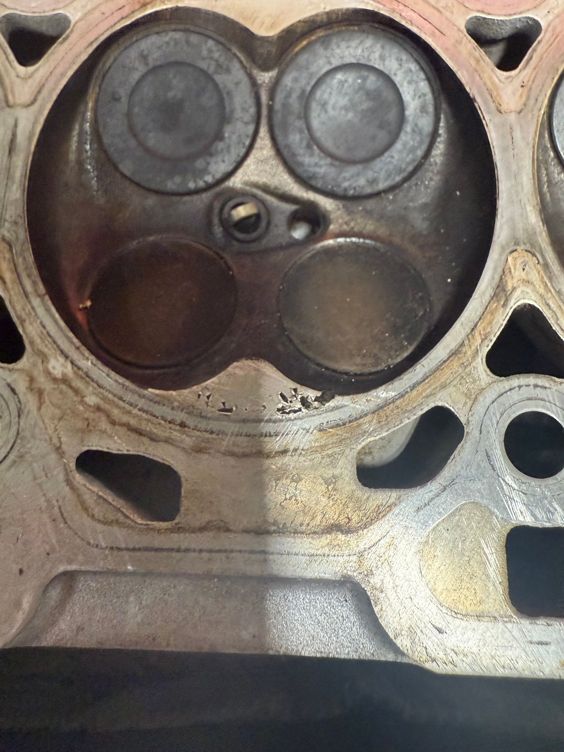

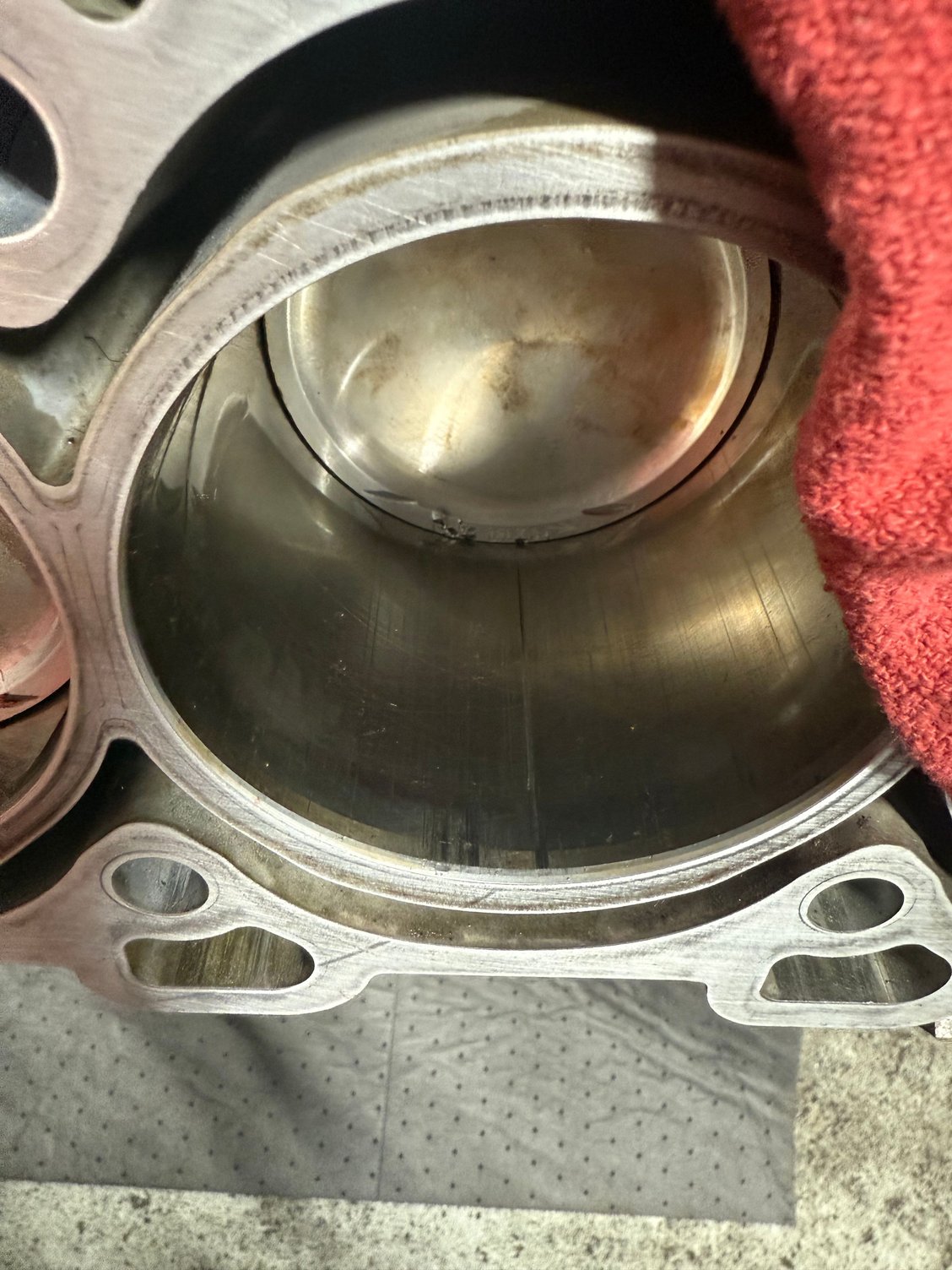

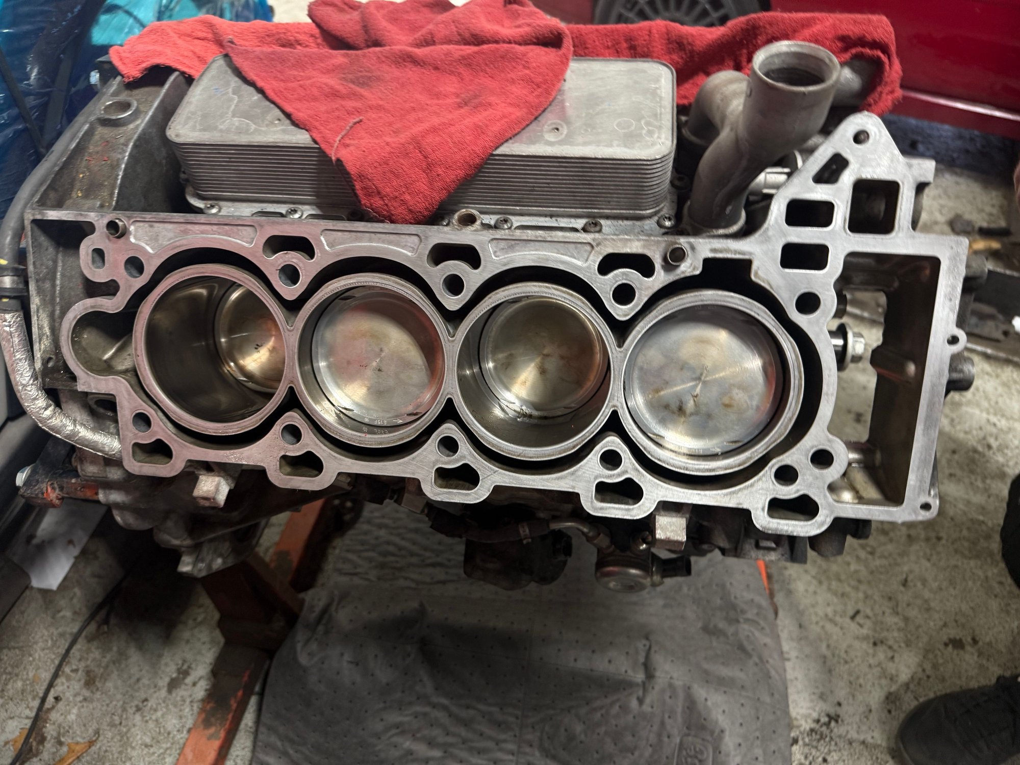

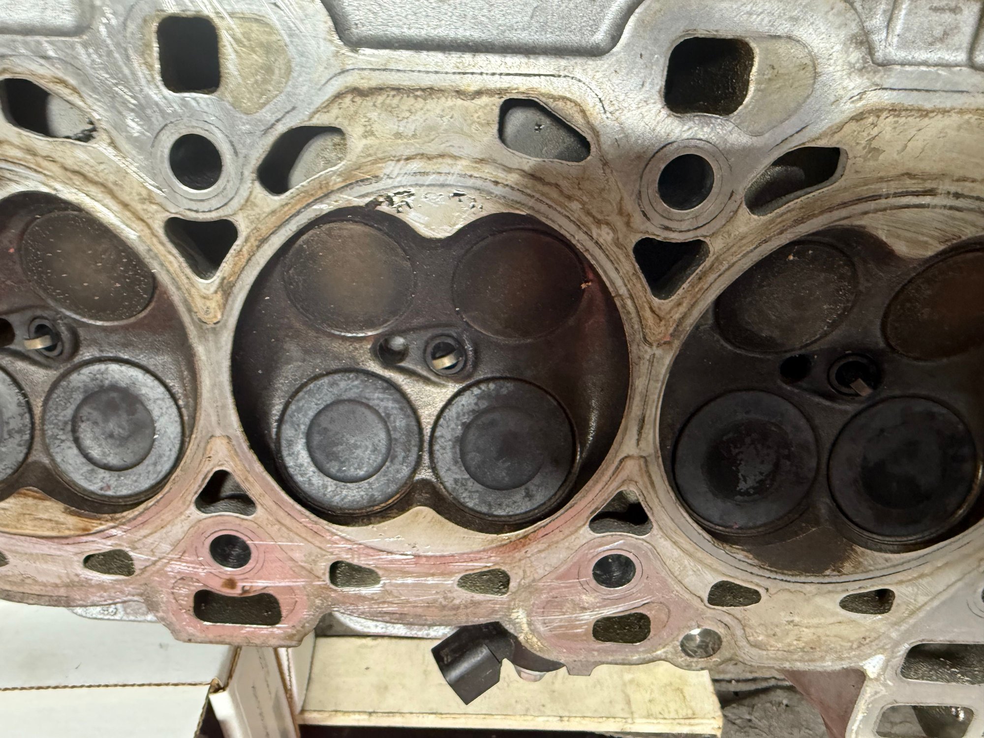

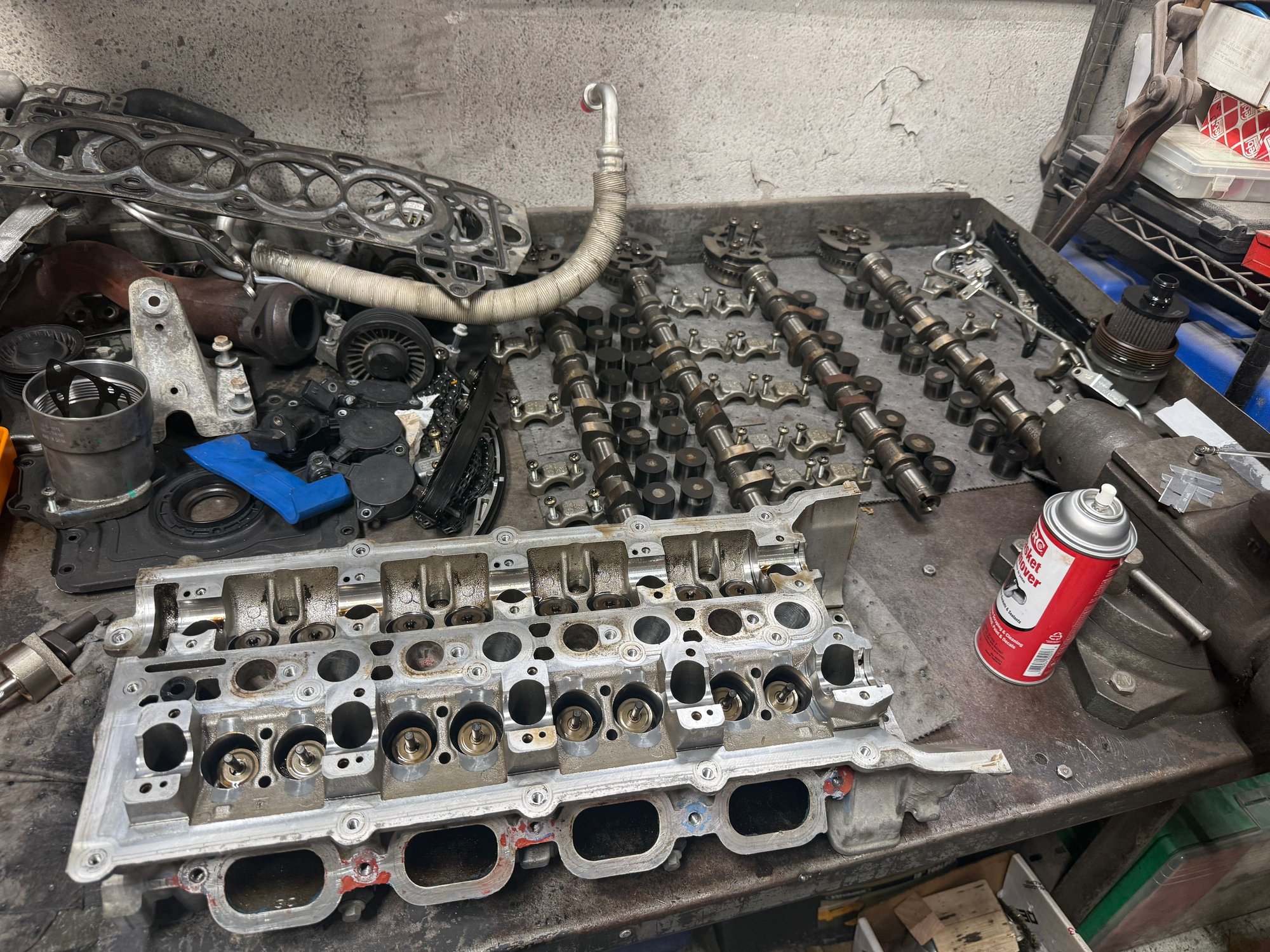

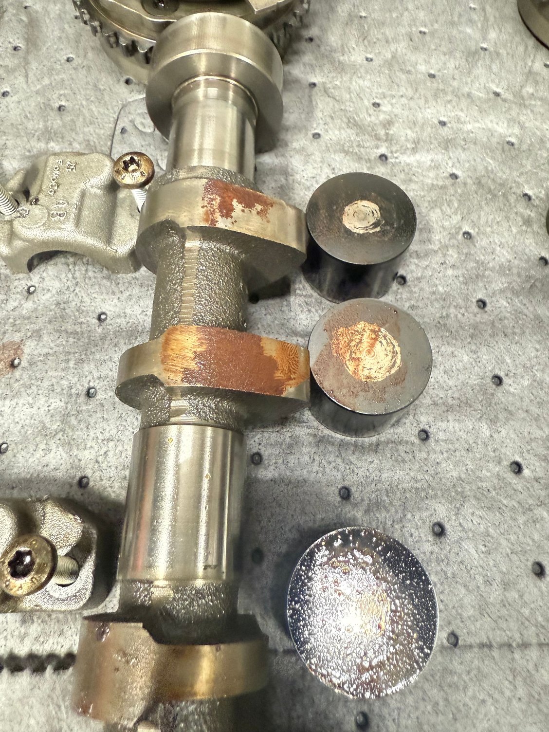

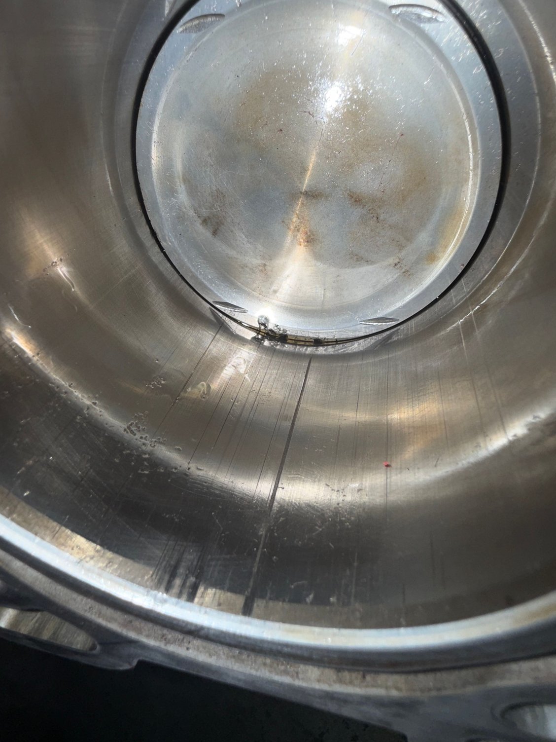

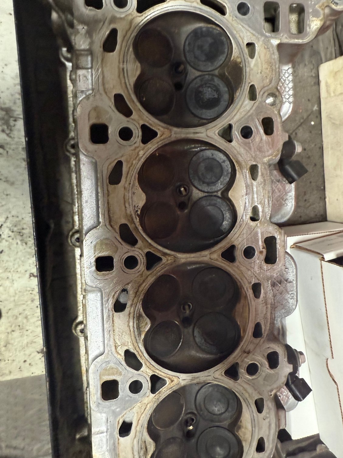

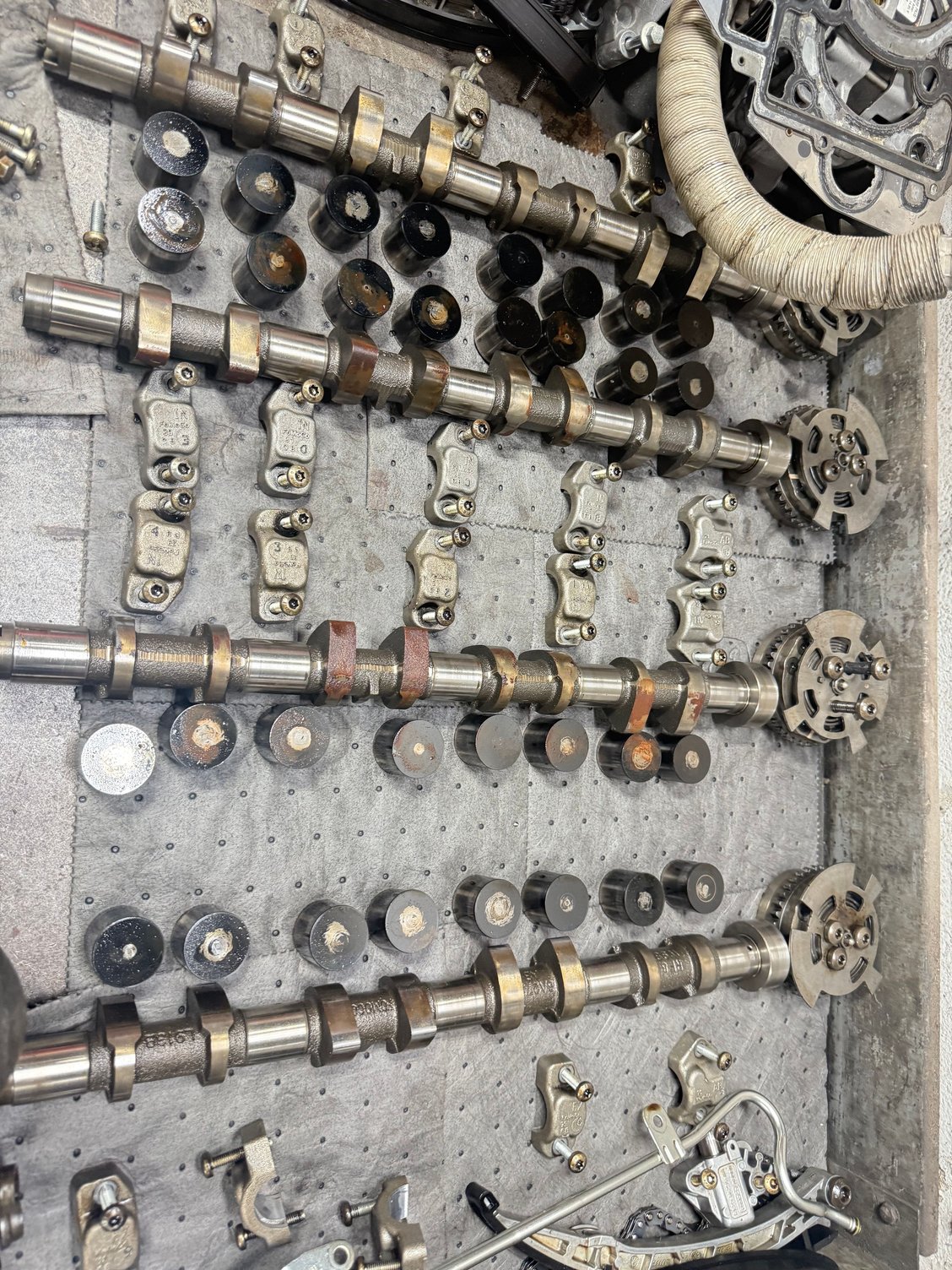

Poor girl has been down since March. Well instead of just head gaskets we found more extensive damage. cam lobs were rusted and, hydraulic lifters/buckets slightly wore bc of it and had some damage in the 2nd cylinder on the left looking at the engine from font of the car. had a line of deep scoring down the center of the wall so now it needs to be sleeved and the piston replaced. On top of that when the valley pipe blew that started all this it warped the block and heads .003" which is within shaving tolerances. Ill likely buy a new engine to replace this but may build it back in the future with some forged pistons or something. TBD. I already have upgraded head studs and new timing parts ive bought ready to install before i found out about the cylinder wall. new plugs, coils belts etc. which is minor considering what needs fixed. Does anyone have an engine they know about in good condition for sale OR anyone have any thoughts? help locating a new/ remanufactured 5.0L S/C for a long block would be helpful. My supercharger is freshly rebuilt and ported so dont need a replacement S/C. My thinking as of now is since the motor is out of the car just get a new reman motor for the time being and rebuild my old one bulletproof so to speak over time. been a while since ive been on here hope everyone is doing well during the holidays.

Talk about bad luck! Hope you got some mileage out of it before things went wrong?
I see a re-manufactured long block for around $10K and used engines starting about $6K on Ebay.
5.0L SC Engines
Here is a set of .025" over size pistons, rings and wrist pins.
Over Size Pistons
These are from Euro-Amp and they are worth a look as they carry a lot of JLR parts.

That small of an overbore won't mess with the actual running, it's done to allow a fresh machine pass on the cylinders to give a good sealing surface.

From my experience with both the AJ133 and AJ126, if the block is warped it must be replaced as the entire block is distorted and cannot be machined back to allow proper sealing. The cylinder heads can be successfully machined to provide a proper sealing surface with the block.
Most of the internal parts for these engines being sold on eBay and other parts websites are from China. With the amount of labour involved, I certainly wouldn't trust them.

Agree with RoverJoe. It's just a bit of clean up to insure clearances are correct. Same idea when skinning heads and blocks. Take small amounts off to return things to factory clearances.

New engines are available from JLR main dealers in the form of a 'long block' for roughly 18,000$US to 25,000$US depending on the VIN. There are some aftermarket places that claim to be able to 'rebuild' the AJ133 or AJ126, but have inconsistent results.
The blocks cannot be brought back to the correct form as the block itself, being made of aluminium, distorts. Removing or skimming material from the surface facing the cylinder heads does not create a good sealing surface as the entire block is distorted. If it were made of cast iron, that would be possible.

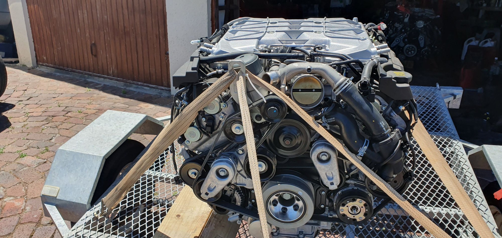

Hey Joe. Dont you wish you had one of these.
