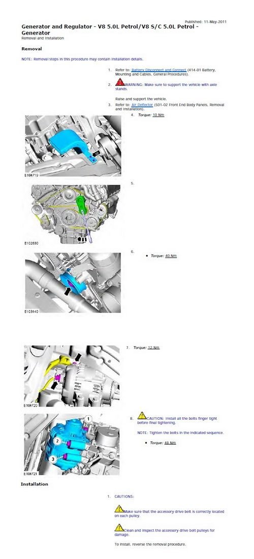

Old Jan 15, 2022 | 01:41 PM
Likes: 17,011
Here's the Workshop Manual procedure for my XK with the same engine. I expect the X351 will be a similar sequence - attack it from underneath the vehicle with the shrouds removed.

Default Alternator
Thank You for the info. It was easier than some people make it out to be. My dilemma now is that the one I took out doesn't look like an original. It has no label or part number. I am going to replace it anyway. Best brand? AC Delco or Denso?
