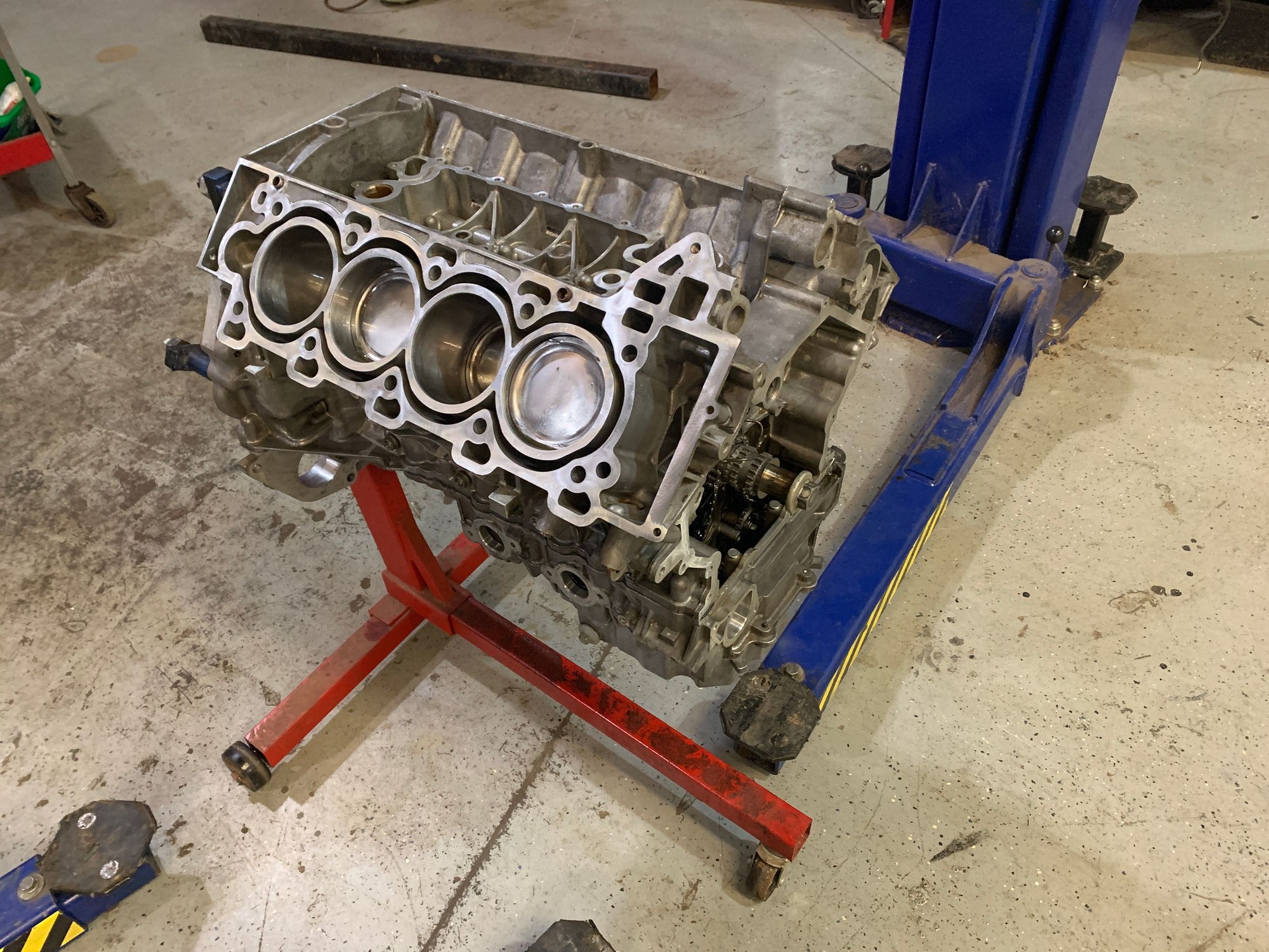

Sure is a shame to see that busted block!
Massive damage.

"littledan", I admire you ambition!!

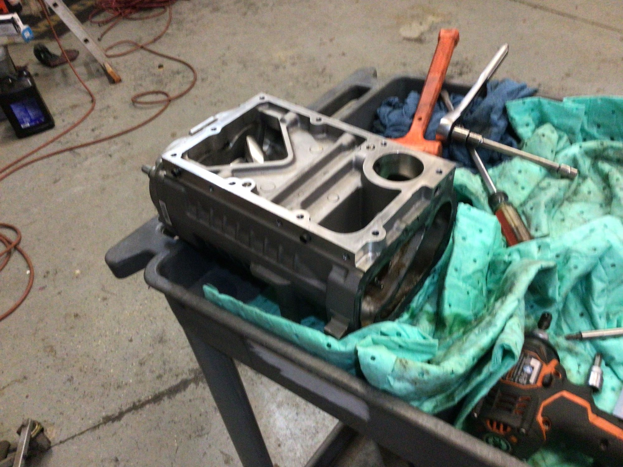

Default Engine going back in.

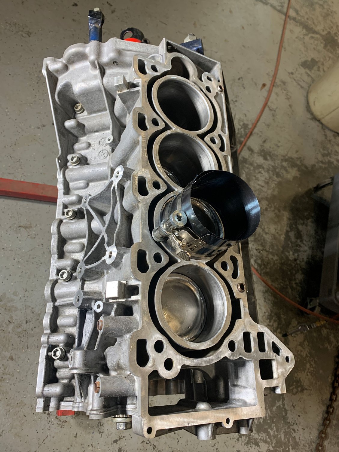

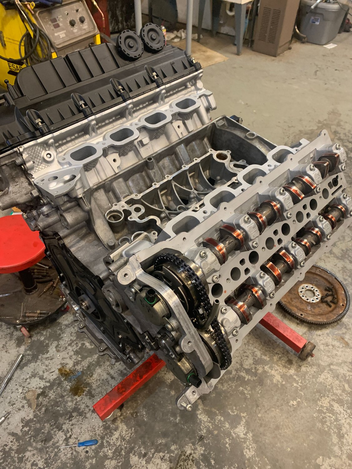

Piston and rings going in.
Beautiful

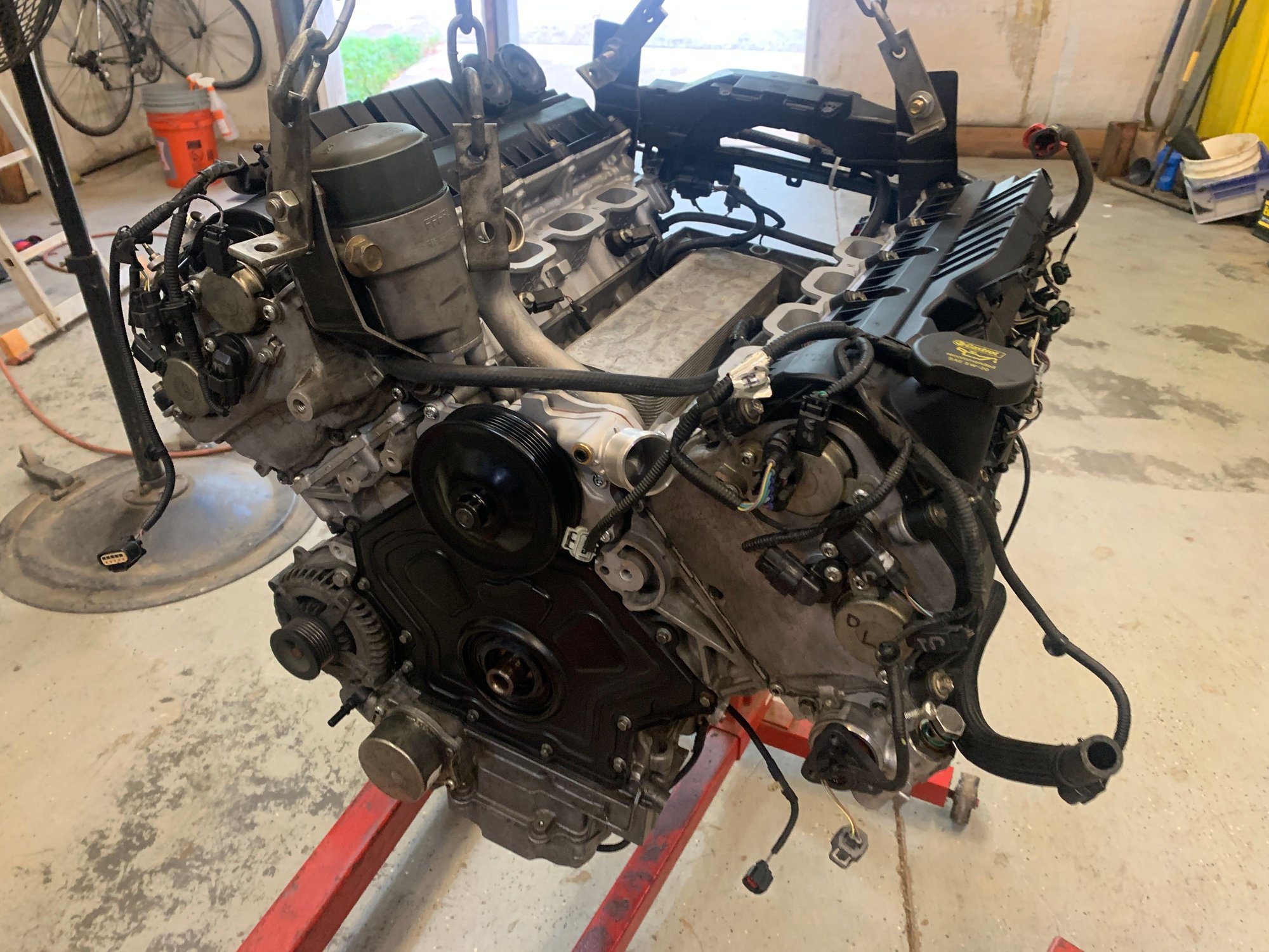

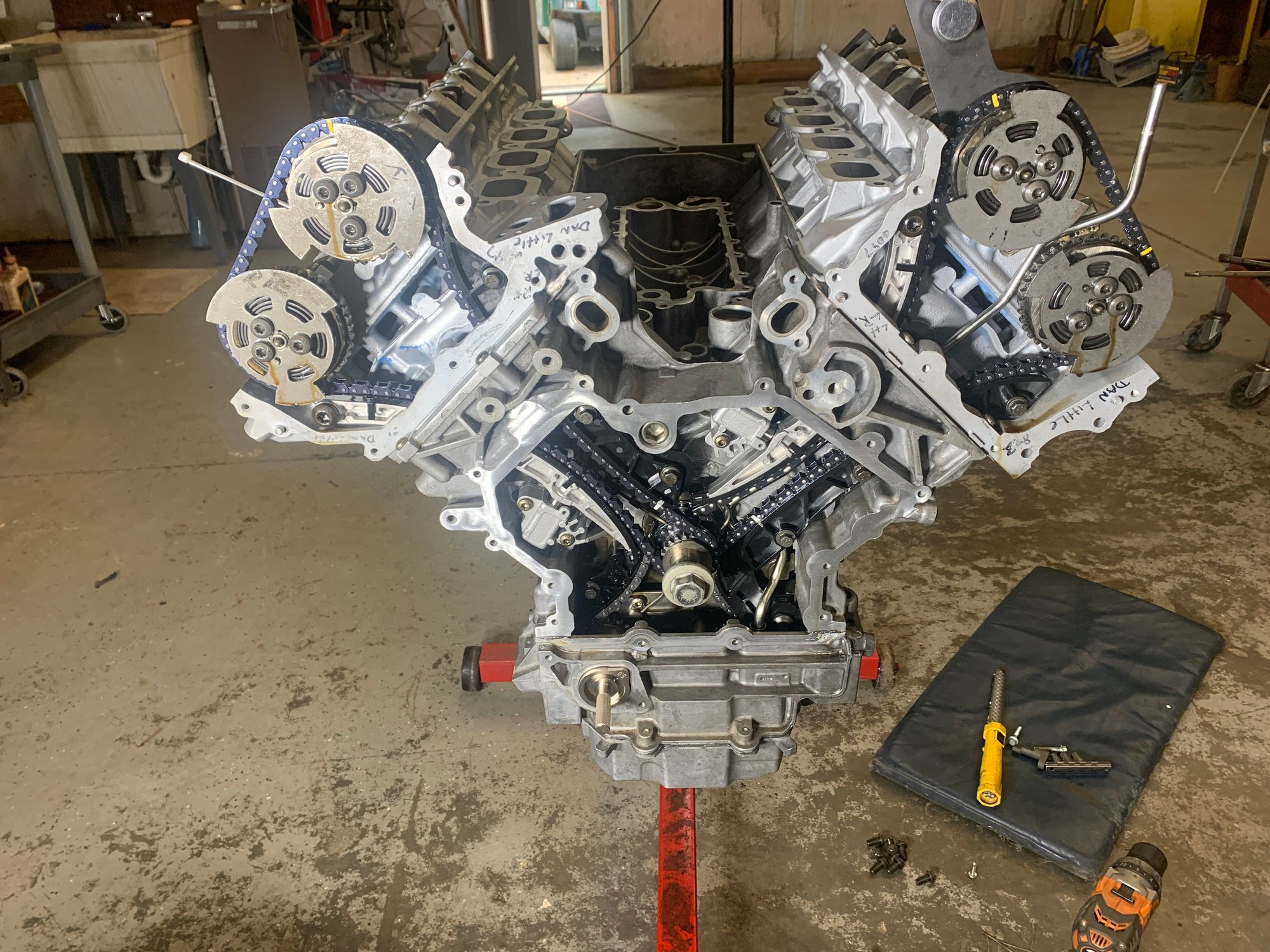

New chain kit
Ready to go in,
Dropped in with ease.
Old Oct 12, 2021 | 09:18 AM
littledan's Avatar
Joined: Jun 2021
Posts: 27
Likes: 23
From: GA

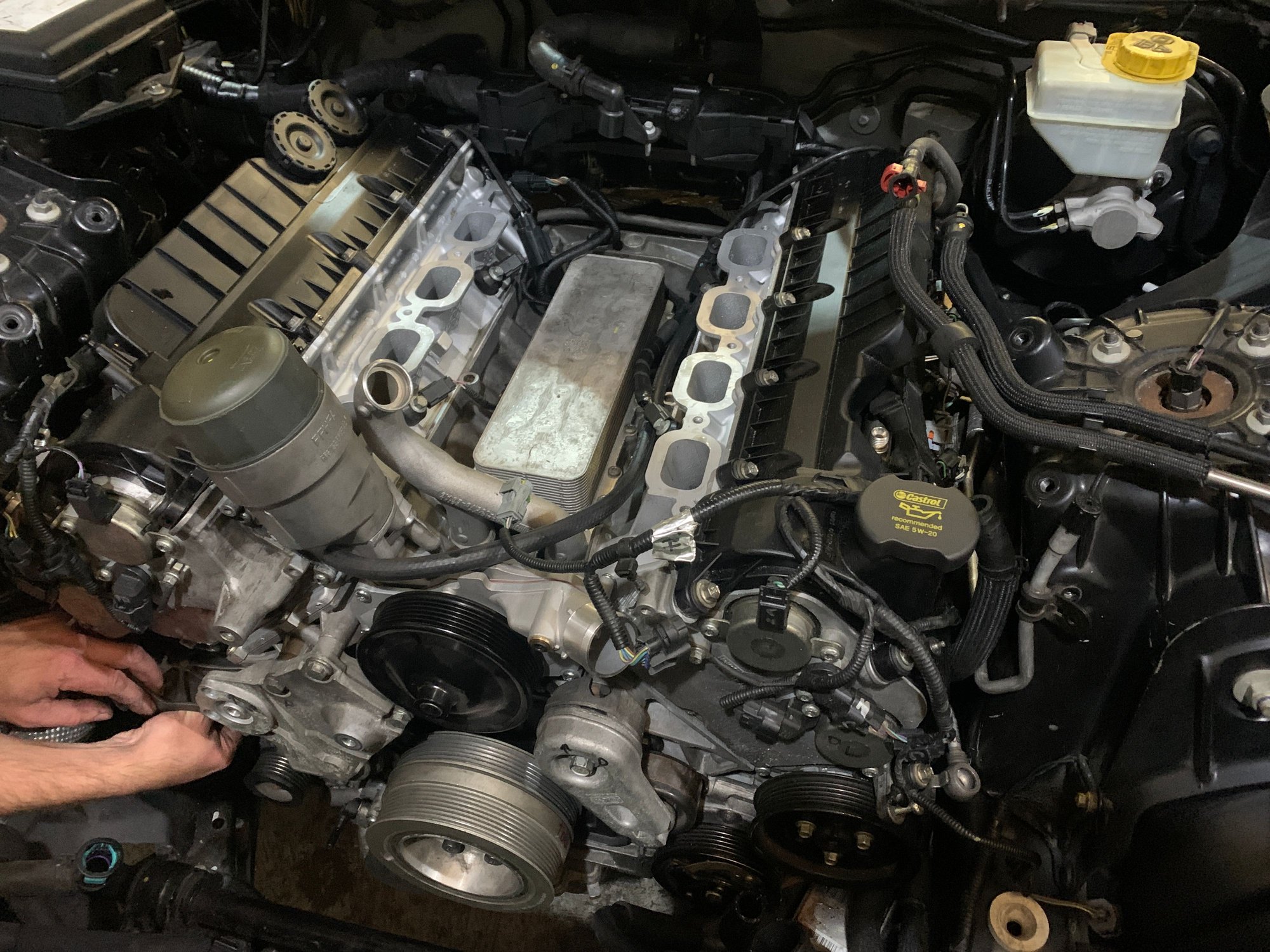

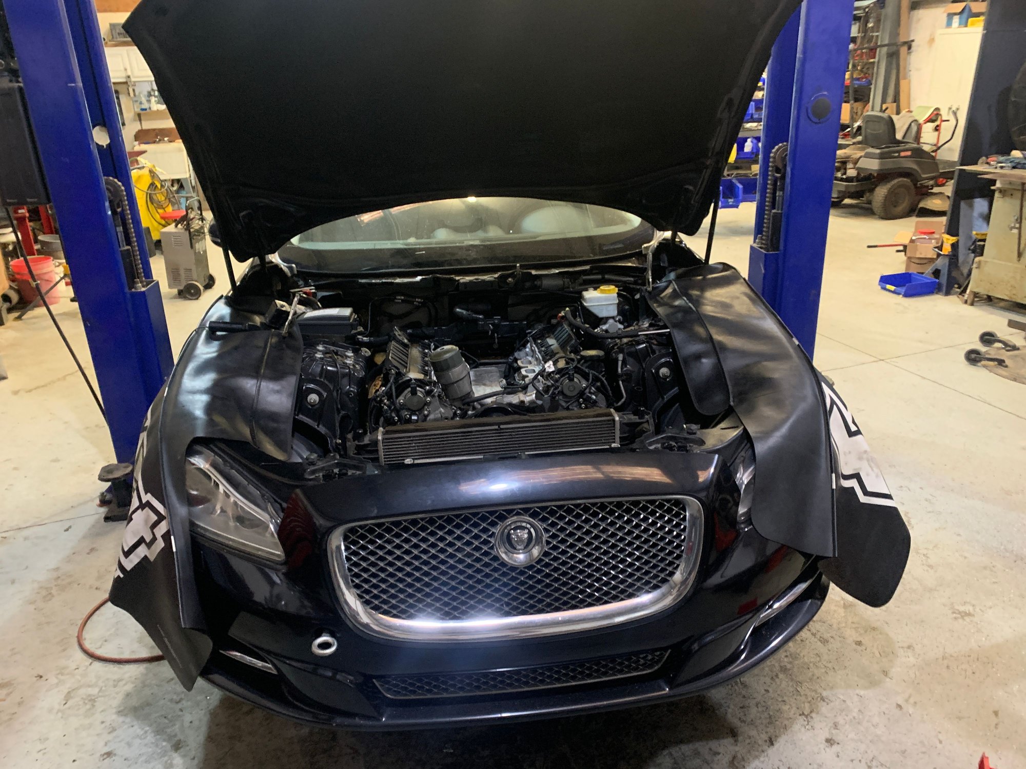

All back together and runs great. I have a code for a bad vvt solenoid. I'll replace that solenoid and should be ready for the road.

littledan you do great work!!
One thing that people have reported to cause check engine lights are the PVC caps I have circled in red on your pictures. Did you replace these?
They do give out with time.

Yes replaced the vents . eBay is your friend on those. Under 20$

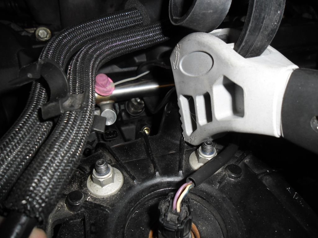

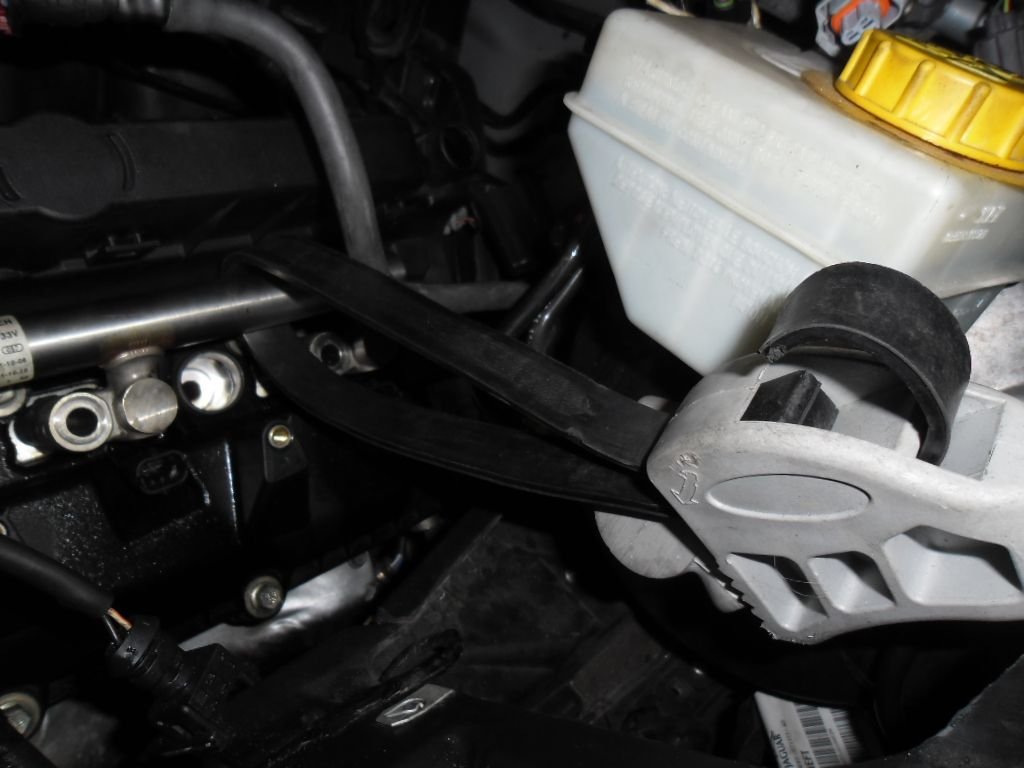

I ran in to a bit of a 'challenge' in removing the fuel rail while I'm doing the drivers/left side valve cover gasket.
After a lot of pulling, wiggling & tugging, I used a large strap wrench to wrap around the rail, then leveraged it against the shock tower (for cyls 2 & 4) and the master cylinder (for strap between cyls 6 & 8) to get it loose. It helped.
