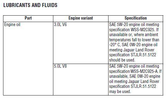

KingRT on your response indicating you had an oil change and wipers for $80. The oil speced for our engines is not just a synthetic, it is a special formula and, IMHO, should not be substituted.

Lastly, in the owner’s manual it reads “Castrol is "recommended" oil. WSS-m2c925A is the REQUIRED spec oil.

I have a 2014 XJ. My local Jag mechanic (not a dealer) charged me $106 for the filter & labor and I brought my own Castrol Edge WSS-m2c925A spec oil that I purchased on eBay. He drained it from the bottom and is quite familiar with removing and putting the tray back on. He feels it's the right way to do the job.
KingRT, unless your mechanic put in the right spec oil as pointed out by XJsss above, I'd get it out of there before you damage that engine. If he did put in the correct oil, I'd love to know where he got it. Only Jag dealers typically have it and they buy in bulk by the drum.
