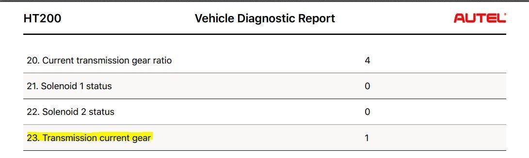

That is because that is what the gearbox does in manual mode and is the reason why people think the same as you. The car has enough torque to pull away in second gear so doesn't need to drop back to first in manual mode but if you actually monitor the gearbox using a tool you are likely to see that in auto mode it always drops in to first gear. As I said before, the 6 speeds definitely do but I can't confirm what the 8 speeds do.
Here is a video of my '10 XKR in drive monitored using SDD. The bottom indicator is vehicle speed and the one above it is current gear. You will see that when I come to a halt the gearbox drops in to first gear:
It is very easy to check and even my $25 OBD tool displays which gear the car is in. I believe that a few XJ owners have the same tool so perhaps someone could check:

weird, annoying....but verrrry interesting. thanks for sharing that
