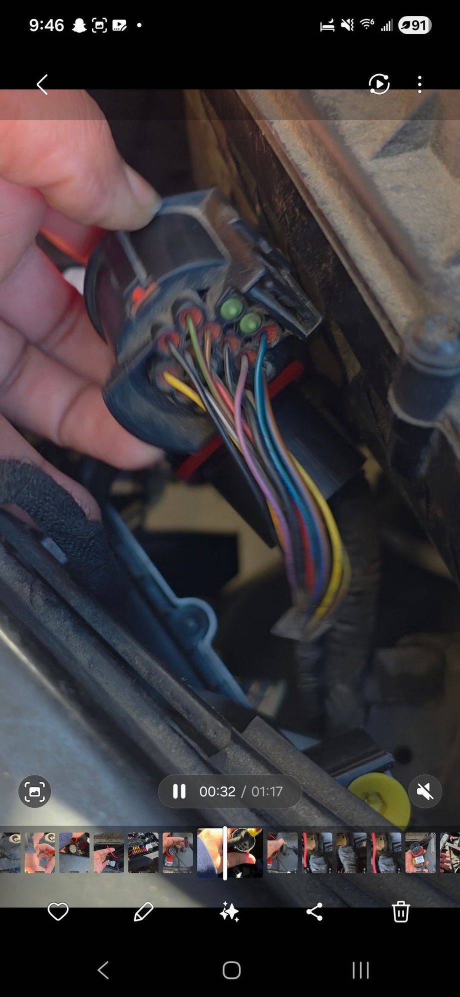

I bought the same headlights for my 2016 xj rsport ... my original lights were already LED lights they were ruined in an accident so I got these .... these lights will not work on my car the left one
this is the wiring harness attached to my vehicle that the light plugs into there are 14 wires coming out of it
[img alt="their wiring harness only has 7 on one side and 4 or 5 on the other side
"]https://cimg9.ibsrv.net/gimg/www.jaguarforums.com-vbulletin/1120x2000/20260321_095140_b68371f85d2cab38fc006571caee8fd70b e49ed1.jpg[/img]
comes on only when the turn signal is activated and it stays on after the car has been turn off I have to unplug to get it to go off... the right (passenger) side also only comes on with the turn signal but it goes off within 2 seconds of the turning signal turning off ... PLEASE HELP ARE THESE NOT COMPATIBLE WITH MY CAR ? the seller keeps saying they are and asking me to send photos of the wires I did but haven't received a response
It's best to ask the person who sold it to you
