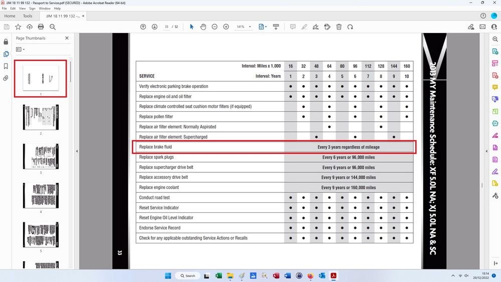

Originally Posted by Sabrinaservicewriter
..... I'm looking at the service guide by Jaguar and it's not a regular maintenance item. ......
The JLR service schedules have included three yearly brake fluid changes for some time. Here is an example from the US Passport to Service for the 2013 X351 but I could have used any recent model. My X150 and F-Pace include the same change interval recommendation:
