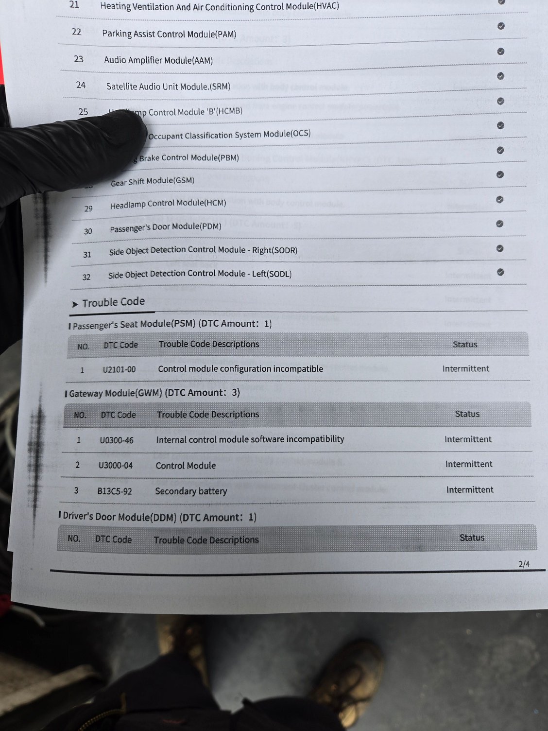

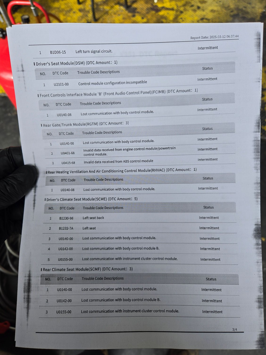

Any chance somebody has ever experienced these codes? Don't mind the code for secondary battery, as I (along with many others) have had that battery disconnected without issues for months.
The codes shown are all able to be cleared just fine but come back after a few days. Didn't have any symptoms till last week. What happened was, while driving, I got a "blindspot monitor error" message on the dash. Didn't think anything of it until the steering wheel became hard to turn, the radio, AC controls, backup camera all stopped working as well. Windows wouldn't work, seat adjustments, nothing! Even dynamic mode wouldn't activate!
I then shut the engine and tried to start it again and it wouldn't! "No key detected". Even tried my second key and still the same message. Disconnected negative battery terminal, reconnected, and all was fine. Scanned for codes immediately after (first pic attached below).

I hate to say it but with those massive problems (Especially all the U codes) the first question should ALWAYS be.
How old is the battery?
What is the resting voltage of the car after sitting all night?

Good troubleshooting and I think you have laid to rest any battery problems.
Can you check the CAN bus for proper resistance? With so many network errors it's hard to believe you have that many problems with the car or it's components. But some kind of net work wiring issue would explain it.
I have not done this so don't know what wires to check. Does the network integrity test tell you the Can Bus is OK?
Water is usually found in the trunk or under the front seats if you have a leak.
Does SDD have any indications of voltage variations?
With the module configuration errors listed have you programmed or tried to program any modules?

Alright I tested the CAN hi and CAN low pins at the OBD-2 port. I'm pretty sure this is the high-speed CAN. Anyway, it tested at 59.7 Ohms with all electrics asleep, which I think is within spec. I still need to find a good place to test the medium speed CAN. That will be next. Network integrity passes just fine, no faults there. I'll need to watch live values and see if there are any voltage issues.
