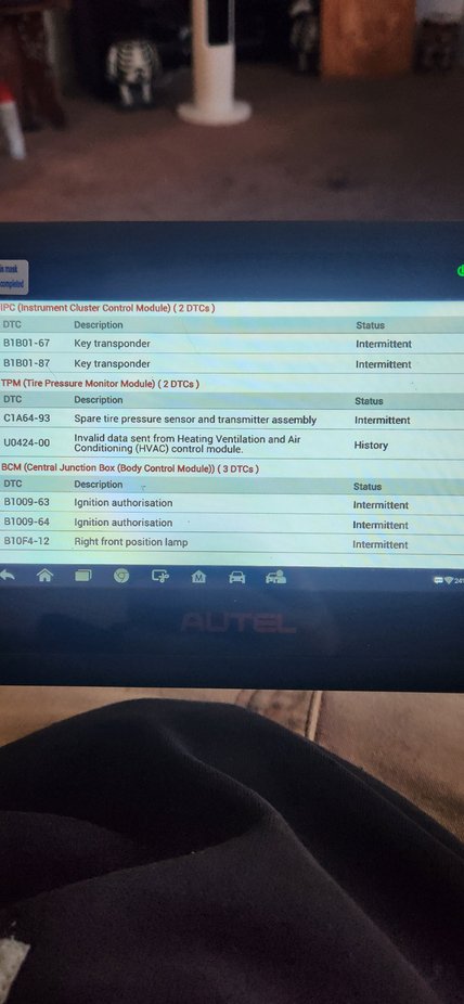

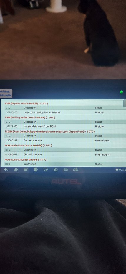

So, being paranoid as I am now about purchasing my xf I ran my regular code reader on the car and got no codes or errors thrown. So I figured I'd run a full diagnostic scan and bam! Lit up like a tree. Any one else have intermittent codes being thrown?

Those are all old or historic codes. Try to erase everything and read them again. Remember you should always clear the codes because we want to see what the car is currently complaining about.
Very common to have intermittent codes. Same as any network. You have data collisions and voltage sags and surges. Kind of like looking at an event log when troubleshooting a computer. These can all cause errors that may or may not mean anything. Again the key is to erase the codes and see what comes back as this is just standard procedure? You want repeatable codes before you start trying to do any repairs.
