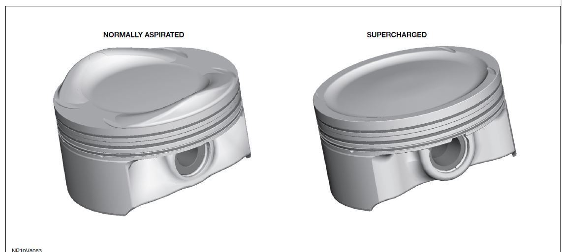

Eric, in the case of the XJ, this is all done with the shape of the pistons. The lower compression ratio is needed to prevent knocking (pre-detonation, diesel effect, whatever you want to call it). You start pushing lots of air into the engine, when you go to compress it, you reach a point where the pressure rise starts getting too rapid, it will cause any combustible thing (oil, left over exhaust gases, etc) to spontaneously burn. You lower the compression ratio, you slow the rate of pressurization.

Here is the difference in piston design between the NA and SC models. As posted above this is just the tip of the iceberg concerning all the differences between the two models.
The 5.0L has forged rods but cast pistons and cast spheroidal Graphite iron crankshaft.
This is from the 5.0L technical guide which will answer all the questions about what's different.
But listen to the advice already given. Sell what you have and purchase the SC model you want.
