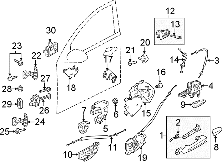

The initial issue was when the temperatures dropped below freezing the driver's door latch mechanism would not hold the door closed without repeatedly exercising all of the door's locks and handles. The bad behavior vanished when the temps rise above freezing. Then the problem evolved into the latch refusing to hold the door closed (door swings freely) regardless of temperature. I was getting ready to disassemble the door when I discovered two weeks remaining on my warranty. I took it to the dealer yesterday, but haven't heard back.
Jag XJ interior door latch and lock parts
This is my suspect parts list
#3: C2D29684 Cable. Door Latch Lock Release.
#4: C2P14342Handle Cover. Front Left Outer. Handle base. Left. Base or mount to which the door Handle attaches. Cover for Exterior Door Handle.
#11: C2D29685 Door Latch Cable. Lock cable
#14: C2D29682 Door Latch Cable Cable.
#15: C2D49433 Lock. Latch. Actuator. Door. Front Left. Latch. Central Locking System. Includes: Door Lock. Mechanism to secure Door to chassis. Motor to Lock and unLock car Door. Power Door Assist w/soft close.
#19: C2D56409 Actuator and Cable.
#30: C2D35741 Door Lock Control Module door power. Front Left Module. PartQualifier: door power.
In the Service Bulletin listed above in XJsss' response, they identify Qty 4 C2D10041 Interior door panel clips, due to potential damage during removal. My questions: are these clips in addition to, or replaced by the C2P7160 Clip, Panel Trim Retainer? I can't find pics for the C2D10041. And is the TOPIx Workshop Manual section 501-14 for the 2016 XJ available anywhere on the forum?
