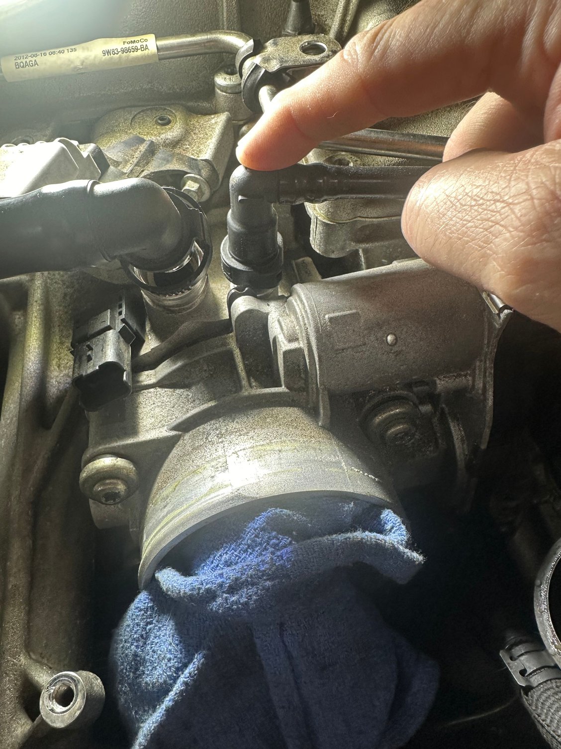

What is the trick to remove this hose?
What is the trick to remove this hose? It’s on top of the throttlebody

Push in on the highlighted area, push down on the connector while doing so, then you should be able to pull it straight off.

Big thanks I would have never guessed that!!!

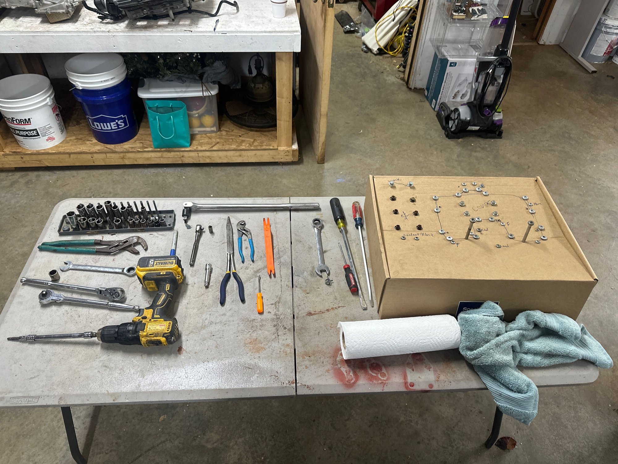

Picture of all the tools I used to pull the S/C. The orange handle pick and pry pry were life savers for removing connections.
Picture of all the tools I used to pull the S/C. The orange handle pick and pry bar were life savers for removing connections.

I found this a life saver for those pesky bolts on the back of the supercharger and symposer.
https://www.ebay.com/itm/375987087593
(ICON mini flex head ratchet and torx bits)
