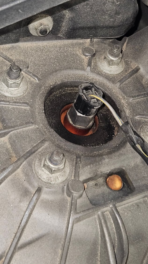

Yes they are genuine (image below) , my trustworthy mechanic reolaced them along with all suspension parts. Sorry i might have caused confusion, but they were replaced 2 years ago, i consider this to be not long ago lol

Have you looked at the top of the mount since it was installed? We tend to see the foam around the center shaft degrades and sometimes the shaft is visibly not centered anymore?
Maybe post a picture?
Yes I can't explain the water effect either but I have seen people quiet the noise by spraying WD-40 at the top of the mount.
That would not hurt anything even if it did not work.

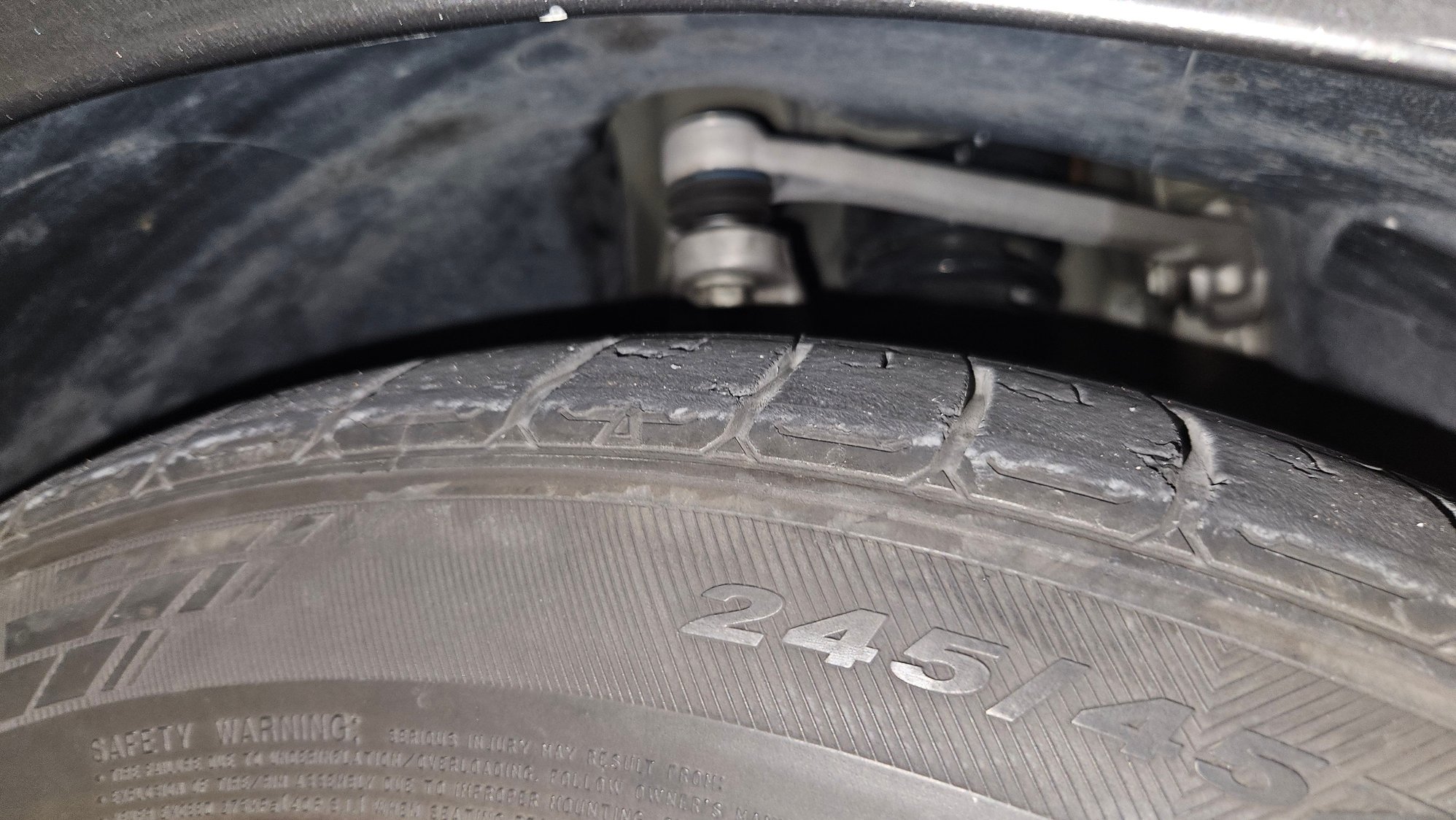

This is the top of the right shock mount, I did spray some wd40 on it, as well as on the bushes on the control arm (second pic) without lifting the car. But still the noise is there and after i washed the car it went away for a day as usual. I do not see any disintegration of the foam, and the shaft is sturdy in the center, just the colour is not yellow anymore. I remember before I replaced it 2 years ago I could see bits of the red foam falling off like powder but not this time.
