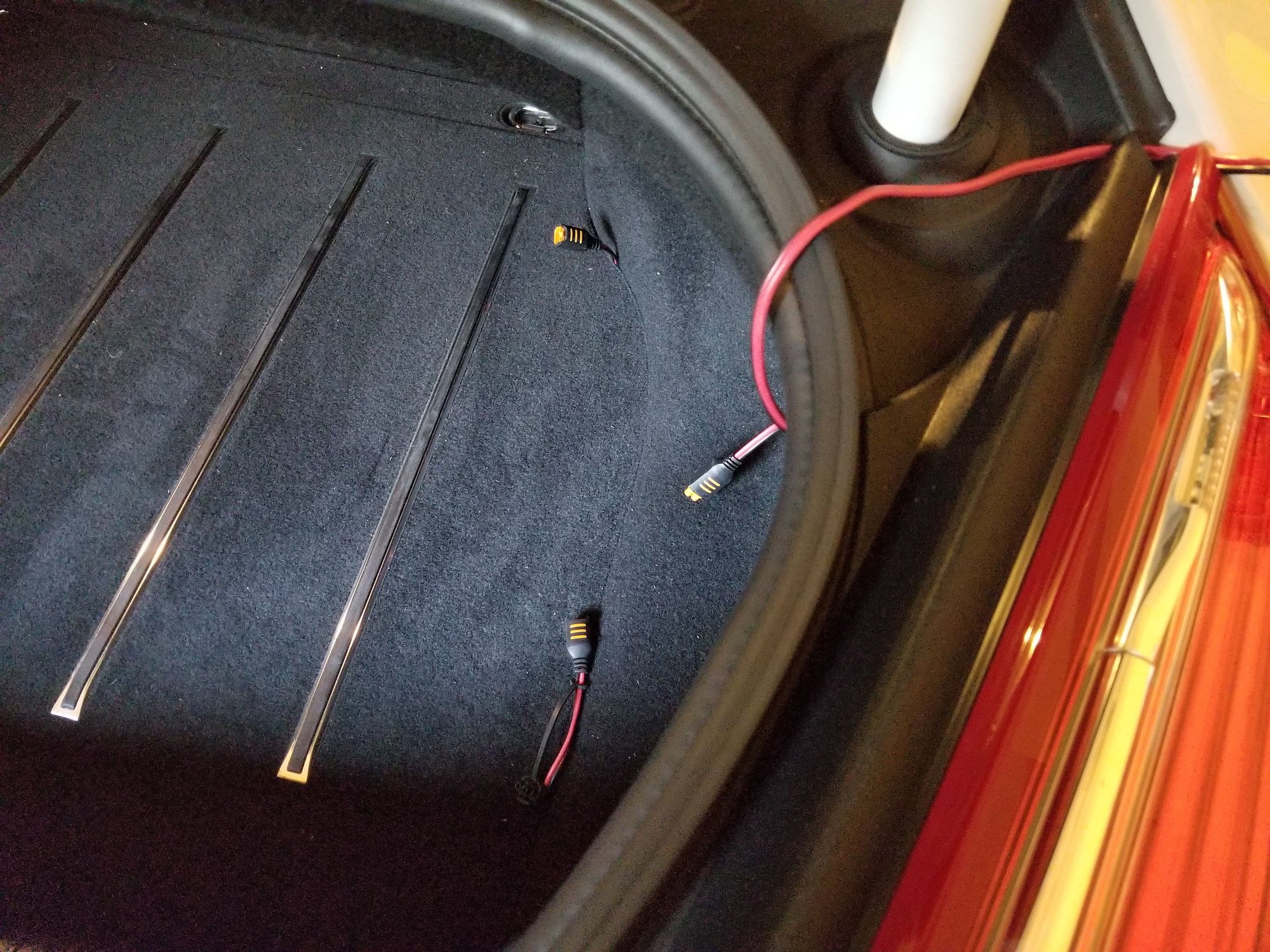

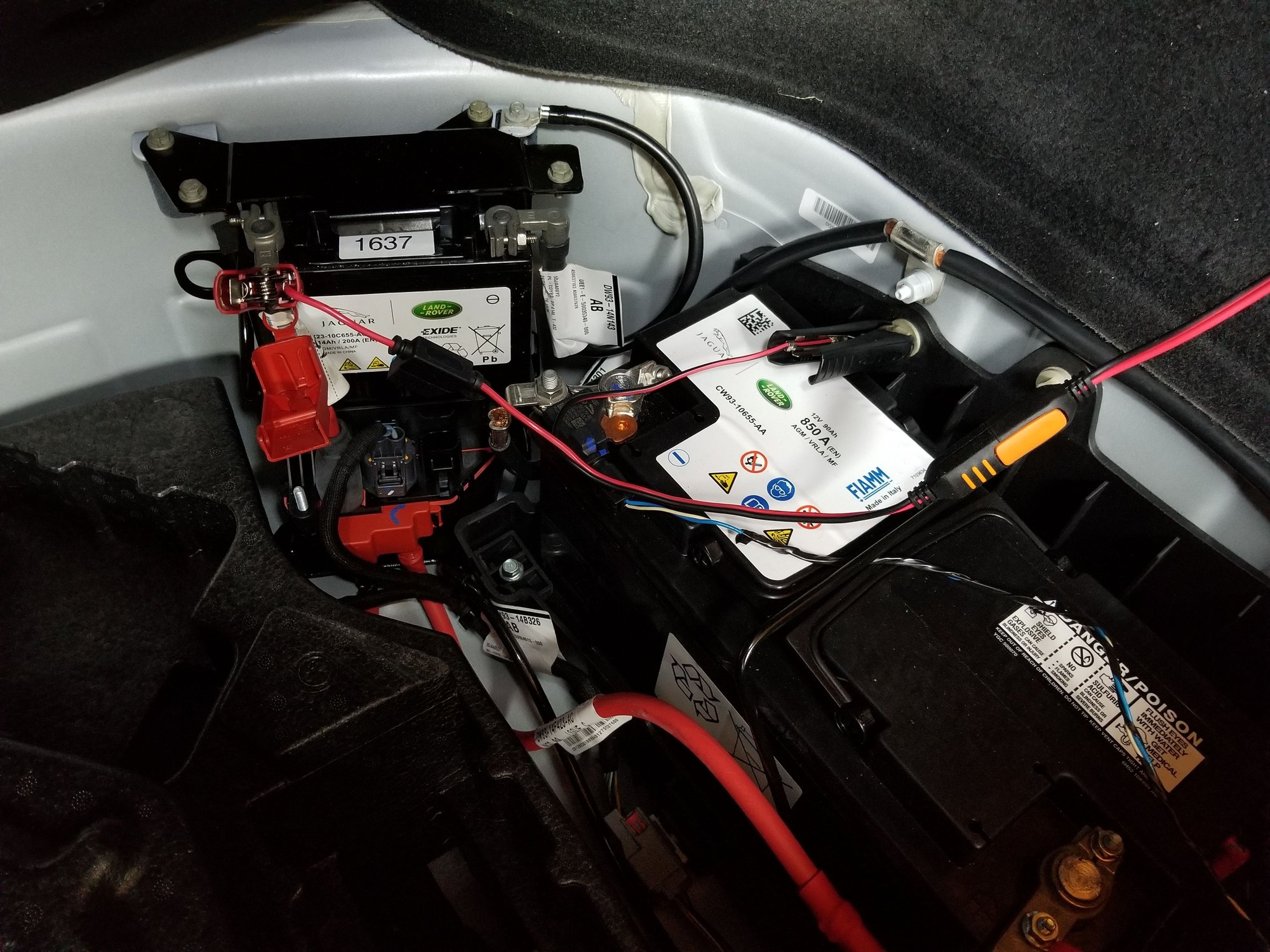

My 2013 XJ has the first version of Stop-Start with the small auxiliary battery. My CTEK MUS4.3 works perfectly to keep both batteries fully charged. I use two separate pigtails, one for each battery, and alternate attaching the CTEK between them. Here's the Stop-Start pigtails with alligator clips.

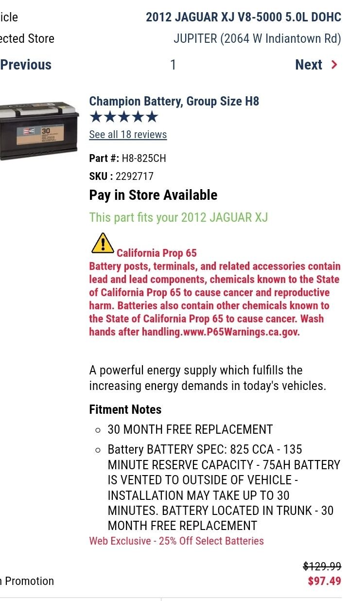

2012 XJ Base Portfolio V8, I need to replace the battery any suggestions as to the best battery that fits and doesn't require a mortgage also any advice on replacing does it need any special requirements
or is it an easy change? Thanks in advance, scottjr1

The Pep Boys in Jupiter, Fl. Order online to get the 25% discount. Free installation.
https://www.pepboys.com/car-batterie...%205.0L%20DOHC
I have their Bosch AGM battery in my 2013 XJ and am very pleased with it. I'm not sure if you need an AGM battery because your 2012 XJ doesn't have Stop-Start. Put the same type in that came from the factory.
