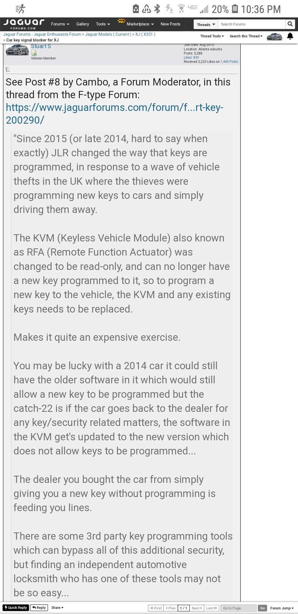

See Post #7 in this thread, a screenshot of which is below: https://www.jaguarforums.com/forum/x...ker-xj-200367/
