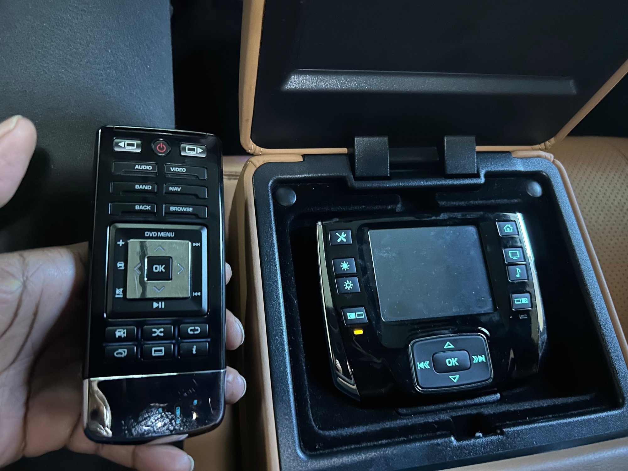

Once "paired" the remote communicates (you could say controls) the front head unit to load dvd/fast forward etc for the rear screens, see attached guide. The remote does not control the front screen in terms of what it displays. Could you share the X-Dave instructions for CCF modification - I have been unable to get my replacement remote recognized by the head unit and maybe there is a mismatch in CCF.
XDave’s CCF instructions were for enabling the “rear media” button to be displayed on the front display screen. It wasn’t there from factory. I don’t think CCF modifications will impact the remote though. The remote is frequency based and not formally paired by vin or CCF.
In any case, I was able to control a DVD that was playing on the front screen from the rear seats with both the old and new style remote. I was able to do this in limo mode.
Are you able to control the rear screens while the remote is both docked and undocked?

My replacement remote is not recognized, docked or undocked, that's why I'm looking for any help in getting it "paired". I know the battery is good.

Ahh. Okay. Thanks for clearing that up. I wasn’t sure if the remote wasn’t working all together or just for controlling the front screen.
I have purchased 3 old styled remotes and 1 new styled remote. The old style remotes are very finicky! Which is why I’ve purchased so many. The first remote that I purchased worked intermittently. I would get the flashing orange lights. When this occurs, the remote is inoperable and doesn’t control anything. Later, the orange flashing lights would later go away and it would start working again. This problem occurred so much, that I purchased and additional remotes. The other 2 old style remotes worked and I didn’t get the flashing lights. I ended up selling one of them. Long story short, there are known issues with the older style remote. There are a few Jaguar threads on this issue. This is likely why JLR transitioned to the newer styled remotes. You could have a defective remote as those remotes are hit or miss.
There is no CCF bit for remote paring however there is one for the companion docking station where it can be enabled and the frequency can be changed. However, I would bet that the remote is defective. That would be my best guess based off tinkering with the RSE system for over the years. My front head unit was swapped out for a unit from a 2014 XJ and I’ve purchased several RSE remotes that have all worked without additional programming. I’d say that the remote is the culprit. I hope this narrows down the problem.

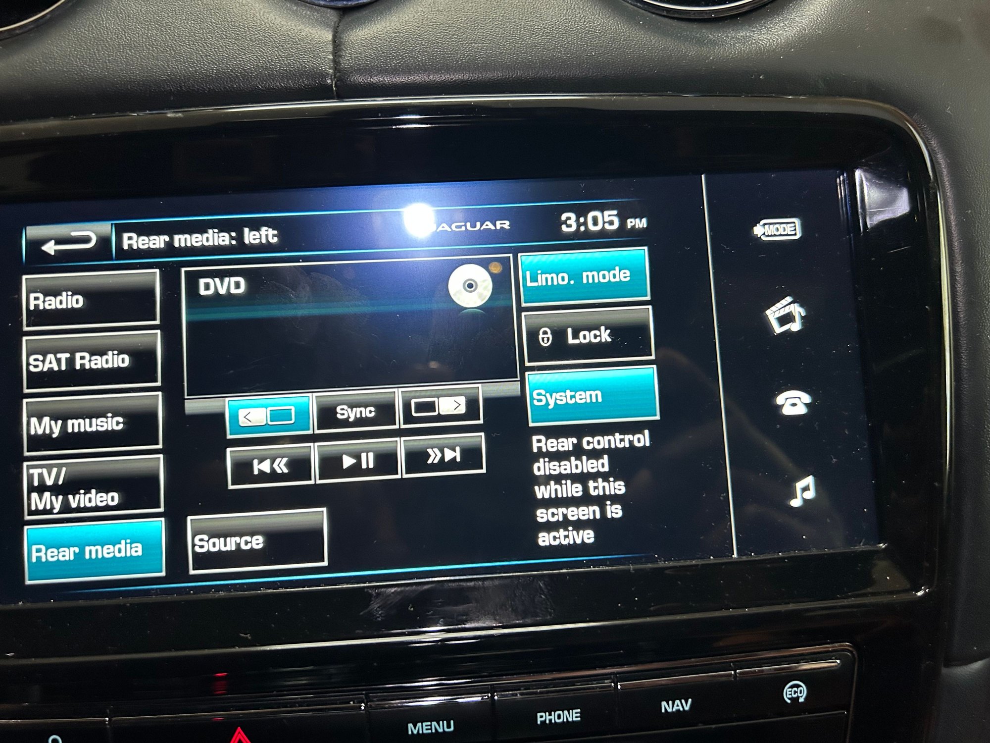

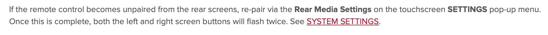

I hate to ask a stupid question, but did you tell the head unit about the remote? There is a pairing option in "Settings":

@christ Unfortunately I could not find any option for pairing - the Rear Media/Settings screen just gives me an option to turn limo mode on-off. If you are able to provide pictures or video showing the pairing screen that would be most helpful. Also can you let me know where you found this instruction? Is it from some manual? If so could you upload it or pm It to me?

I only have a 2018 (with a 10" screen), so I can't speak for the precise options in an earlier car, but on mine it is:
Select the Settings cog
Select "All Settings"
Select "Features"
Select "Media"
Select "Rear Media".
