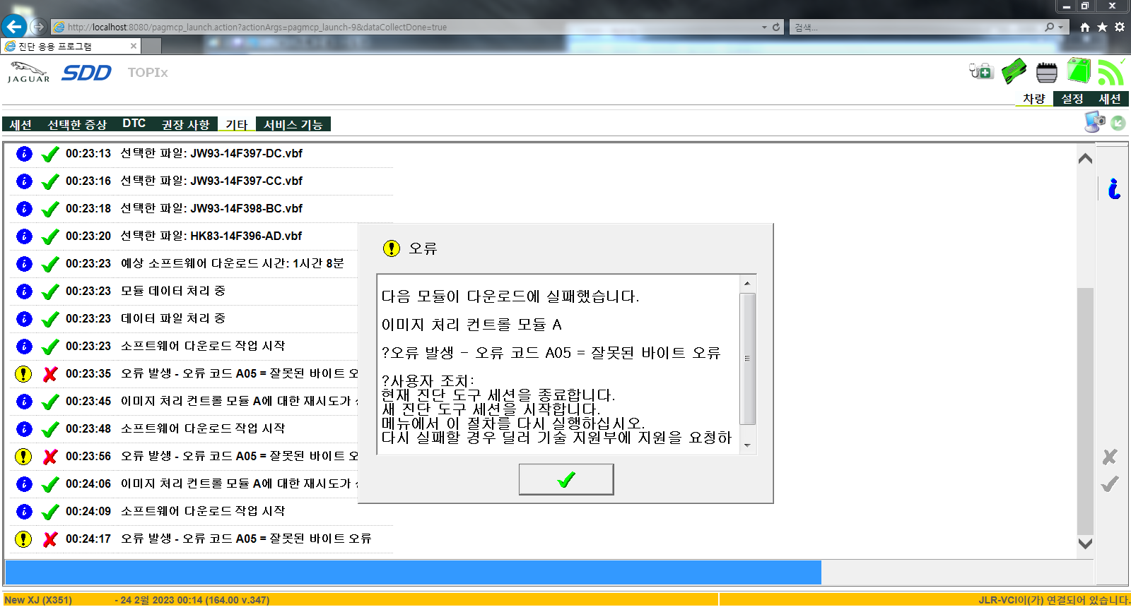

Hi guys?
I'm trying to activate LKA. My Jag is 17MY LWB.
STEP 1. AHBA
My Jag was not able to use AHBA, so I installed IPMA_C=HCMB and modified some CCF values. HCMB has a mono camera. I am now able to use TSR with AHBA.
STEP 2. LDW
The 16-17 instrument cluster cannot use LDW/LKA. After modifying the CCF, I can see the lower left lane departure warning icon. However, it does not work. LDW is available after upgrading to the 18MY's cluster. Unfortunately, it does not support steering feedback.
STEP 3. LKA

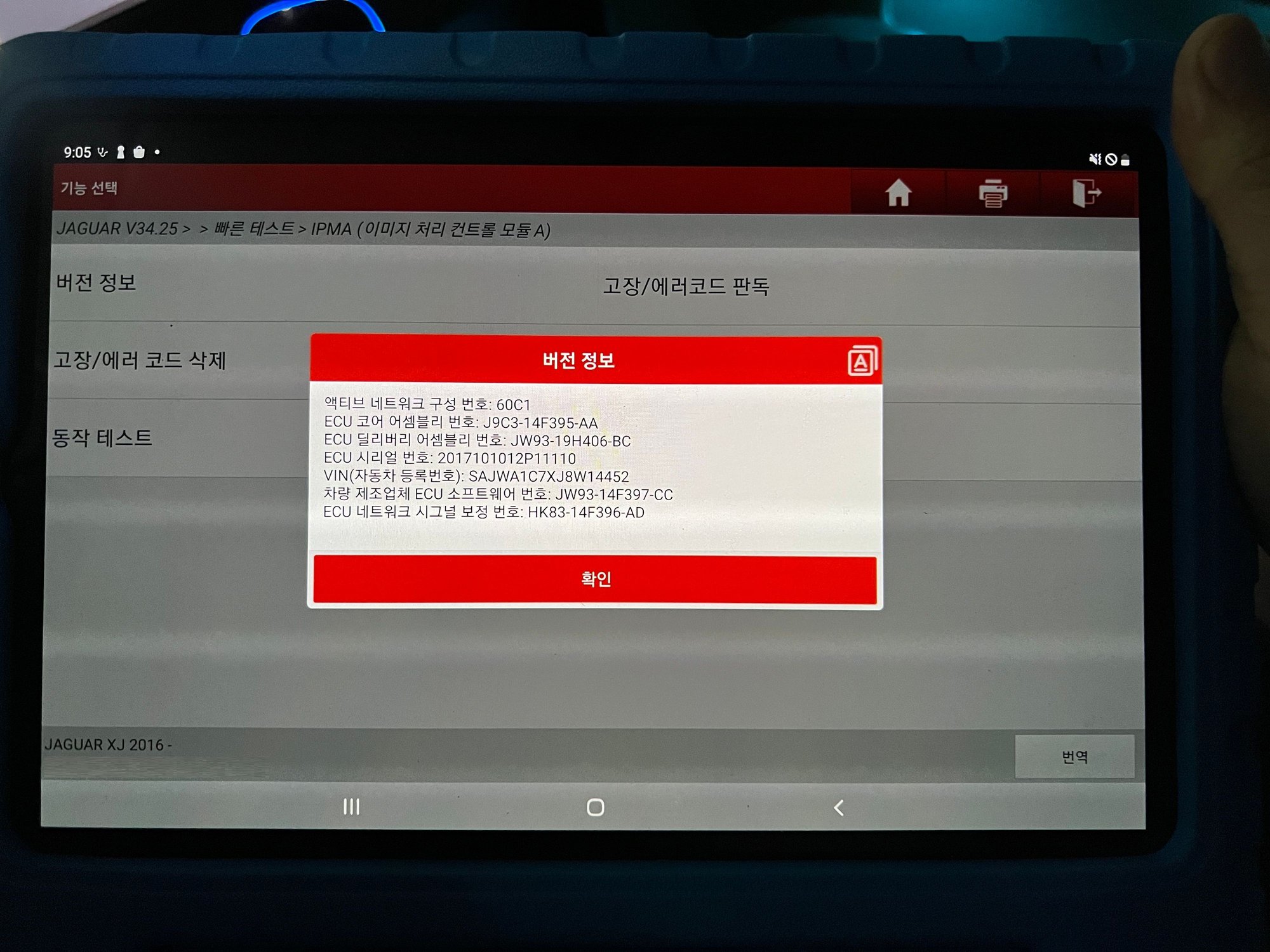

LKA requires a stereo camera, which is a very expensive component. I purchased an IPMA on eBay that was used in 18MY's. After making and connecting the harness, I was able to successfully verify the module information.
First, I had to update the module to match my jag. However, I got an error: "error code a05 invalid byte error". Stuck here.
I am using the genuine JLR-VCI and the latest SDD 164.00 v.347. And I enabled engineering mode. What's the problem? If successful, it would be the first use of LKA in 17MY's
Thanks,
KIM

I bought new and used IPMA, but, the error message is the same. I have perused TOPIx. LKA is closely related to IPMA, PCM, PSCM, BCM, GWM, IPC and ABS. I am trying to make the software the same, as there is not much difference in hardwares.
I made PCM, PSCM, and IPC the same as 18MY. I found that PDC preference is very important, so I modified the CCF and downloaded program again - GWM, BCM.
But there is a common, the first time I programmed IPMA, I got a warning "Security certificates do not match". I can see this message only once. After that, I only see the error A05 .... I have enough power (supplied 60A) and I'm subscribed to SDD(no crack), but I can't solve this problem.
IPMA has 2 DTCs.
1. central configuration error
2. cooling FAN not response
So I made and connected a cooling FAN, and solve 2nd problem.
Yes, not yet.
Thanks,
KIM
