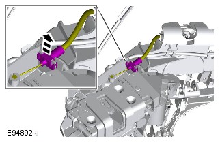

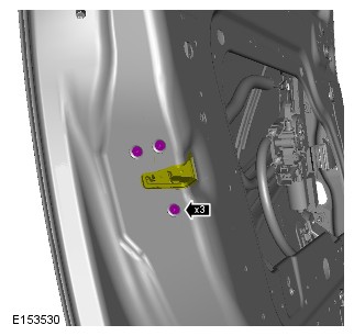

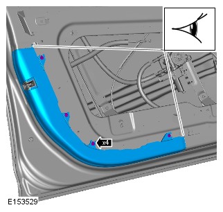

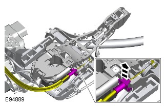

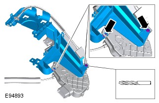

Hello everyone my lock actuator went out on the driver side so I bought the part easy enough looks like a simple replacement took the door apart this morning I cannot figure out how to get the part out of the door it is attached to I believe it’s called a lock reinforcement has anybody tackled this year on a 2013

  1. Refer to:Front Door Window Regulator and Motor (501-11 Glass, Frames and Mechanisms, Removal and Installation).
  2. Refer to:Exterior Front Door Handle (501-14 Handles, Locks, Latches and Entry Systems, Removal and Installation).
  3. NOTE:Right-hand shown, left-hand similar.
    Torque: 3Nm
  4. Torque: 7Nm
  5. NOTE:Left-hand shown, right-hand similar.
  6. NOTEo not disassemble further if the component is removed for access only.
  7. NOTE:Note the position of the wiring harness.
INSTALLATION
  1. To install, reverse the removal procedure.

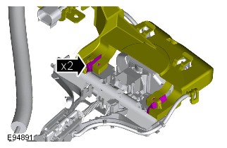

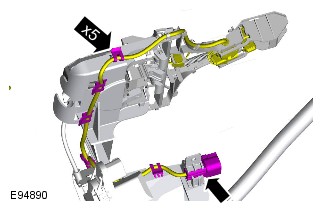

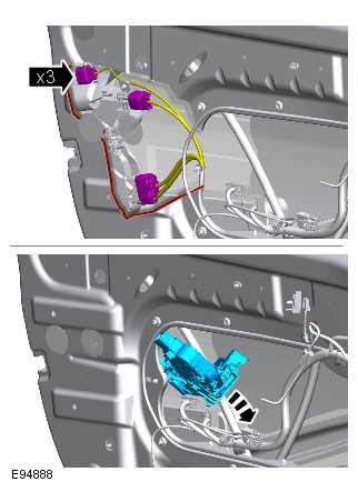

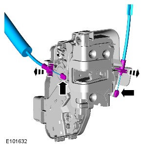

Thanks. The door handle removal will not open. I will google

  1. NOTE:Remove the screw sufficiently, only to release the component.
    Torque: 4Nm
  2. CAUTION:Take extra care not to damage the wiring harnesses.
    NOTE:Secure the connection in the service position.
INSTALLATION
  1. CAUTION:Make sure that the wiring harnesses are correctly located.
