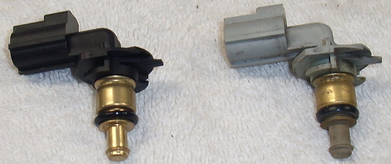

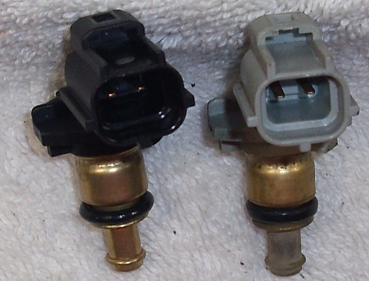

Aaron (SuperChargedXJR) got me thinking about temperature sensors and why there are apparently 2 identical sensors on the 5.0L SC engine? What do they control?
I have both the front and rear sensor sitting on my bench and they are OEM Jaguar parts. The first thing is there is no information or markings of any kind on either sensor! What stumped me for a while is the front sensor is NEVER mentioned by Jaguar anywhere! In fact the front sensor comes with the lower radiator hose only. Kind of like what they did with the radiator as with that you can't order the drain plug separate. It ONLY comes with a complete radiator.
Again note that nowhere in the parts description of this hose assembly does it note that is ALSO contains a temperature sensor!
Here are the two places the sensors are mounted. Again note they have identical electrical plugs and I even measured the resistance and they appear to be identical too and both read around 27K-29K ohms at room temperature. Does anyone know what they should read at different temperatures?
One is black and the other grey plastic.
We do know that the dash board gauge is run by the front sensor and the computer is using the rear sensor from Aaron's testing and problems. So we think the P0118 code points to the rear temperature sensor. I did find a post where an after market scanner came up with temp sensors 1 and 2 but he never got any replies on how to identify which was #1 and which was #2.
I wonder what SDD would show if the front sensor was bad?
Interesting.
Both of my OEM sensors are black. The sensor that came in the EuroAmp housing is gray.
I’m still waiting on JLR to deliver the new OEM sensor so I can swap’er out.
My Foxwell scanner gives no indication of sensor location when pulling DTCs. ALLDATA does not help with my code on location either.

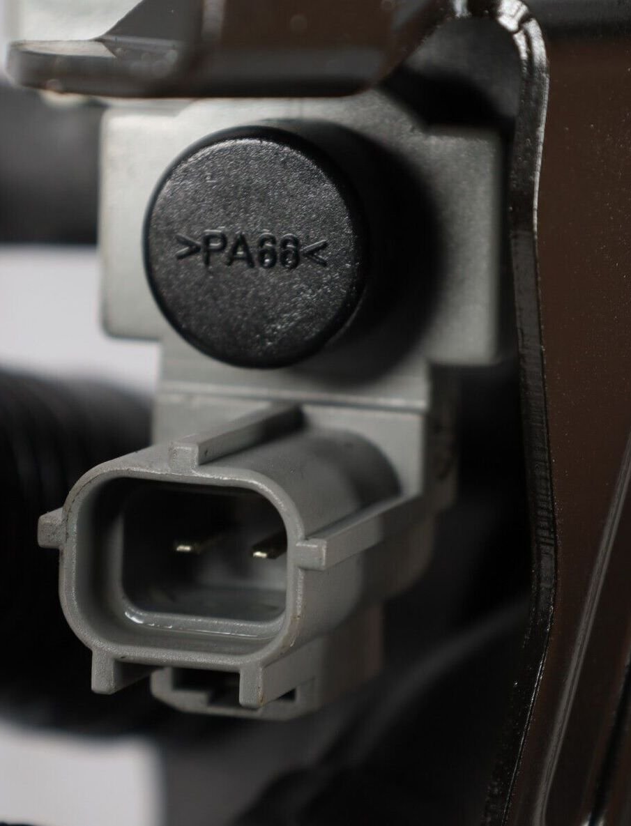

I wonder if the connectors got mixed up on the rear ECT. The symposer electrical connector is identical to the ECT connector and is quite a common mistake. Not sure if that will give you the P0118 code but its worth a look especially considering the symposer delete.
From the workshop manual
If there is an ECT 1 fault, the ECM adopts an estimated coolant temperature. On the second consecutive trip with an ECT 1 fault, the ECM illuminates the MIL (Malfunction Indicator Lamp).

It would explain some odd things too. I was curious and looked up the symposer plug and yep it's identical to the temperature plug! I had never looked before.
And they are close together as GT40 said on the rear water manifold.
I posted above the two temperature sensor plugs and they look like this.

That is great information and thanks much!
Then the symposer plug that's left over after removing the symposer.
It's kind of an accident waiting to happen if you don't know this. If the plugs got swapped would it set code P0118? I think it would.
this MUST be what happened. New sensor in. Same error. Still reading -40.
I MUST have the wrong plug.
Old Apr 27, 2025 | 12:23 PM
SuperChargedXJR's Avatar
Joined: Jun 2024
Posts: 138
Likes: 17
From: Mooresville NC
Confirmed.
You CAN mix the two plugs. If you do a symposer delete - while doing the rear crossover don’t mix them up.
