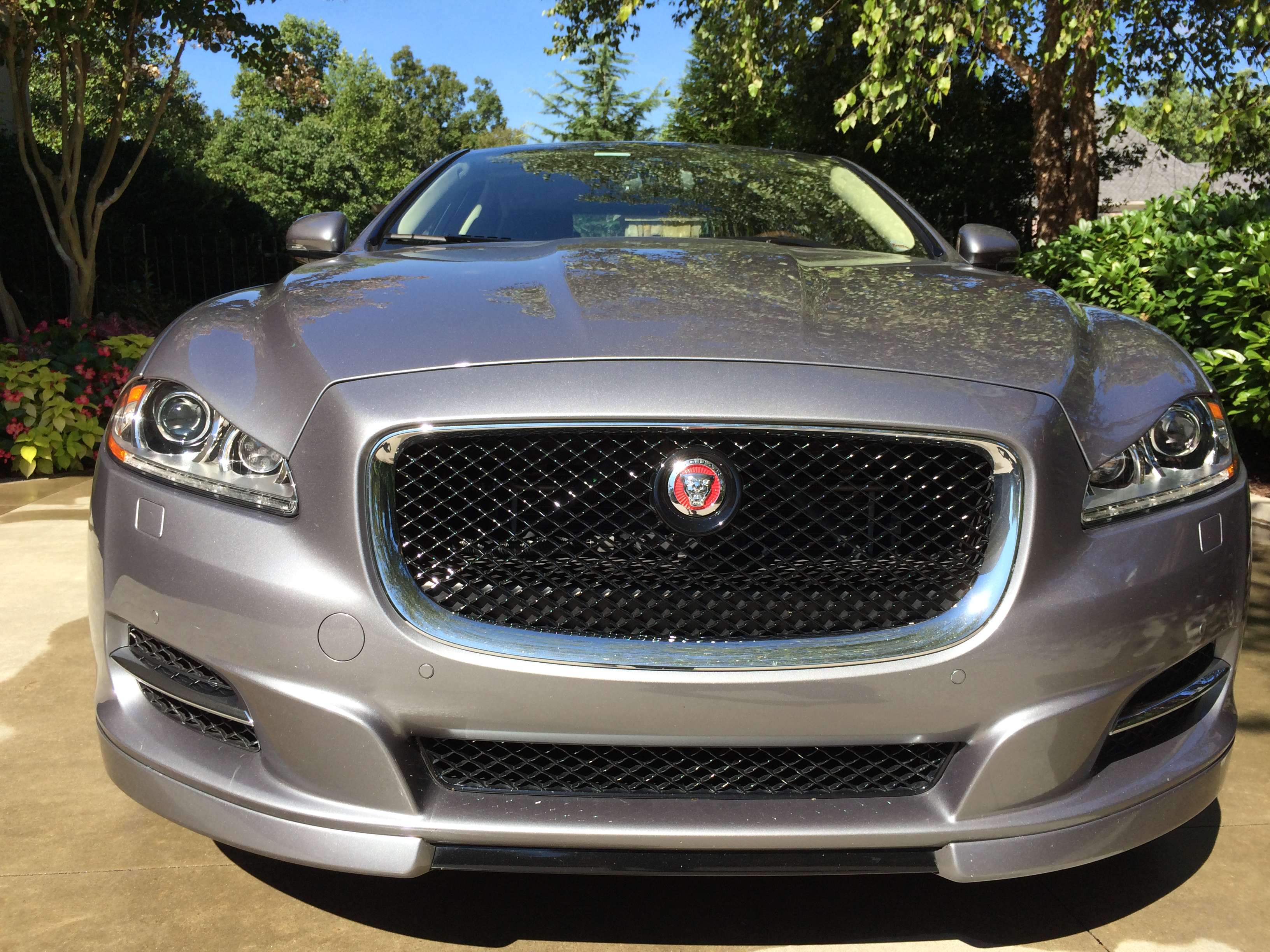

My XJ has the factory spoiler and it is slightly different from the Mina spoiler. They both attach in the same manor with 3M double stick tape. Factory spoilers are primed but not painted. You may also be interested in adding the front splitter also.

Your car looks lovely !
Did you put the front splitter or it came already with it ?
How does it attach ? 3M ? drilled ?

I was wondering also as to whether that splitter is the XJR factory or aftermarket?

The splitter and spoiler were part of the Speed Package along with red calipers and max speed limiter set to 174mph, the Speedometer is up to 190mph. Many late USA 2015 XJs came with the splitter/spoiler and the XJRs side rails. The splitter attaches with 3M tape on the leading edge and screws in on the rear edge using the same holes ar the front under cover. The splitter is 3 peaces (left right and center).

If you want OEM any dealer should be able to order them. FYI the front spoiler/splitter is 3 peaces Left, Right, and center. They are held on with both existing screws on the bottom and 3M double stick tape on the leading edges. All except the center front will need to be painted.
