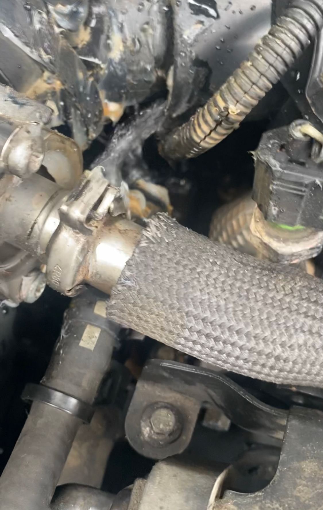

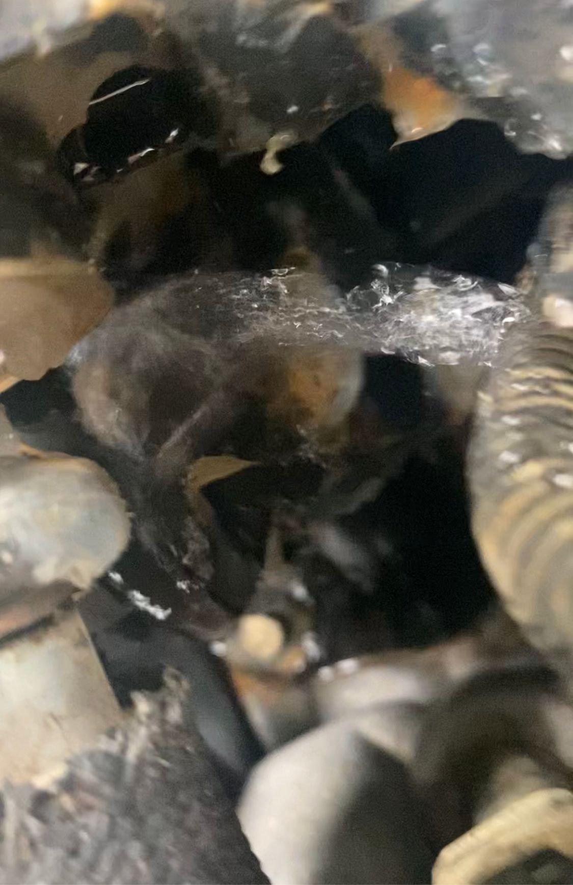

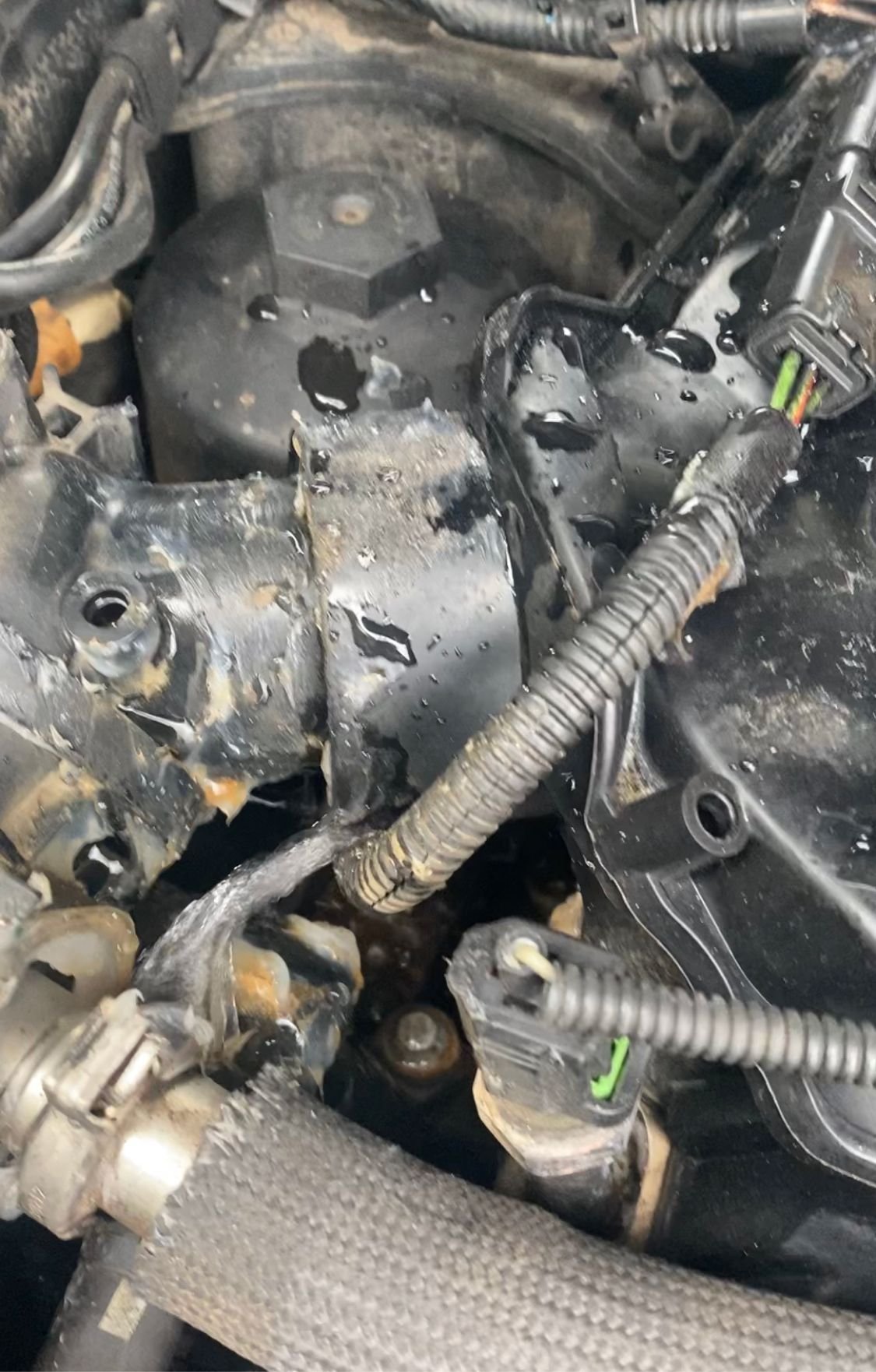

Had to get towed home in my 2011 3.0v6 xj as, even though the temp gauge stayed normal, it was clearly overheated. Today I discovered the leak is coming from a plastic split where the top hose joins the ridiculous plastic hose but actually at the face where the plastic hose and return (bypass) hose join onto, there is a third hose also attached. To get to it I some how have to remove the manifold which has the air push fit pipes in a y to both intake manifolds!! How and why, surely I don’t have to remove the intake manifolds-just had one replaced at great cost after the dreaded split…… ideas anyone-I’m stuck without my motor. I’m new here, so thank you.
That is a fountain of bonkersness-wasn’t sure how to add the video, sorry

The "Y" shaped part is the Throttle Body and doesn't have any cooling pipes in it.
You may need to remove it to get to a coolant junction box underneath it leakage of which is a "known Jaguar problem".
Its an easy fix. When removing the TB turn it to the passenger side so the drivers side part of the "Y" comes out first.
Otherwise get an workshop manual online (mine cost $19) and follow the bouncing ball.

Thank you so much, yes I deffo need to remove it and did notice there was a larger sleeve on the intake manifold passenger side wondering if that was the option but didn’t want to bust the intake manifold. Is the junction part expensive or repairable with a plastic welder? Thank you for your help
