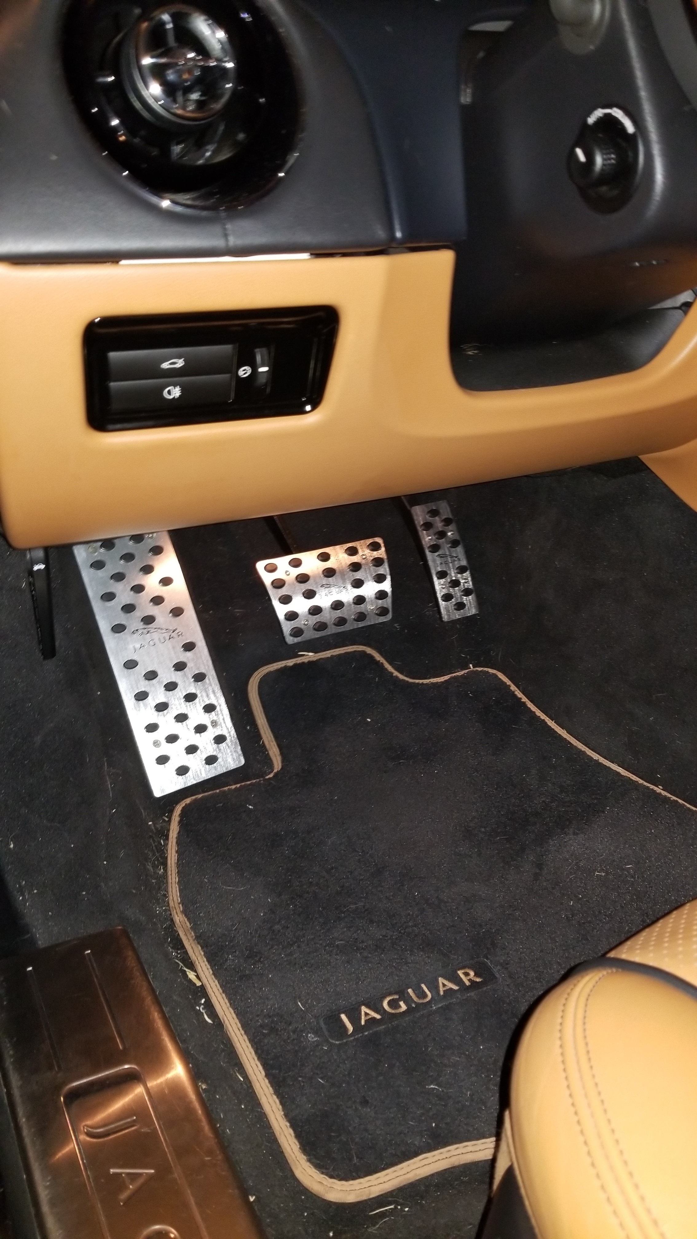

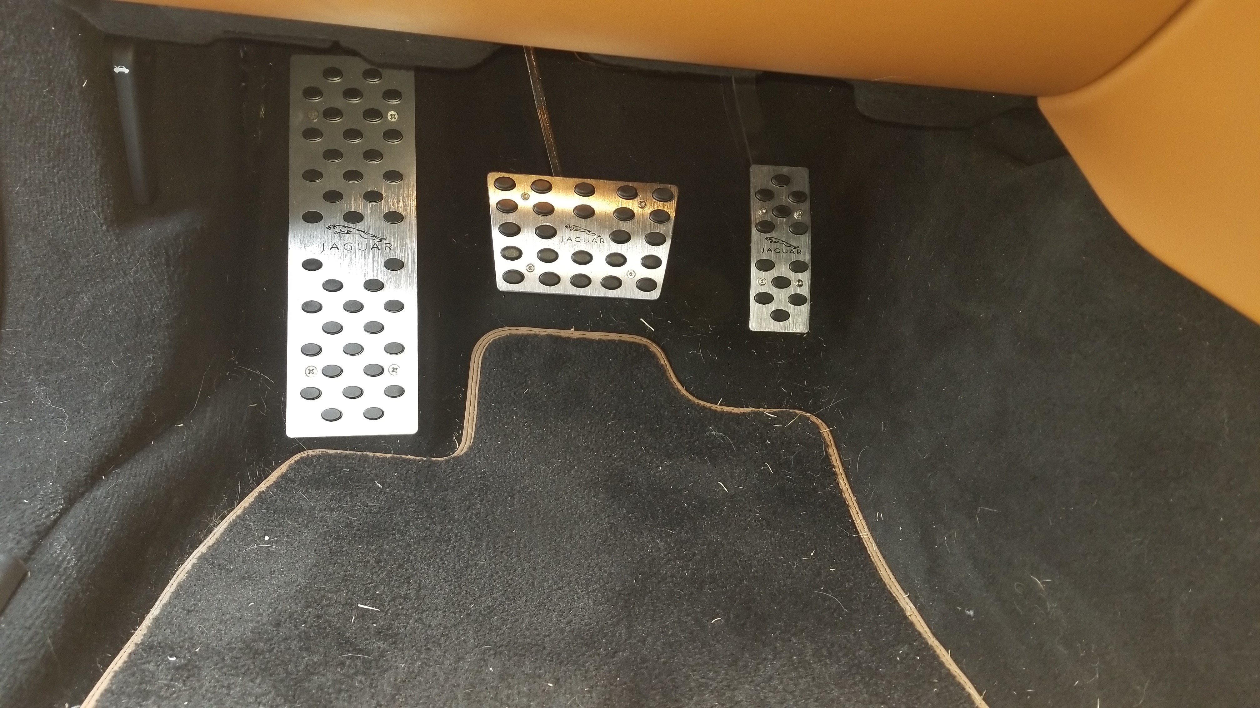

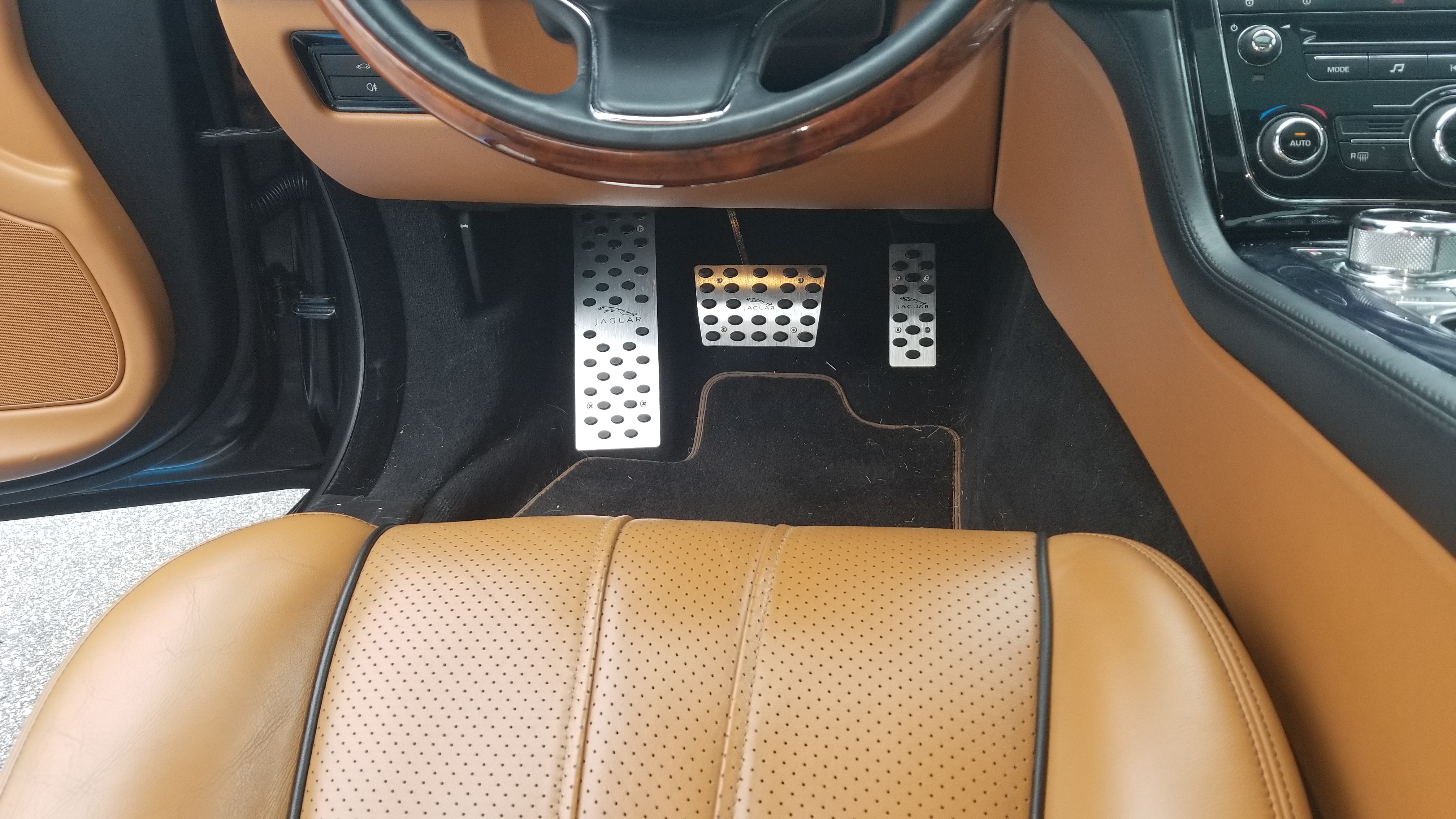

I got these a couple months ago and finally got around to installing them, because I am very good at procrastinating. They are pretty good quality. Solid metal with a nice feel, all the pedals are one piece with one piece rubber on the back that sticks through the holes. The Jaguar stamp on them looks pretty good, especially for $25. I think these actually look better than the Mina Gallery or Arden ones. Especially if you dont have an R, getting R pedals doesnt really match.

The installation was pretty easy and straightforward. I referred to a couple of threads on here because the pedals dont come with instructions, but like I said, it was pretty easy. You remove the rubber brake pedal, which can be a little difficult. I used a panel popper and it made it much easier. The gas pedal is plastic and doesnt have a cover, so you just drill into the pedal itself. The dead pedal had self tapping screws, so that was even easier.
You just line them up, mark the holes where you want to drill, and go for it. I used standard Craftsmen bits (1 broke, but it was too small anyway), and no issues drilling through the brake pedal. You even have the opportunity to position them slightly different, for example, i thought the gas and brake were a little too close, so i nudged the brake pedal over just slightly. Tighten the allen bolts and you are good to go. It took me more time to prep and figure things out that to actually do the installation. I would definitely recommend getting these, because the plain rubber doesnt do our gorgeous interiors justice.

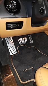

I had those in my old X350 and just installed them on my X351. But I installed them the ghetto way...I used some heavy-duty black instant gasket and glued them on! Too lazy to drill holes and such.

As for the pedals, I had tried body tape on my old car but they wouldn't hold, and so I ended up using Gorilla Glue, but it was messy and hard to position correctly and the go-pedal came off after a year or so. So I wanted to find a better way on this car.
I used the loctite black gasket to reseal my oil pan and I saw how quickly and strongly that stuff grabbed the pan before I had even put the bolts back in. So I used regular Gorilla brand super glue to secure the rubber backing to the aluminum, and then used the Loctite gasket to secure them to the pedals. And just like the oil pan, they grabbed almost instantly with zero mess or fuss.
I guess the only drawback is that the screw holes are blank, but if that really bothers you, I'm sure you could dremel the screwheads off and glue them in.
