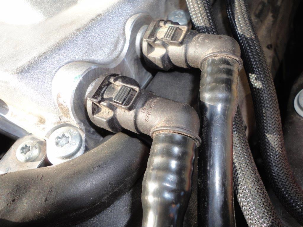

I am having trouble disconnecting the coolant lines at the intercooler. The ribbed part does not slide, nor does it seem to squeeze. There is a similar ribbed part on the underside. There must me a secret as I can't get them to release. What am i doing wrong?
push in a little, then squeeze, then pull. It’s a pain.
this was a pain for me too on my xfr. I just used some push pin pliers to push down to be able to get These off. I’m wondering if these lines can be done with fuel line disconnect tools also.

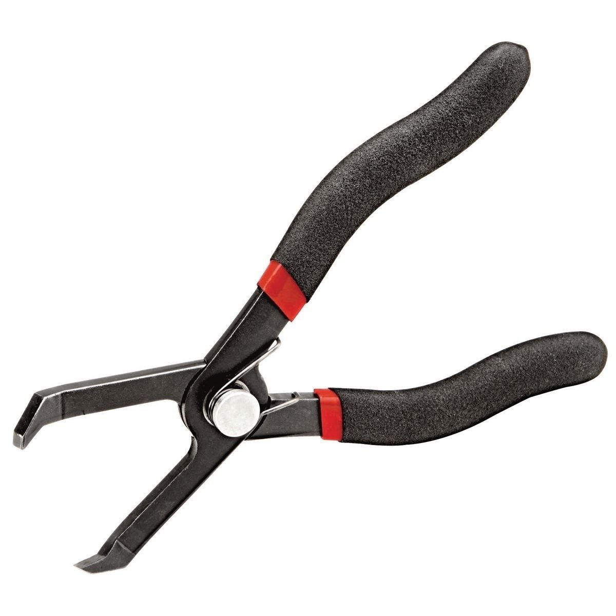

Oxidizer2K;
Who makes the pliers, is there a proper name?, where did you buy them? I looked at Autozone, Advance Auto and Lowes and showed the photo to sales personnel with no luck.
Oxidizer2K;
https://www.harborfreight.com/push-p...ers-63700.html
Also there’s usually a 20 percent off coupon for harbor freight that you can use.

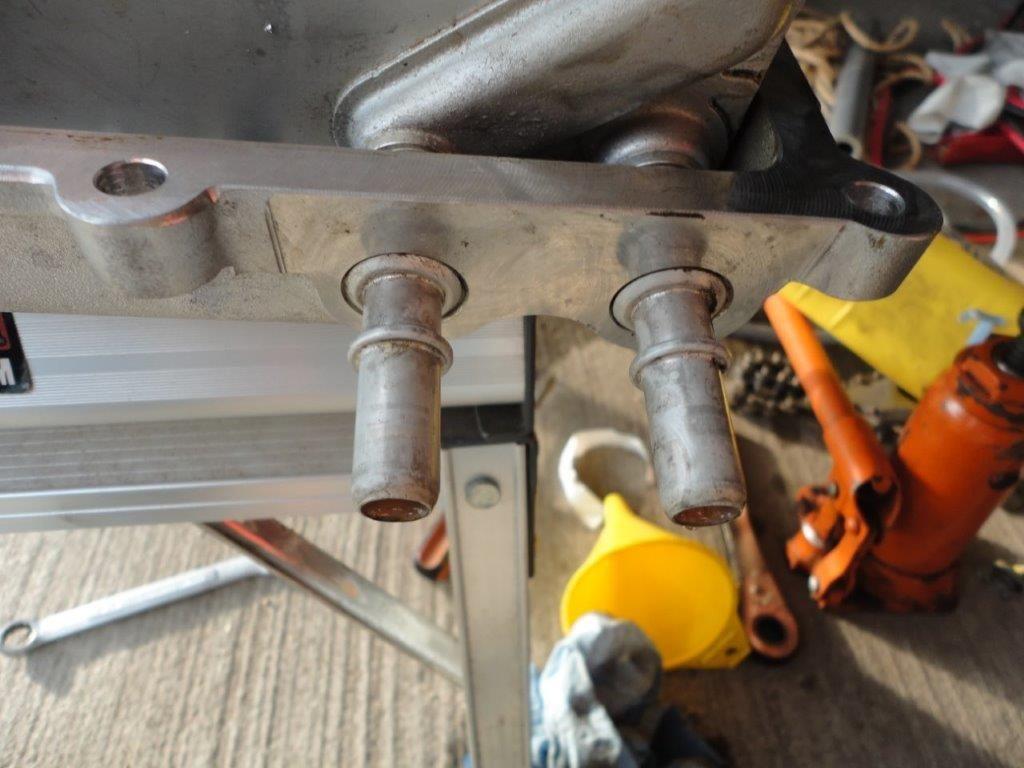

Oxidizer2K, thank you for the info for the pliers. I went to Harbor Freight, the pliers made by Pittsburg were in stock. Came to $9.75 with sales tax. They worked great.
All, this is what the fittings look like with the coolant lines disconnected.

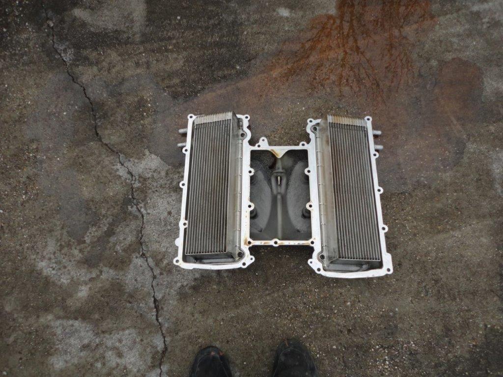

The Torx bolts securing the intercooler lid are Torx 40. Some secondary clamps were Torx 27. Four hex head bolts on top of lid are 10 mm. You have to remove a bracket for what appeared to be a heater valve (?) to get access to three additional Torx bolts along the rear. Getting the lid out was a pain. There is a rigid steel tube at the front that interfered with the clearance. I did not remove it. The rigid line connects to the Air Conditioning Compressor. This photo shows the underside of the lid with the intercoolers attached.

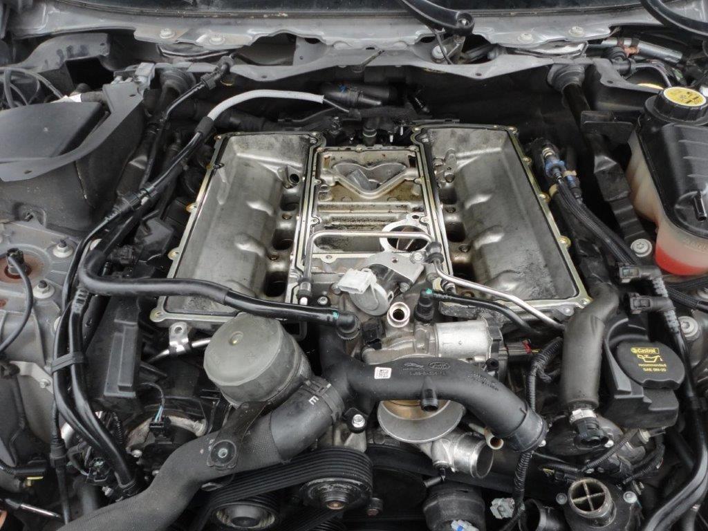

there were three Torx 40 bolts attaching each intake manifold to the supercharger and another four hex head bolts securing the intake manifold to the cylinder head on each side. Put a rag or shop towel in each intake port incase you drop something. I expected the manifolds to now come out, but they seem like they are still attached. Anyone know if there are additional fasteners that I am not seeing? I also removed the plastic cowl thinking it would give more room at the rear of the engine, but as you can see, I would have to remove the vertical pieces to get any additional room. In the end, it was not necessary.

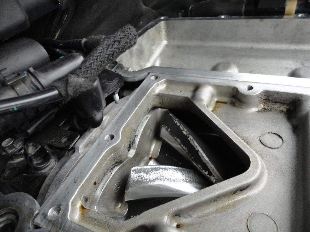

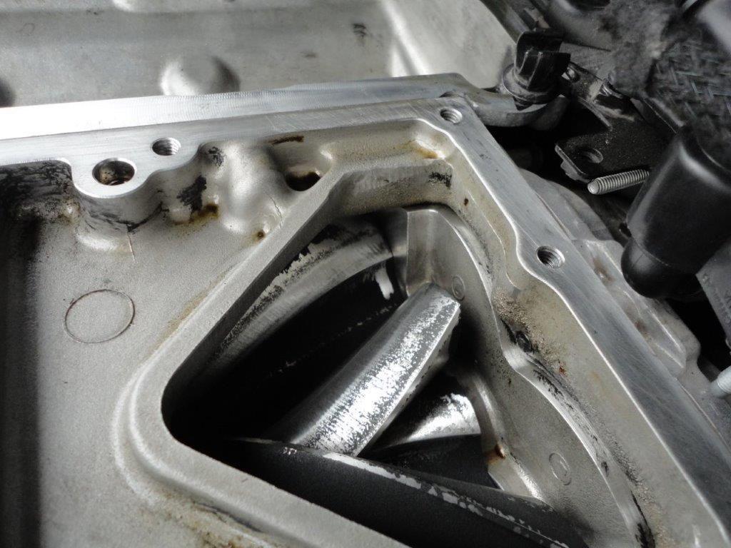

I also noticed that the dry film coating on the impeller rotor is showing wear at 57,000 miles.
Mostly normal but check for rear bearing play. The coating is to fill imperfections and tighten the tolerances it it’s too tight it will come
off. Do the solid coupler mod and toss the spring loaded one.
I used a large crow bar at a very specific point under the supercharger with enough leverage it will pop from the steel sleeve guide boss that is holding it in place.
Take off the throttle body to get to a good place for prying.
mike, I had to use an engine support bar to help me lift the supercharger off. There was another thread that helped me with this process but Here’s a link to my thread.
https://www.jaguarforums.com/forum/x...oupler-241262/
also, that rigid tube is a fuel line. I removed it to make it easier. I think i used a 17mm wrench to do it.

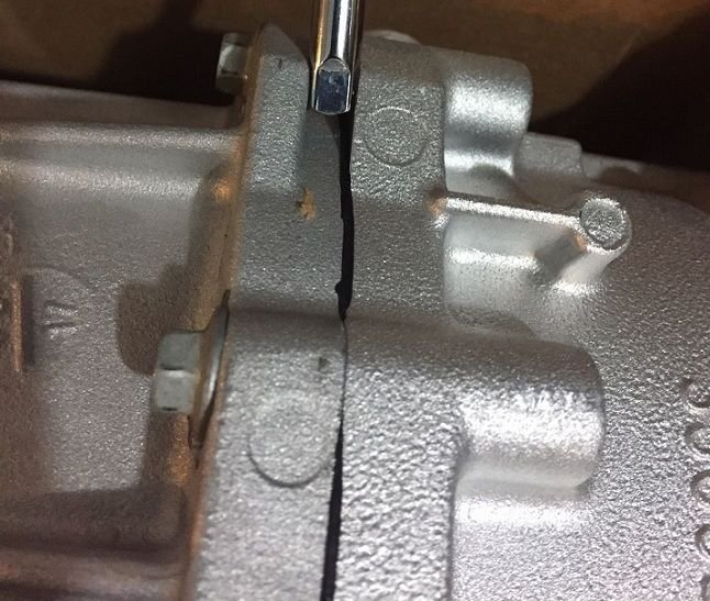

Old Jan 25, 2021 | 12:12 PM
clubairth1's Avatar
Community Influencer
Posts: 12,093
Likes: 3,367
From: home
Since you are replacing the coupling getting the snout off the SC can be a pain. Jaguar built in a spot to pry the SC snout off. It's hard to see and this picture is from underneath.
No gasket just some really strong sealant was used.
