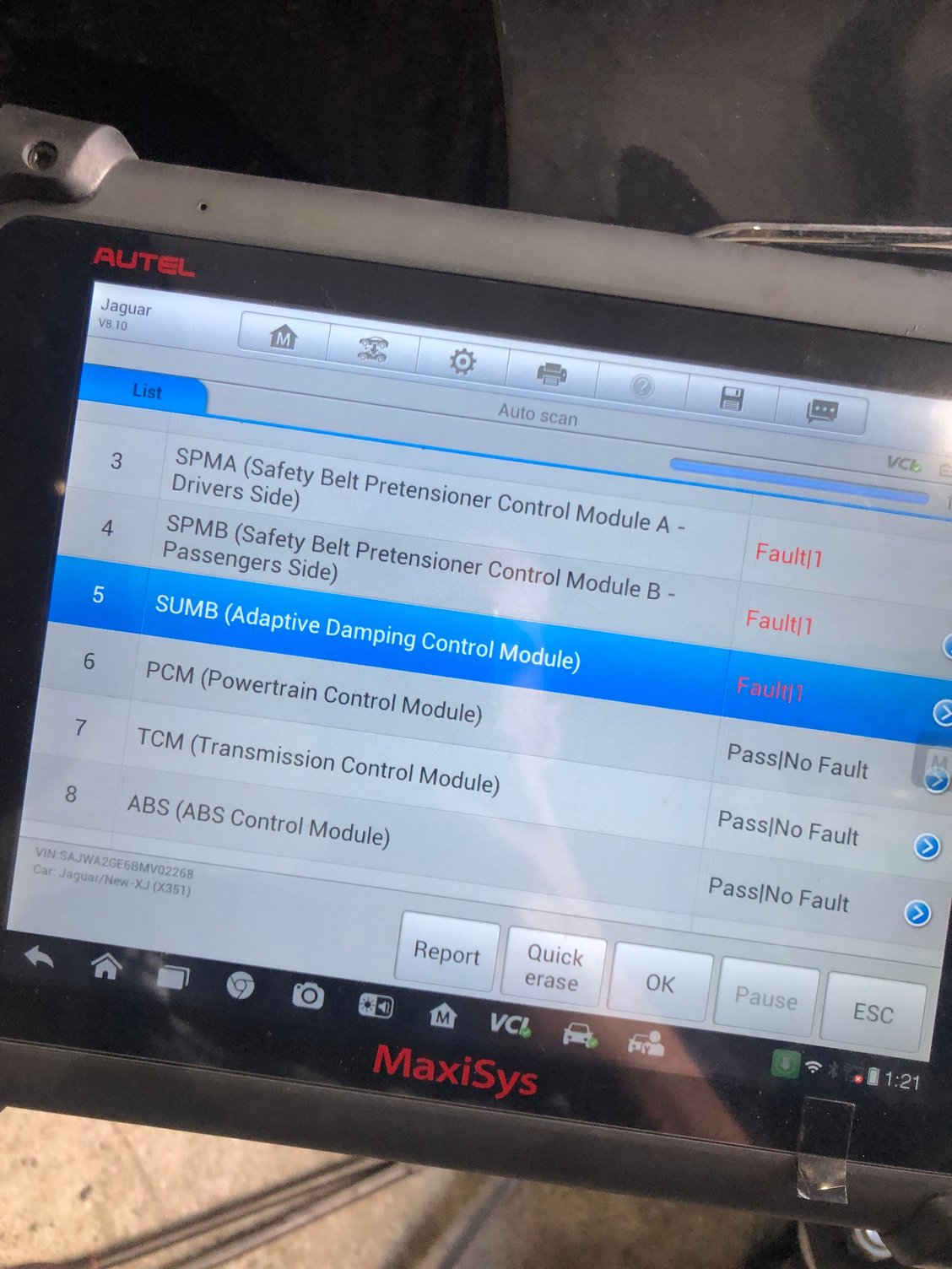

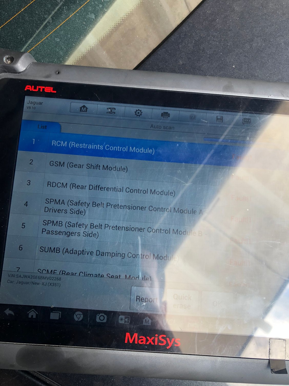

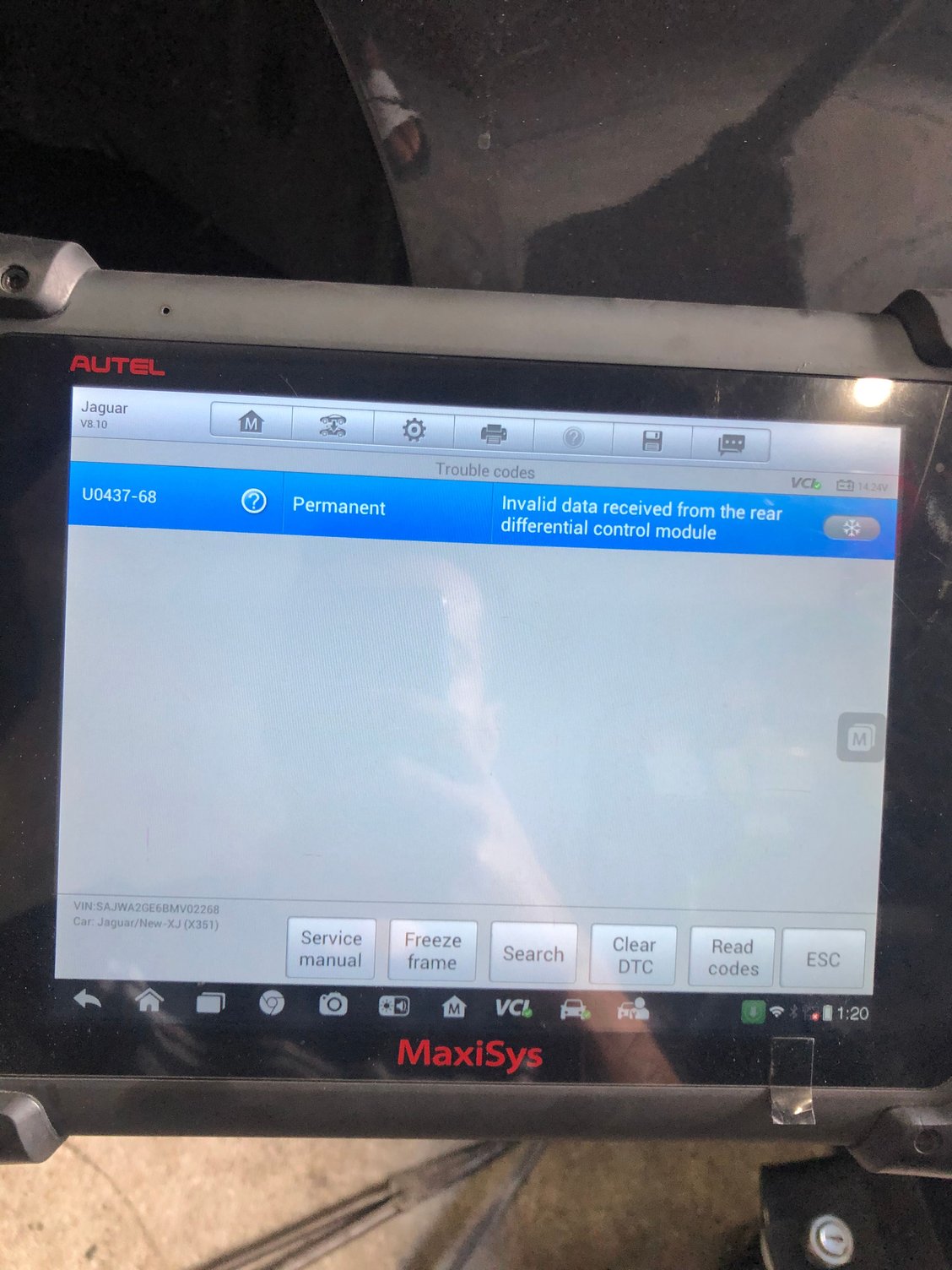

Hi Alex! Could you kindly tell me which modules did you reprogram?
i am having a 2011 xjl supercharged and the same issue. The warning sign pops up saying e diff unavailable and dynamic mode does not activate if i press it. Also the same symptoms of shuddering while driving a little. There is a weird smell that comes from the engine after driving a little (coolant burning?) yet the oil levels and coolant are fine.
Showed it to my mechanic and he was stumped too. Any help would be greatly appreciated
i will also attach few codes that were stored:
try reprogramming ediff module specifically. In my case I couldn't reprogram it as was getting an error, so I went and modified active session file which makes reprogrraming to multiple modules and this did the trick for me. I am using SDD JLR
