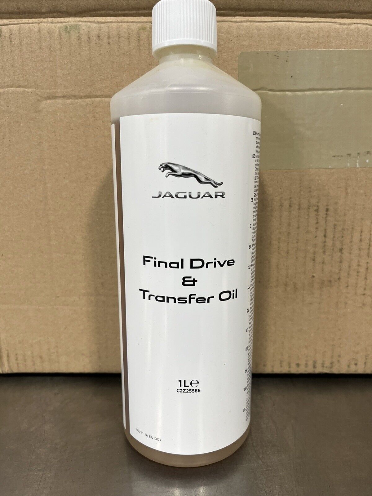

Anyone know where I can get this fluid for low price it is expensive at the dealer $151.00 per liter
New Genuine OEM Jaguar Final Drive Fluid C2Z25586

A quick search shows that Redline MT-LV fluid is compatible with that ridiculously overpriced JLR brew at a fraction of the price, see here: https://www.redlineoil.com/mt-lv-70w75w
Quote:
How do you know its compatible there is no writing on the bottle Originally Posted by OzXFR
What about the Motul fluid I bought for the differential I still have 2 liters left

The oil in question is the oil for transfer case for AWD Jags Originally Posted by clubairth1
