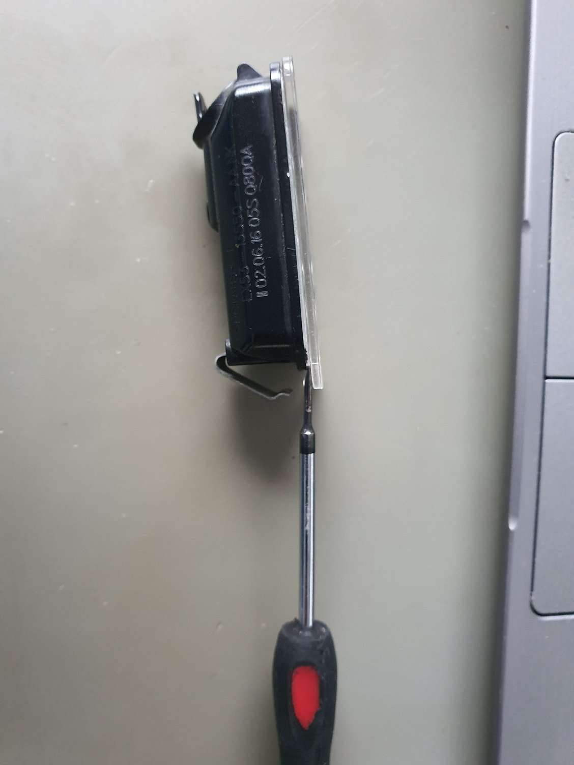

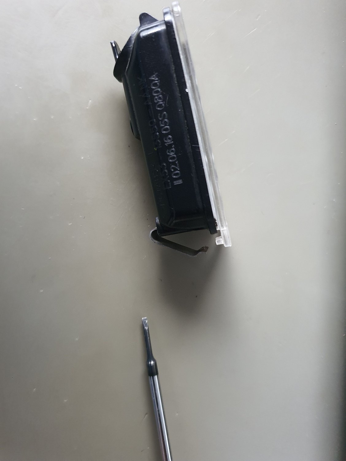

So here is how to open it, just heat it up a little bit with wife's hairdryer, it helps even with superglue, just not that much. Then stick a small screw driver between the lens and the cover and turn it.
2 Things might happen. 1) the lens will break 2) the lens will make a slight "click" sound and separate from the housing. The second is mist likely as this glue is no stronger than my 98 years old grandma's teeth. Work your way around to do the rest of the lens and take it apart.

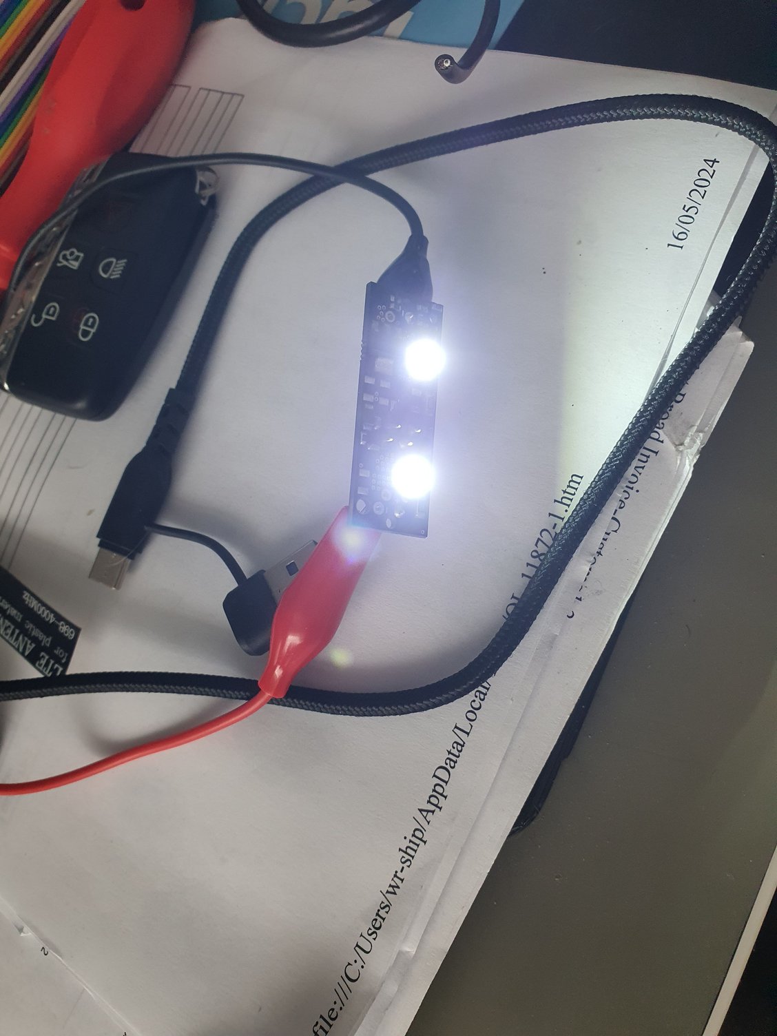

That's it! power it using a 12V power supply to make sure it works.
I left it powered for a few hours to make sure nothing overheats and by using an infrared camera I found out that max temp on the board is 40C now. Pretty normal.

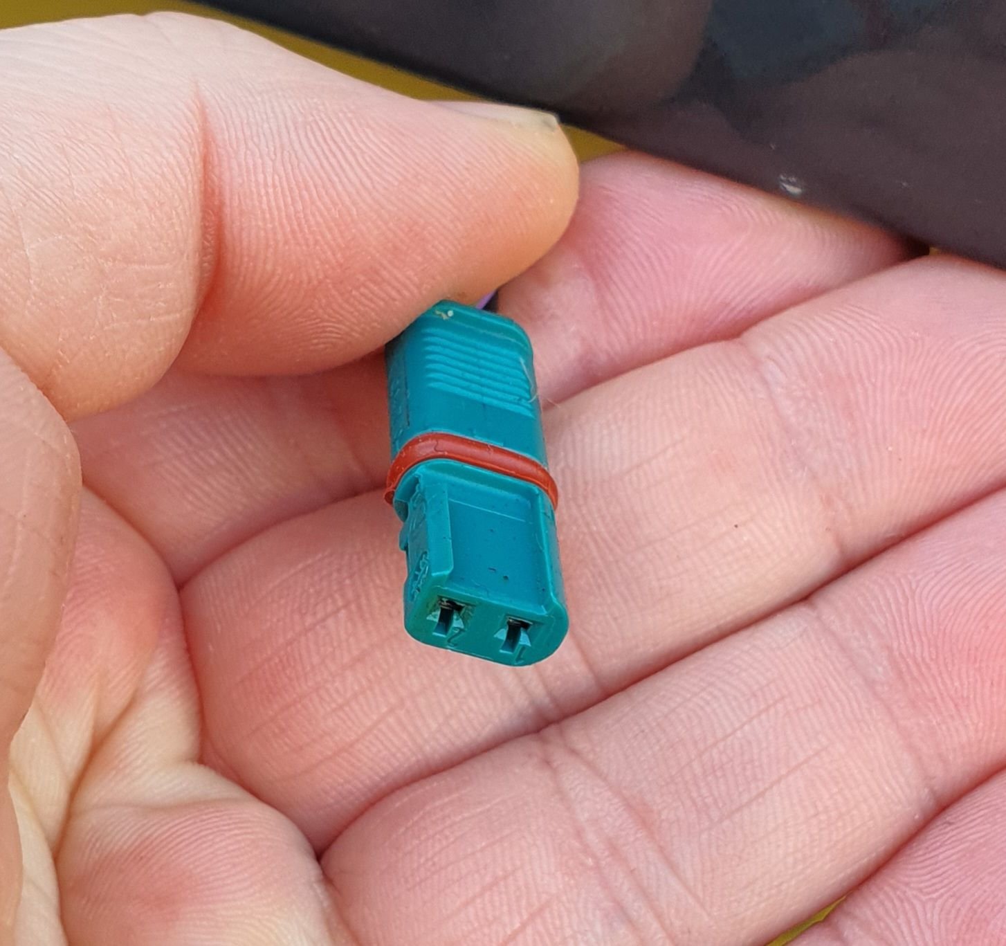

Nope, the connector is different and unless you want to do some cable chopping they won't fit.

Yes I know, but 2016MY have their own specific connector. The fixtures look similar but you won't be able to plug it unless you chop the factory connector off.
