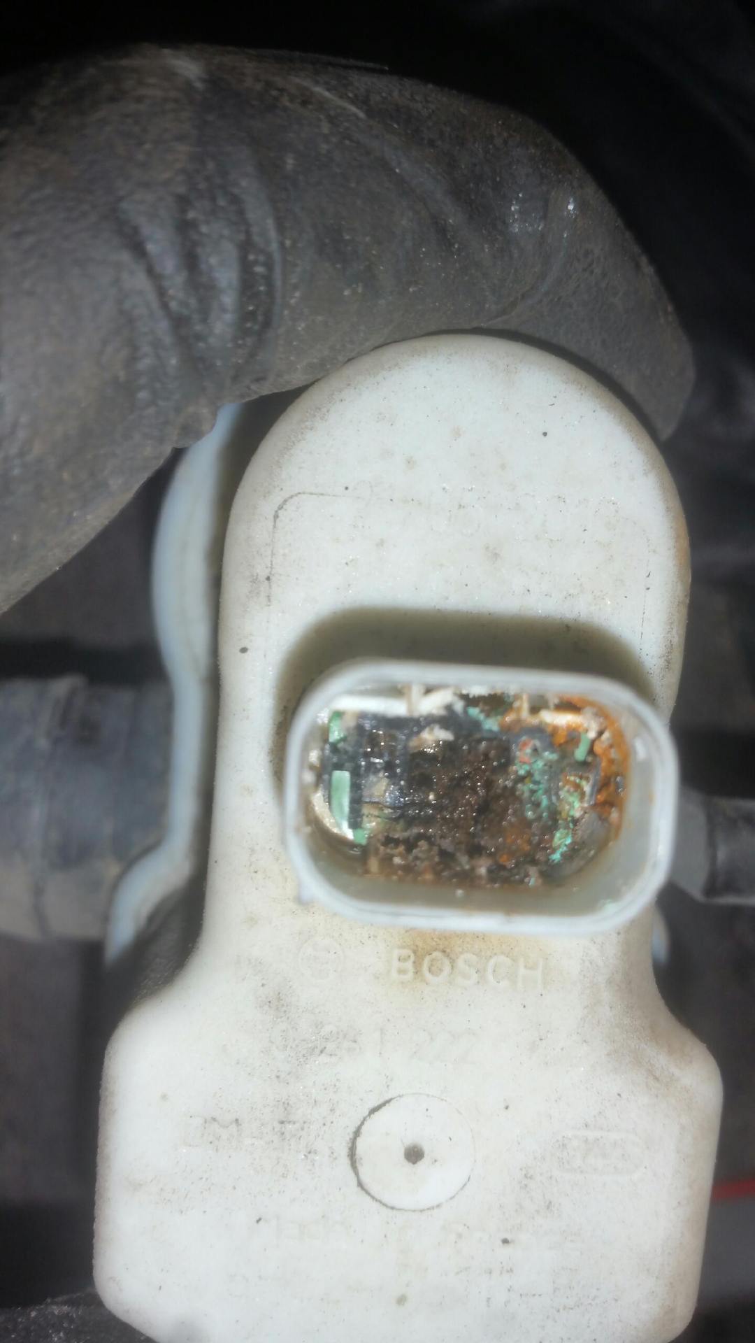

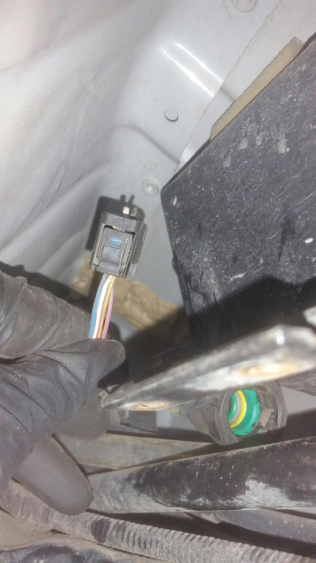

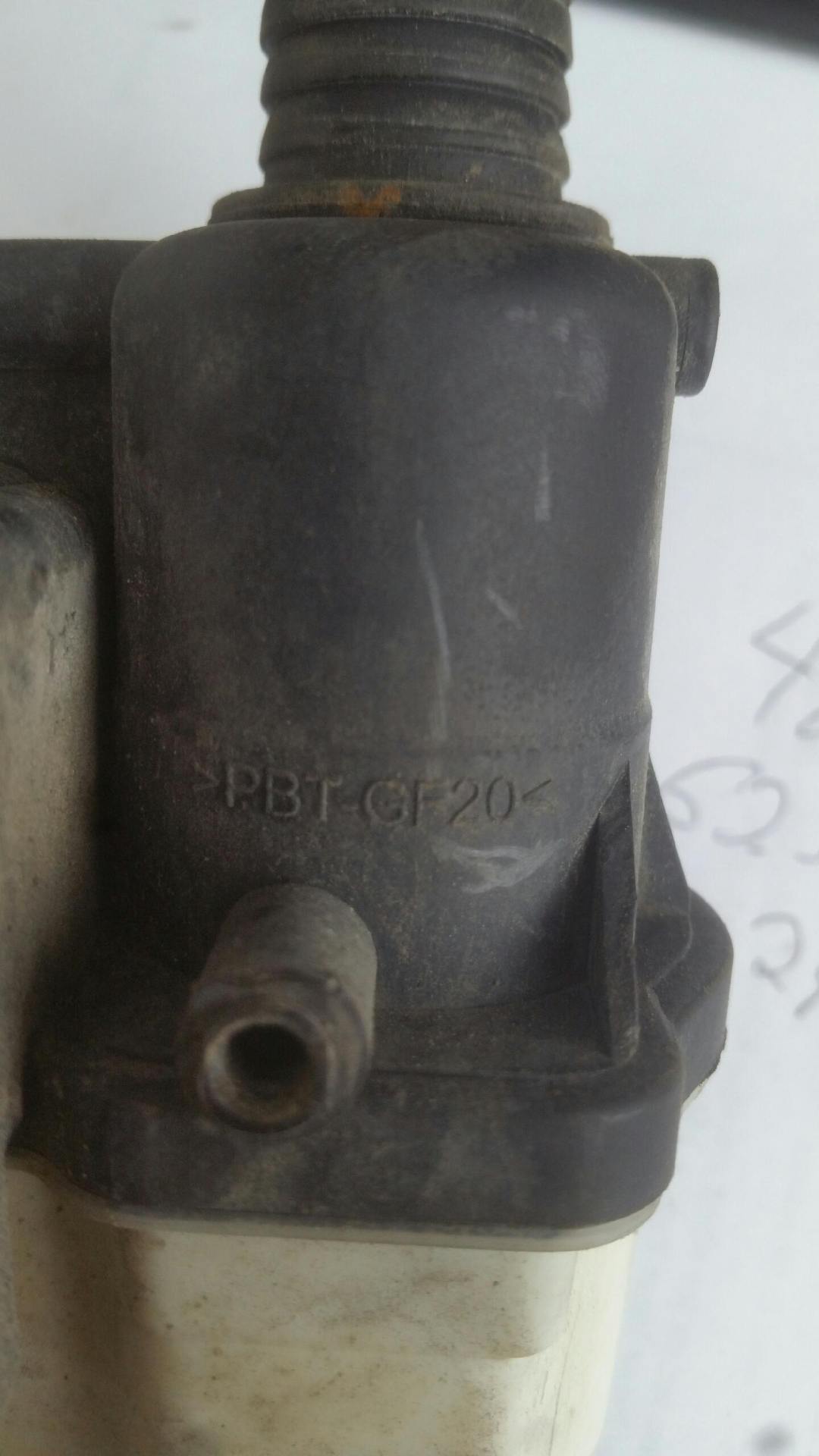

Default Found the problem
JAG V8. It is the EVAP LEAK DETECTION PUMP and the CONNECTOR. I found the pump, but having hard time finding the connector, as it is a part of Body Hernes and Jag does not sell connector separately. They suggested that I should be looking at the junkyards.

Default Connector is burnt
Yes, Connector needs to be replaced. Looking to swap the connector not the Harnesss. Its a tragedy

Default Finally fixed
Parts that we had to change other than the leak detection pump are as follows
1. Canister- C2D40532
2. Filler neck pipe- C2D49256
3. Shield foam- C2D49253
five hours of labour needed as it required the removal of the rear differential.

moe, if you have the ability to disassemble the connector, you should be able to get new pins from a place like NAPA (they seem to have the best choices when it comes to electrical stuff). You will just need to get some sort of sample so you can match up the repair pins to what is in your car.
To get the pin out, you can slide a really small (jeweler's) screwdriver down along side the pin and that will push in the metal hair that locks the pin in place. Once you get the 2 locks pushed in, the pin will slide out the back of the connector. From there, you can cut off the old pin and solder the wire to the new pin. Then inserting the new pin is simply pushing it back into the connector till you cannot pull it out by pulling on the wire. If it pulls out, then you need to push the wire in further. YOu may need to take the small screw driver and push the pin in that way to ensure the locks click into place.

Thermo... great minds think alike... thats exactly what I did

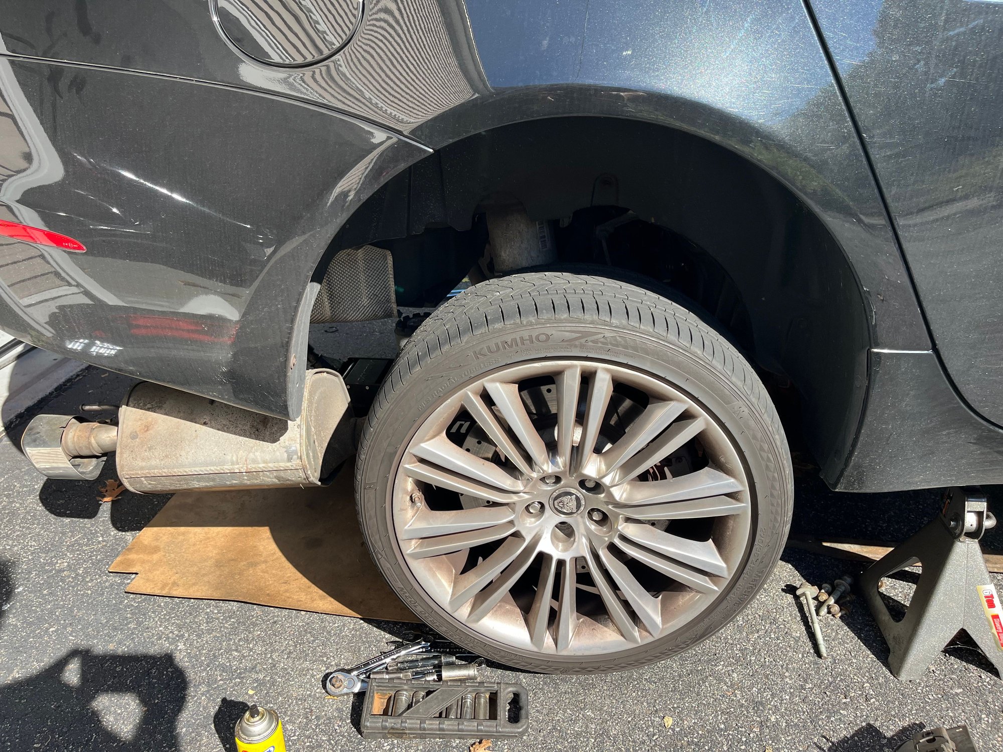

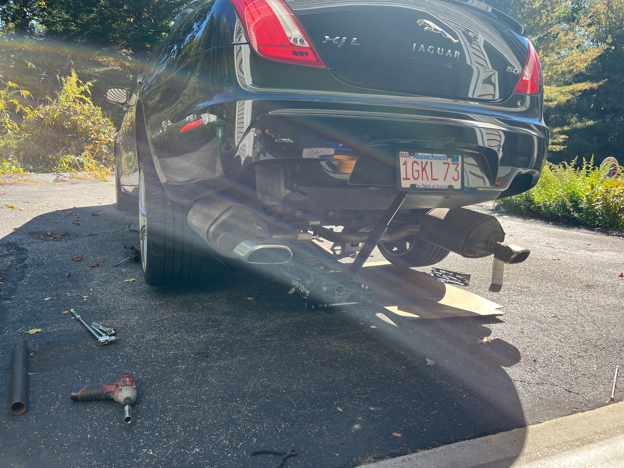

This was a PITA but replaced the pump and canister this weekend. Lowered the IRS as far as the brake lines allowed and worked from the wheel opening as much as possible. I hope the code doesn’t come back. Wheels and tires need to come off I know the pics show otherwise but I did remove them for better access.
