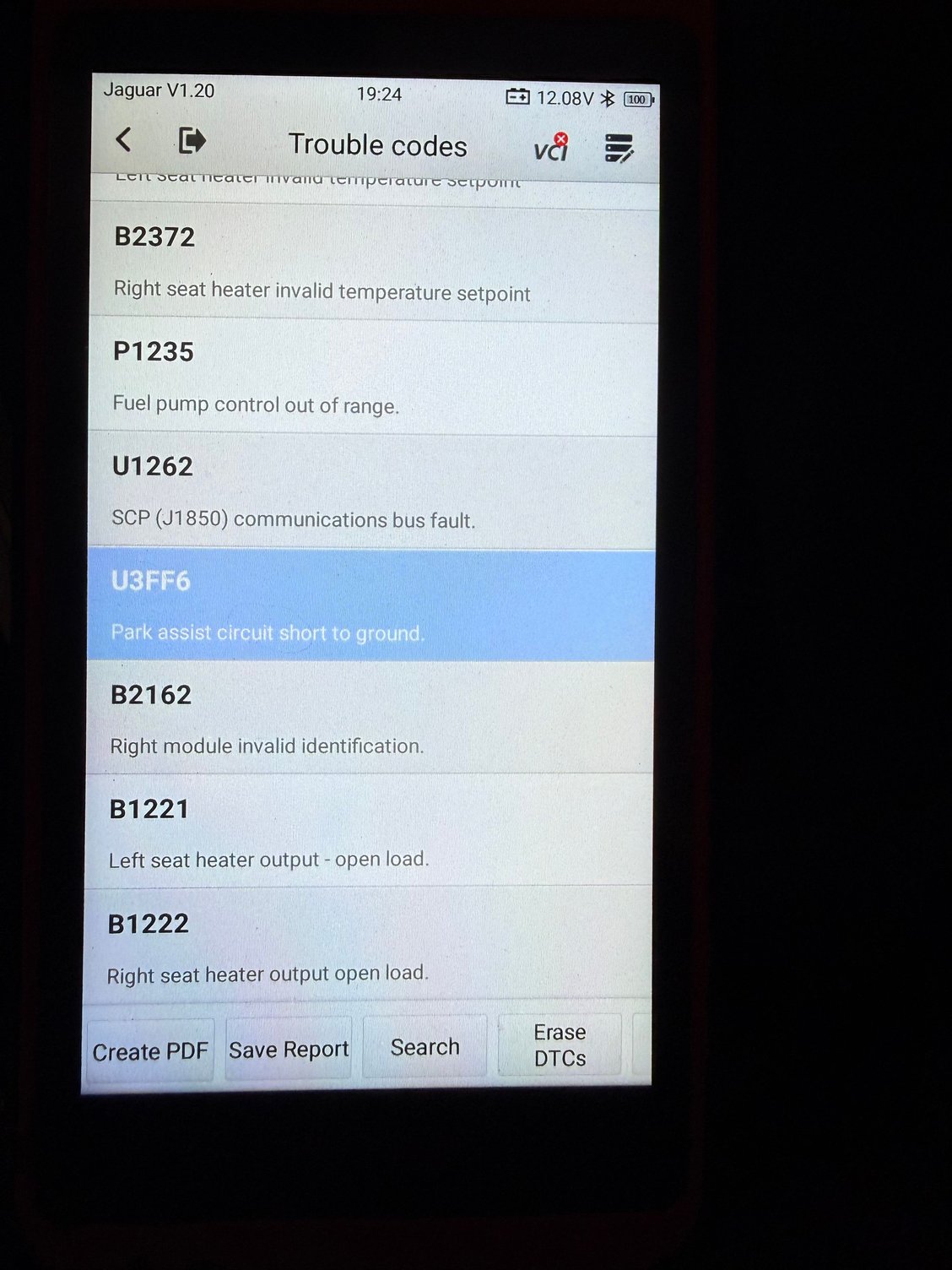

Hello all, having an issue with all parking sensors front and back, I ran diagnostics it’s shows a grounding prob
lem anyone seen this?

It also shows your battery voltage is 12.08v. Low voltage can cause all kinds of strange results. Try charging the battery.

First with no car info of any kind it's hard to say. Again what are the ALL the car details including where you live? Is this a Diesel?
Post back to fill in the details for better answers. Include what scanner your using as that can be a problem as well.
Agree with Six Rotors. Start with the basics first. How old is the battery?
What is the resting DC voltage after the car has sat all night? JLR wants 12.6 VDC.
