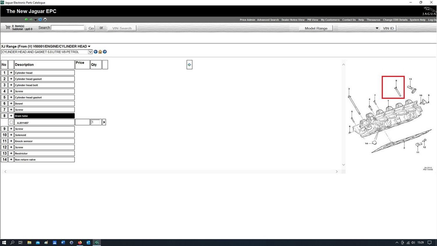

Perhaps item 8 - Drain Tube AJ811497:
tanx so mach
i order 2 new ones
