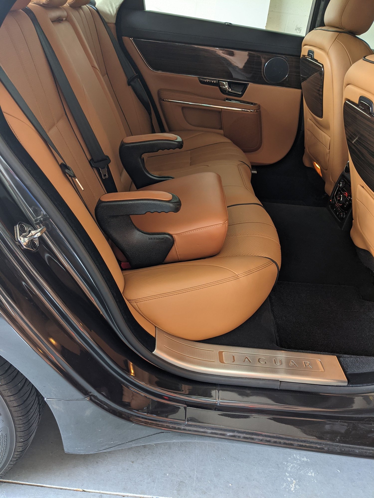

Here are some pics I got from the dealer. Lots more in this album.
This car even comes with its own matching booster seats.
Never seen anything like these. Anybody know if they are a Jaguar accessory?

Looks like you found a good example. I've never seen those booster seats before, and they're not listed in the 2011 sales brochure.

  • I looked closer at the booster seats and they look custom made. Not sure who made them. No markings that matter on them. I do remember that Recarro did custom car seats so maybe try that if you want matching ones similar to these.

I decided to sell one of the two custom booster seats.
Its in the marketplace now.

These booster seats are great, i'll check it out on the marketplace.

And the booster seats are great! It looks like they were either made by Clek originally or customized from one sold by Clek. I just joined to try and PM you about them in marketplace, but I’m a new member and can’t PM yet. Let me know if they are still available. Thank you!!
