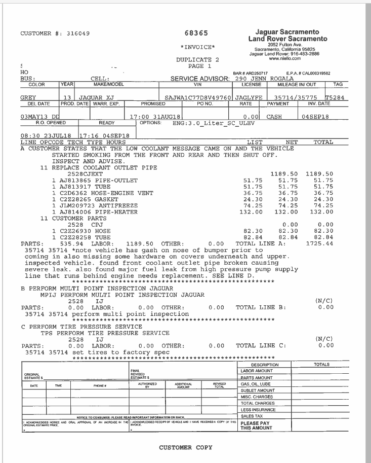

I set it up to be taken to a place that does very thorough PPI in the next day or 2, however just today I got a condensed summary of the actual services performed at the previous dealer (JLR Sacramento):
"Hello, I cannot send the actual RO, as customer info is on it, but here are the dates and mileages with repairs in a condensed form
12/2016@22k miles – oxygen sensor and trans pan leak repaired
6/2017@23k – supercharger isolator, high pressure fuel pumps, replaced for rough idle concern
9/2018@35k- engine replaced
2/2019@40k- replaced high pressure fuel pumps and lines
5/2019@42k-replaced transmission pan and fluid, for trans slipping concern
8/2019@43k- replaced transmission
That is all we have for records here"
has anyone ever seen a more aggressive service log for a vehicle before 50K miles? was able to speak to the advisor for a bit who didn't have too much info other than seemed the engine had overheated from a coolant leak, unsure of transmission, but both were done on an extended warranty

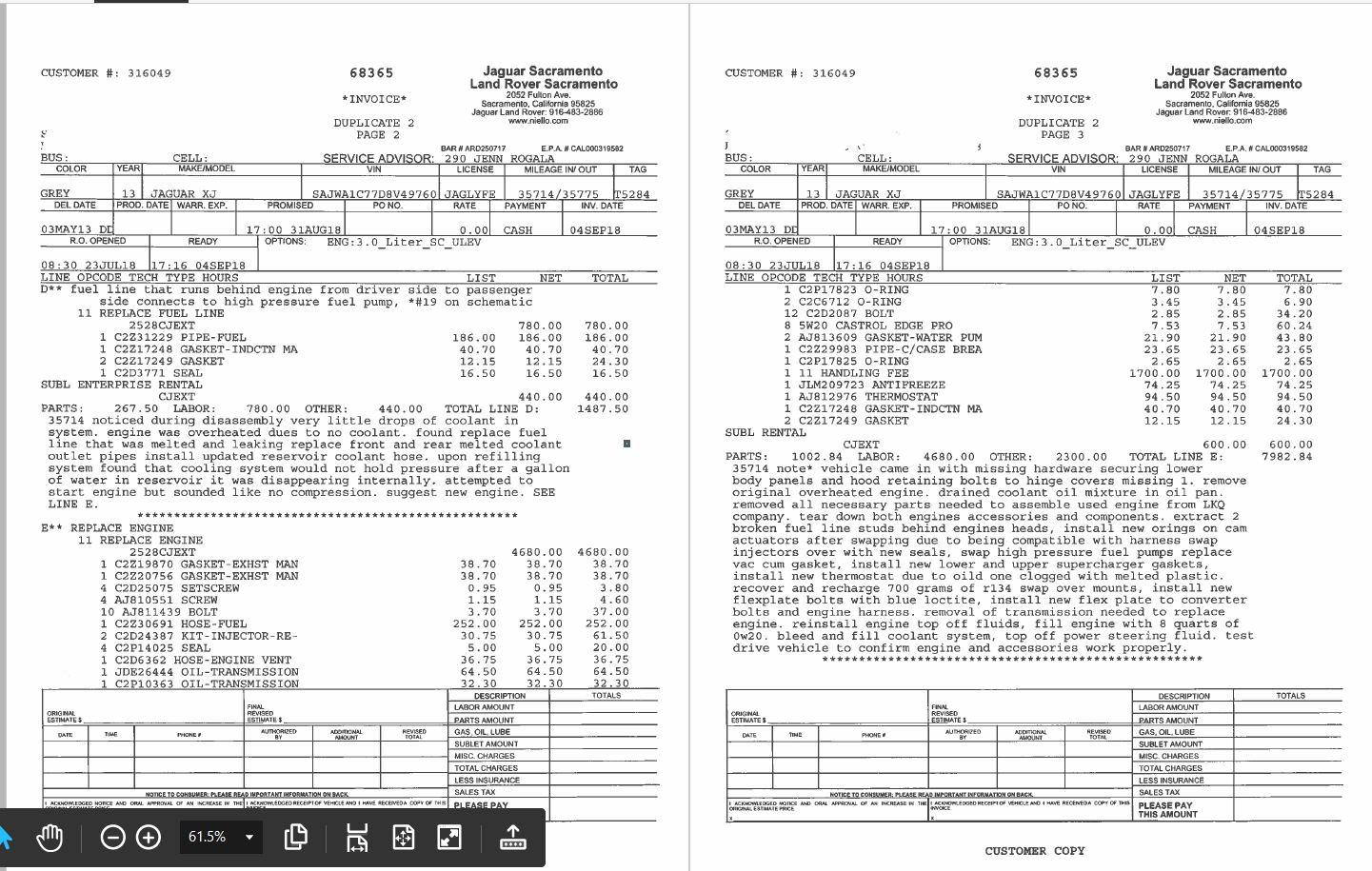

yep def pulling eject on this one after getting the full service records for the engine/trans replacements, looks like they put in a "used engine", and all the parts costs seem low for full engine/trans replacements
seems like because the work was performed on an extended warranty, used/generic parts/components were required for the repairs
here's the records for anyone interested, they're pretty wild with various other concerning notes

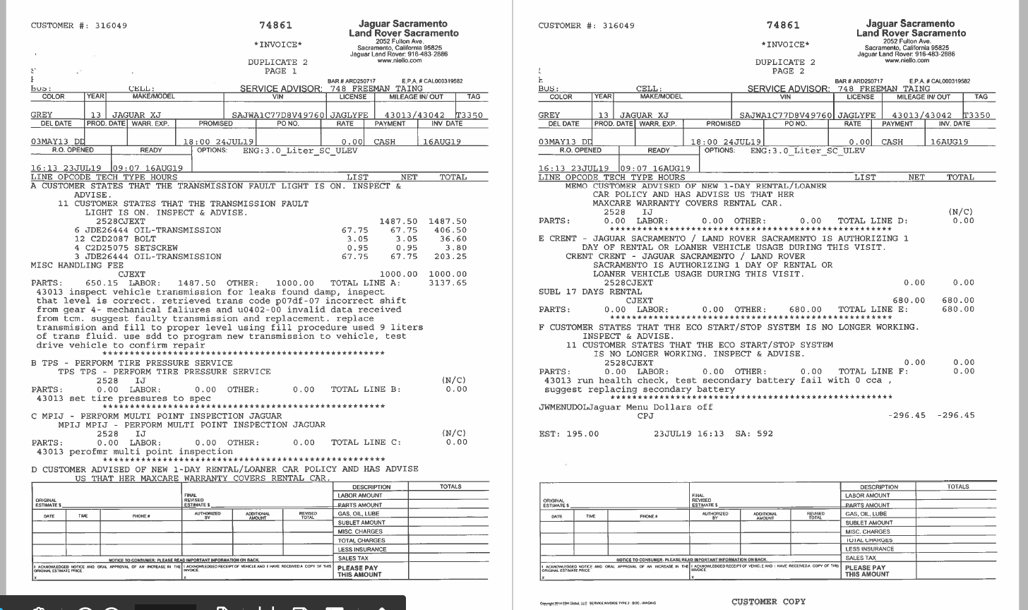

That $1700 "handling fee" line item is an interesting one.

They 100% put a used engine in this car. The list price on a new engine is $28K I tell our customers all the time, DO NOT LET a 3L or 5L JAGUAR OVER HEAT! It's a 28K mistake... plus labor cost.
I am a little concerned that in the notes it says "swap high pressure fuel pump" but there is no where (that I have identified on the R.O) where the fuel pump part and cost is. Does anyone see that part?? It would surprise me for the dealer not to have put that on the repair order.
The notes from the mechanic also says he used 0w20syn oil but the repair order has 5w20syn. If it was the 5w20syn OE by Castrol that's great but Jaguar did recently change to 0w20syn after Castrol stopped producing the 5w20syn OE (or at least that's what our dealership advised us). It seems like the mechanic and service writer weren't communicating with each other very well on what parts were used/replaced.
Putting a used engine in a car isn't a bad idea, assuming the engine never overheated and had low miles. But there is quite a lot of previous repairs done to the car. I would 100% have a master mechanic give this car a full diagnostic before making the investment.

Rothwell you're right! There's a $1000 misc handling fee and a $1700 handling fee. I have never seen that before and would be curious to know what that fee is for.
