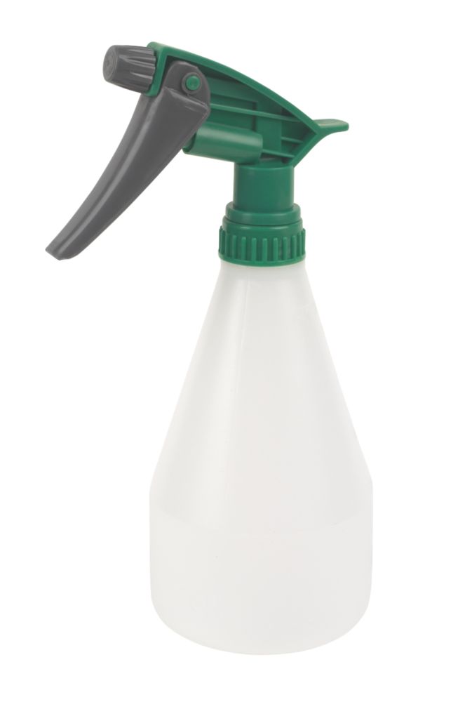

Sorry to hear about your experience, although the fact that you find another JLR product to be working to your satisfaction should give you some hope.
And testing the rain sensor is pretty easy, if you have one of these:
