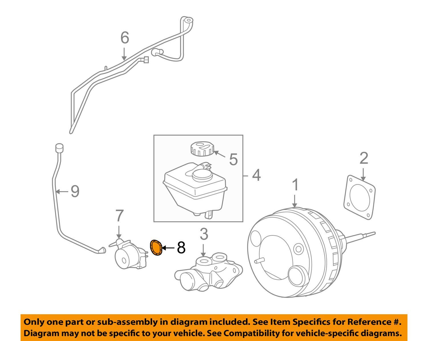

I wish I have. No, it was by eye balling by my mechanic.
For the common one, do you mean this seal? I plan on changing it as well even though mine may not be leaking.

It's not labeled but yes that does look like the O-ring for the vacuum pump.

Hi, if you need to do this gasket on the diagram do you need to do full brake bleed afterwards?

?? This is a gear driven vacuum pump. When the O-ring leaks you change it.
No brake fluid it leaks engine oil.
