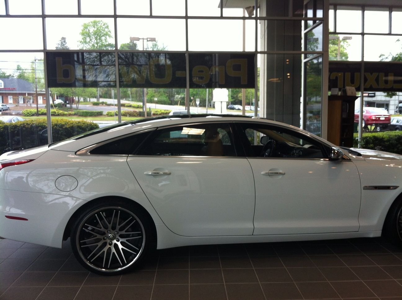

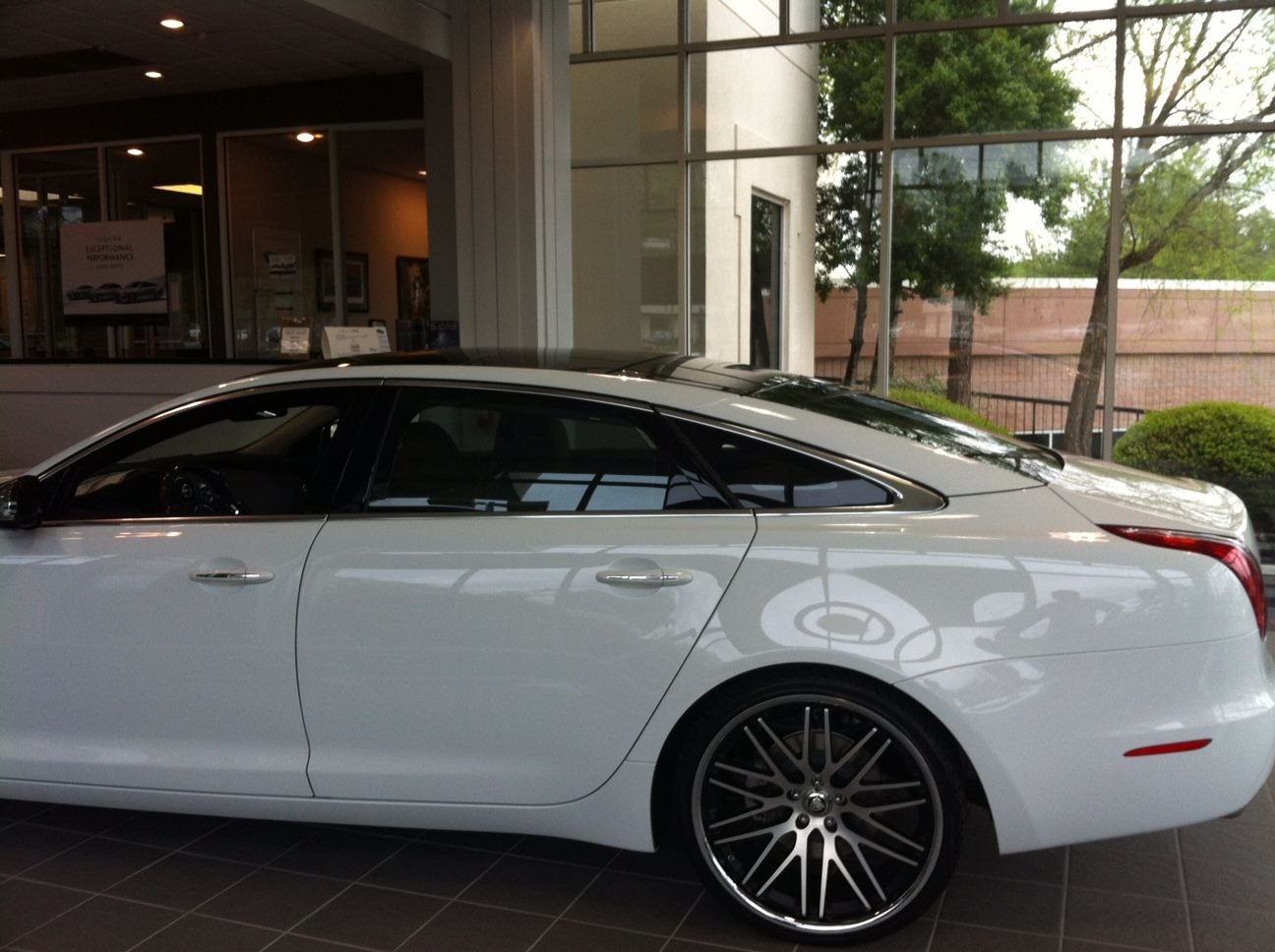

I did not do mine but here is one done back in 2013
