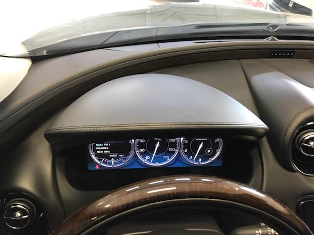

I also have a correction. The Jaguar does have a sensor at the base of the windshield, for the "auto headlights" I would assume. Just like my 2011 Chevy.
It's hidden by the slope of the dash.

The domed sensor at the base of the windscreen is the solar sensor which is used by the automatic climate control system to accommodate the heat gained through the glass.
I'm not sure which sensor the OP is referring as there are a couple around that area. The light sensor for the auto-dim/electrochromic mirrors is on the driver-facing side of the mirror (look for little shiny dot at the bottom). The camera for the AHB/auto-dip full beam headlights is on the rear in the masked glass area, and visible as a little camera lens if you shine a light in from outside. There is also a humidity sensor that is used by the climate control system to automatically defog the glass, and the rain sensor photodiodes which sit flush against the glass and measure the internal reflection of an IR beam bounced around inside the glass.
