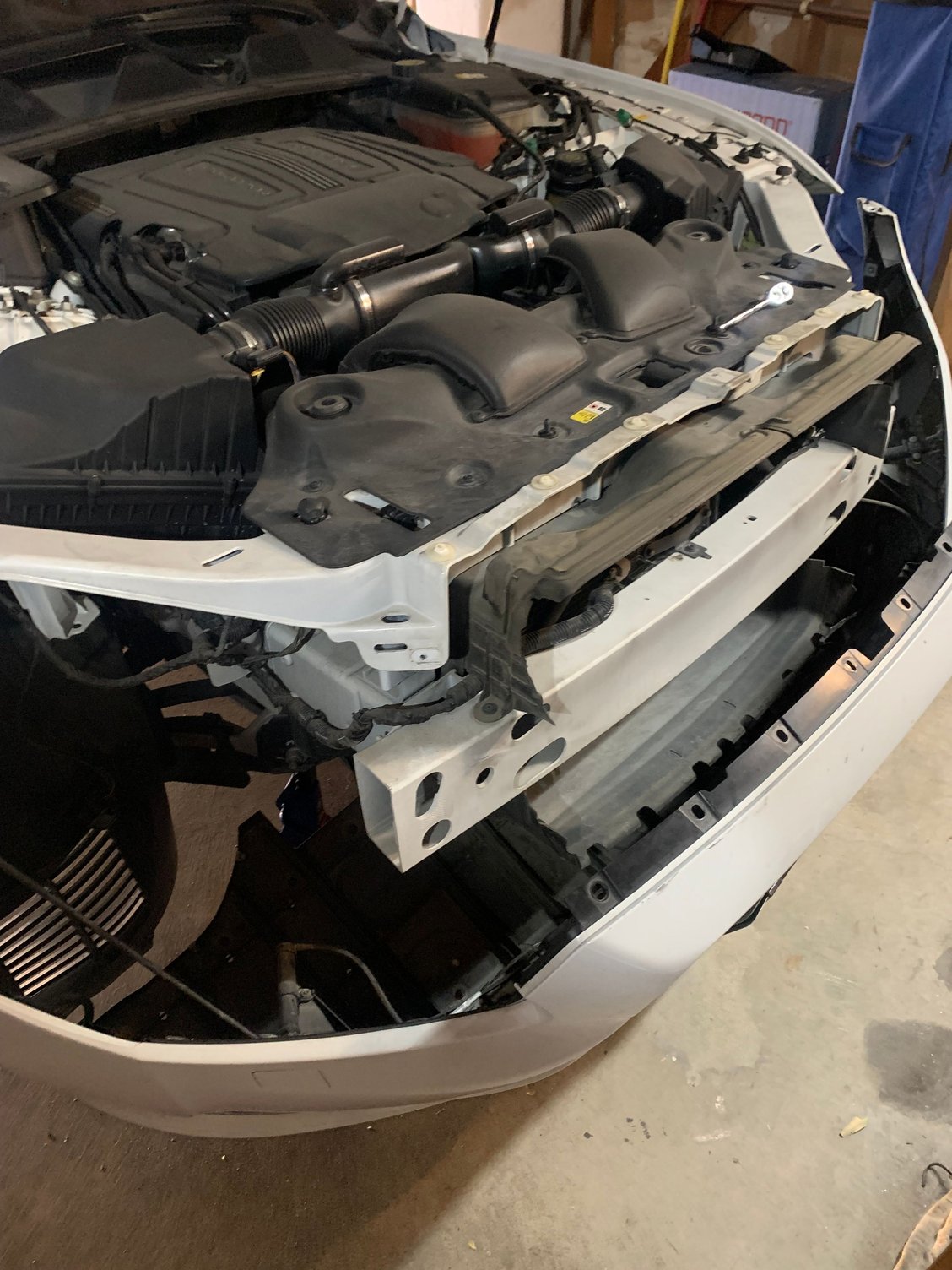

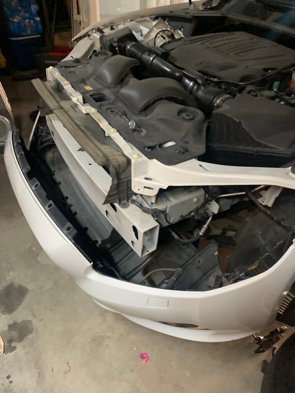

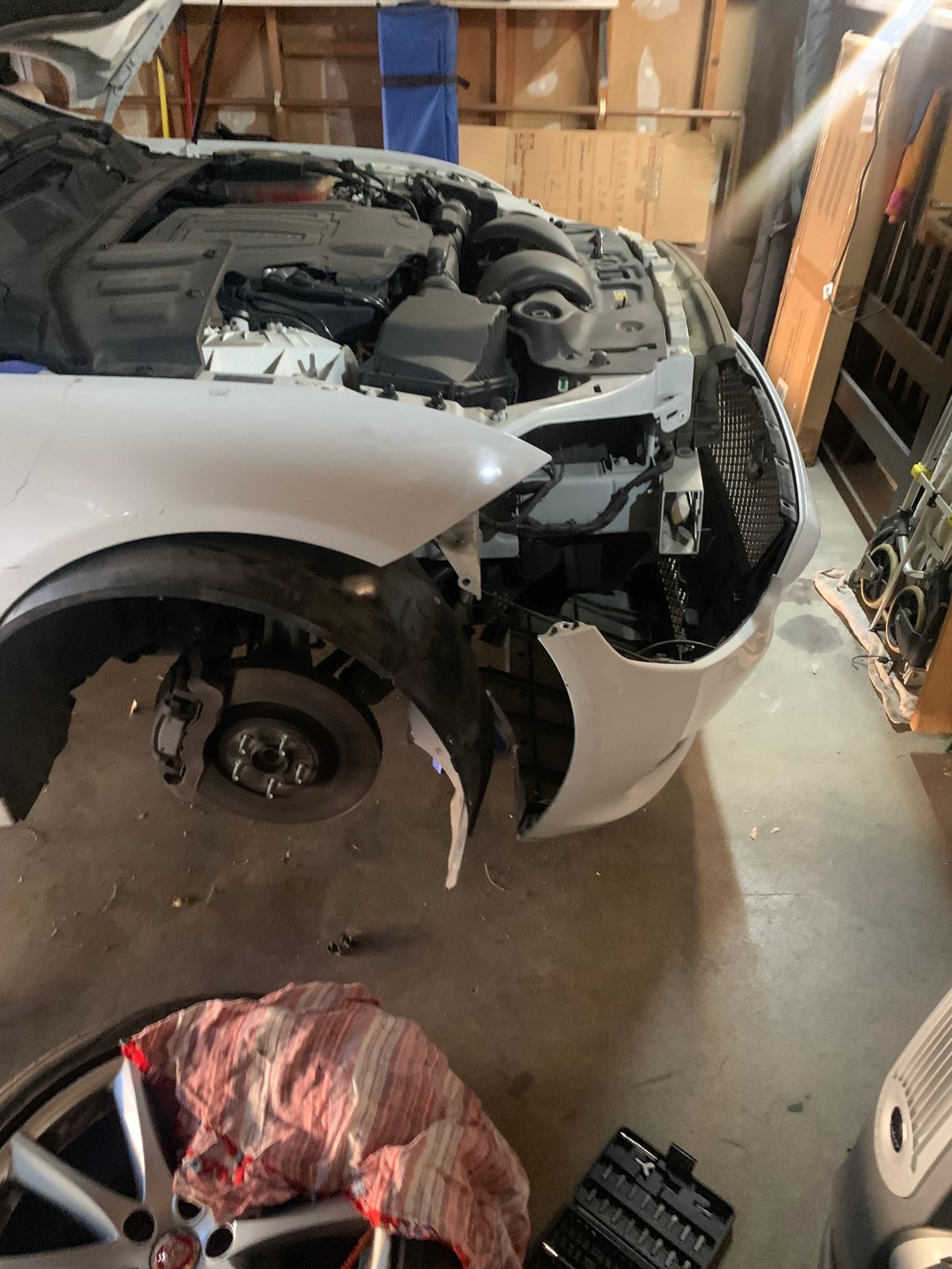

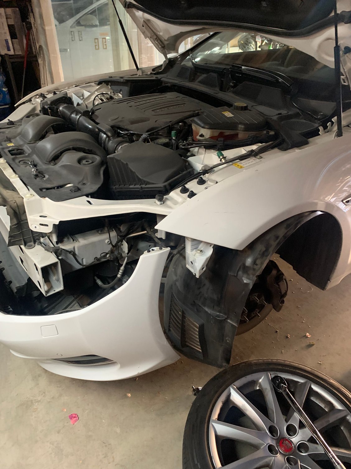

Other pictures showing points of no return are below. I never sing my own praise but when the lights came up after I finished I felt like on top of the world. I gambled on the DMEX bulb as it later came out in my probe that the Osram bulb came with the car but I am ready to try it out for now and see how long it will last and with this experience the next change if I still have the car will be easier if bulb does not last as long as the Osram which has lasted almost 8years of my owning the car. Hey guys thank you to all the senior members, veterans and admins. All of whom I have learnt and gained a can do confidence from including some junior members. Peace and Love to all.👏👏👏💯💯💯. The value of this forum is unquantifiable and I am a witness to it.
Car jacked up and secured properly with stands
Without the bumber looking not so inspiring!!!
