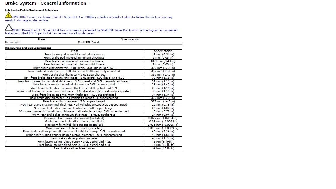

The official JLR brake rotor minimum thickness specs are ridiculously conservative, a whopping 2 mm less than new, see the attached jpg.
This is from the 2010/2011 XFR (X250) Workshop Manual but the same specs apply to the X351.
I suspect you have the 355 mm front brakes and the 326 mm rear brakes, in which case the minimum specified thickness for the front brakes is 30 mm and for the rears it is 24 mm.
Grab a Vernier caliper and measure the thickness yourself, easy enough to do.
Then allow around .25 mm for turning/resurfacing/skimming.
If the rotors will still be in spec after skimming then there is absolutely no reason why they can't be skimmed.
I had the rotors skimmed on my old 2010 XFS (same 355mm and 326 mm brakes) shortly after I bought it in 2013, in preparation for fitting new pads, and I had zero problems.

Thanks for the comments, guys. Appreciate the spec sheet. I'll see about pad deposits. I've had warped rotors before and know what it feels like in the steering wheel. I'll look into finding a shop that will skim the front rotors. My shop only replaces them.
