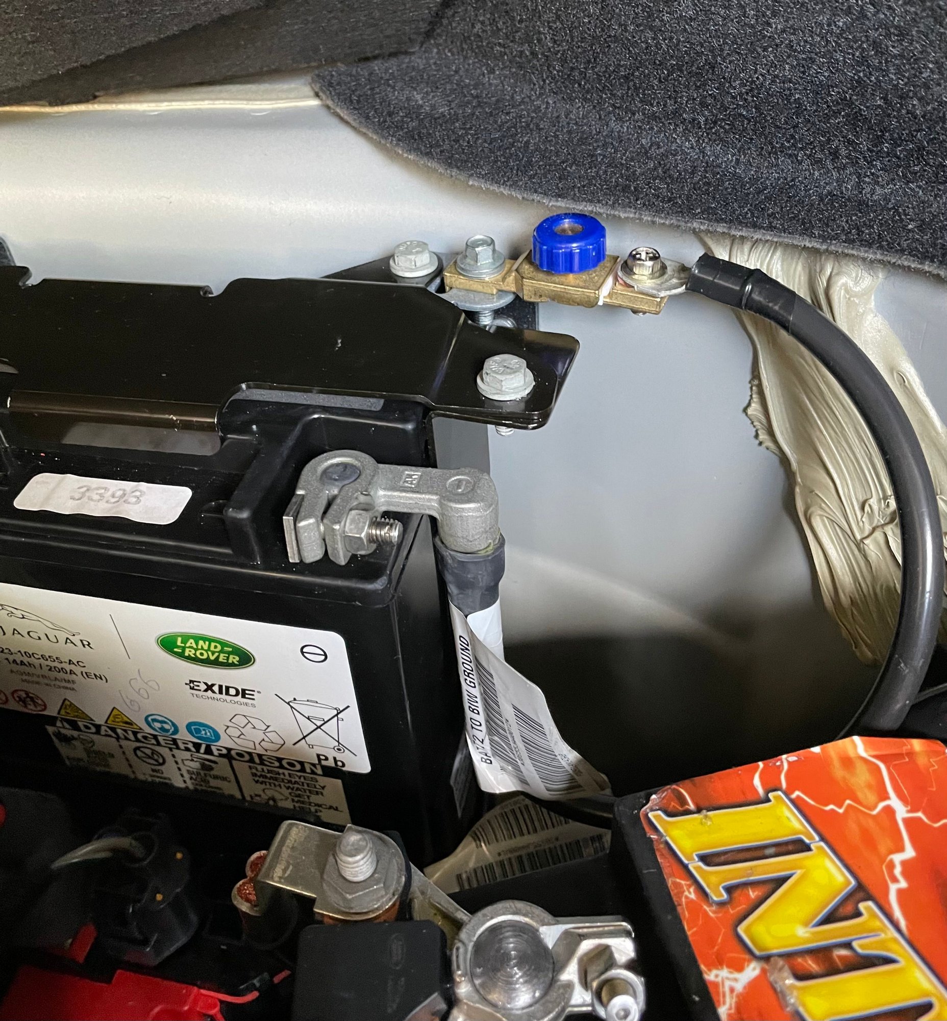

After disabling the eco stop/start, I thought I'd provide the convenience of reconnecting the small battery ground by installing a switch at the cable connection incase I wanted to enable the function ever again.
Old Oct 16, 2021 | 05:32 AM
tjankovs's Avatar
Joined: Feb 2018
Posts: 112
Likes: 35
From: elgin il
Nice addition!
