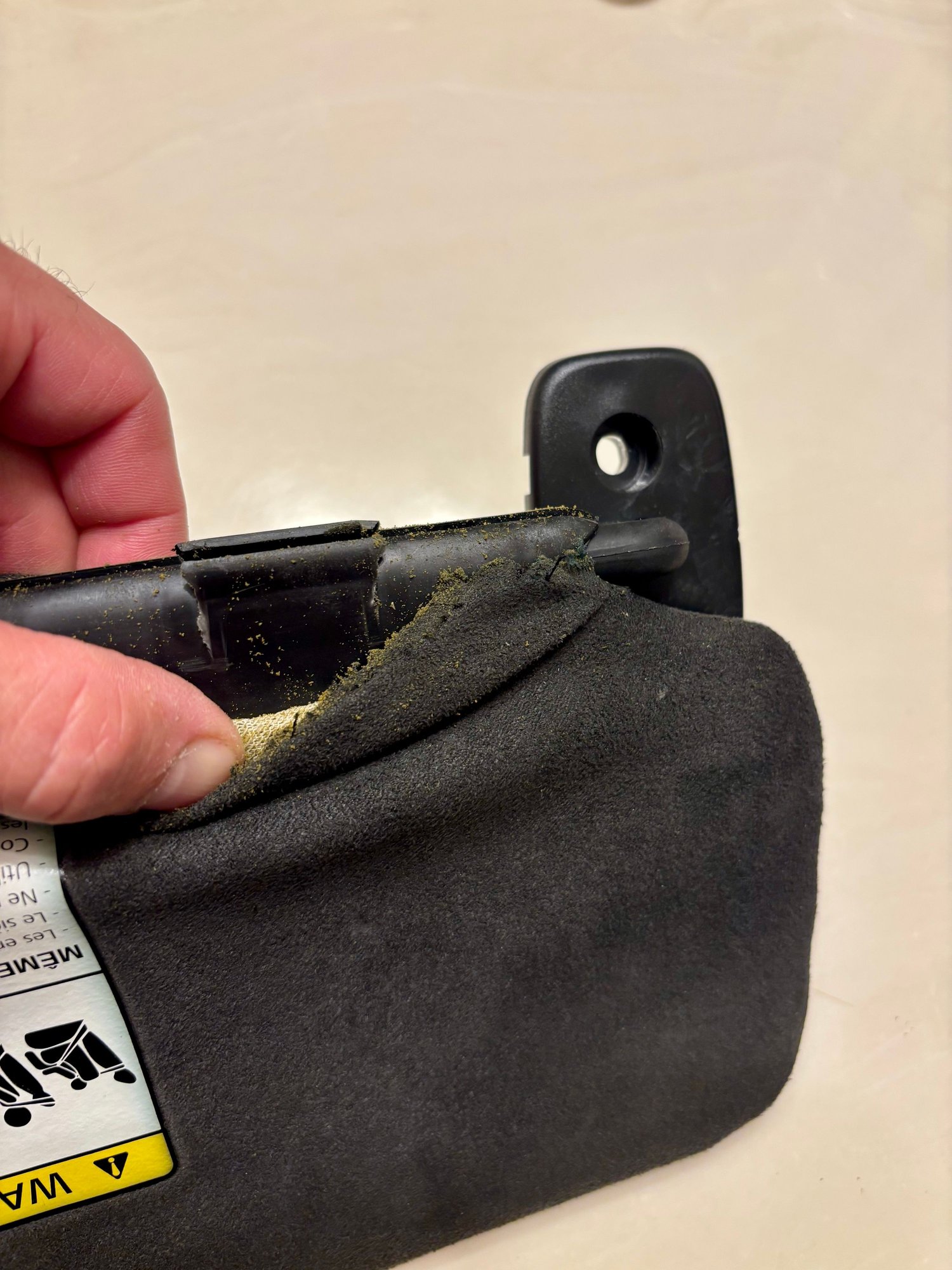

I bought my 2013 XJ 3.0 AWD in 2022 and noticed that the driver’s side visor always settled a bit below the roof line after closing. This year I thought I would use a windshield sunshade to protect my black leather dashboard. This is after all my daily driver, and a slick one at that!
After daily opening and closing that driver’s side visor completely flopped down and the inner metal spring mechanism opened up the top of the plastic creating a bulge in the fabric. I had to swing it to the side to see well enough to drive.
I could not believe that a replacement part with the ebony black Alston suede cloth (C2D34514PVJ) was $750-950 plus shipping! And there are no aftermarket options and rarely a used one available in my trim. Alas, I resorted to a DIY fix.

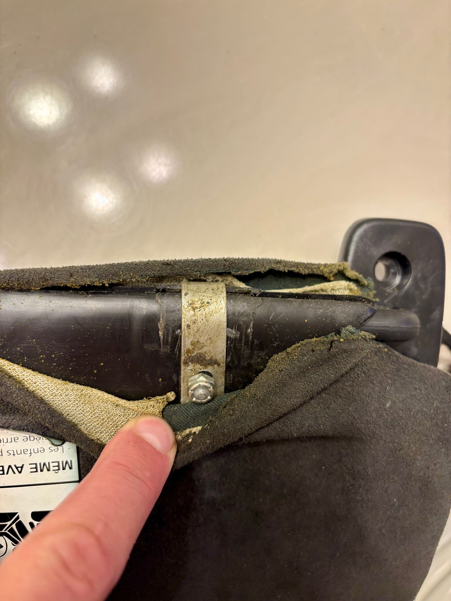

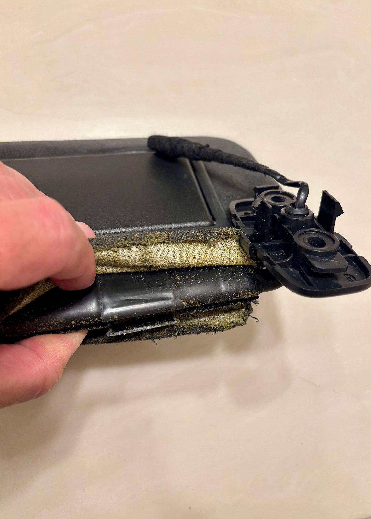

- Cut open seam stitches at top of visor to expose the broken plastic around the metal spring clip. Spread out plastic cover to reseat metal parts inside.
- Drill thru-hole into or under this metal inner piece to anchor a piece of metal banding. This took me a while with the wrong drill bits!
- Repurpose a piece of bicycle handlebar metal clip or banding to wrap around the split plastic top of the visor.
- Using a small screw and locknut, secure the metal clip using the hole drilled earlier. The locknut protrude a bit, but I don’t plan to handle that section very much to wear out the fabric.
- Pull closed the fabric and stitch back using matching thread. My wife’s a pro, but I’m sure you can manage just as well!
