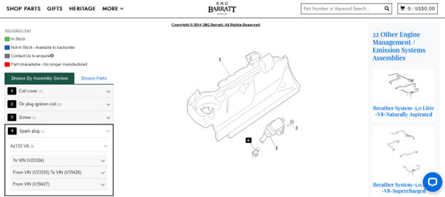

Replace the spark plugs with the same as what is removed. Note the spark plugs are VIN-specific:
https://www.sngbarratt.com/English/#...assembly/34096

Link is for the AJ133 5.0 litre V8:

I have used NGK 93476 Iridium plugs in the AJ133 as replacements for the factory installed spark plugs.
