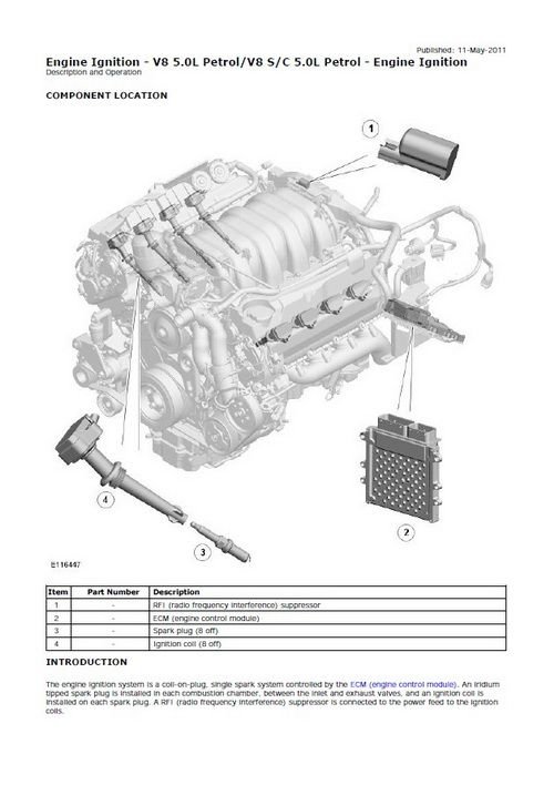

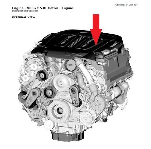

The first challenge in changing them is to FIND them! They are hidden beneath the plastic engine cover. This is secured on rubber grommets and is removed by pulling gently upwards from the rear then front edges :

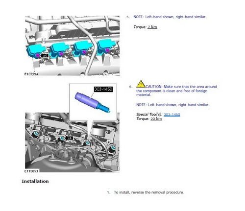

The engine is "coil on plug" so each coil (item 4) must be removed to access the plug beneath (item 3):
A single bolt secures the coil:
Not difficult and doesn't require many tools. However, take great care disconnecting the coil electrical harness connectors.
