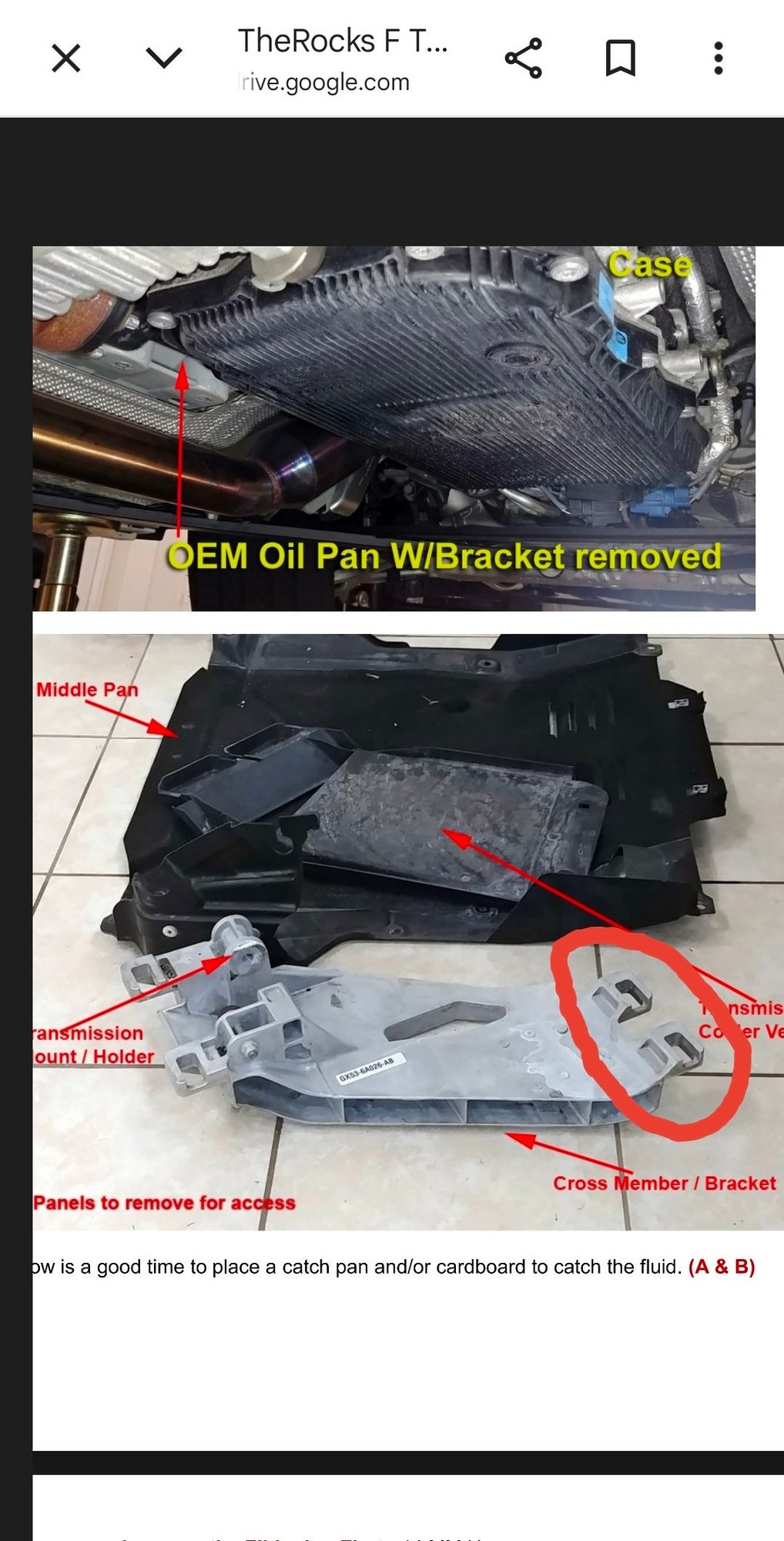

Since I just finished the Transmission Fluid and Transfer Case Fluid Service, and it was still fresh in my mind, I went ahead and put the process in my DIY Template/Format. I was able to re-use many steps from the transmission service, so that was helpful.
I used a couple of tips and pictures from Rondog on this Forum - So Thanks Rondog!
The process can be performed in at least two different approaches, one removing the cross member for access and one without. Each has pros and cons, so pick what works best for you...I tried to document both approaches and referenced steps by using an A or B through the document.
So, if anyone is looking to DIY your Transfer Case Fluid Service, I hope this will help you out. Always check your specific model and specs, and make sure you use the correct parts for YOUR vehicle. Note you only need a 1 Liter bottle of fluid for this.
Enjoy the DIY, and good luck if you try it.
DC
LINK TO MY DIY HERE

Default Bolts spin....
Originally Posted by Therock88
Looks like my original link broke.
THIS ONE SHOULD WORK.
DC
the two bolts on the driver's side of the mid support brace (the one under the transfer case and part of the transmission ) came out about 1/8th of an inch and just spin.... how are they attached up inside there? What is going on?
Old May 5, 2026 | 11:01 AM
DJS's Avatar
DJS
Posts: 7,017
Likes: 2,689
From: Metrowest Boston
SilverFox, I’m sorry no one has responded to this. This is a known issue, captive nuts in aluminum aren’t hard to break free, unfortunately. I recall 3 solutions discussed here. I’ll see if I can find the threads.
1. I recall someone drilling through the floor of their trunk to access where the captive bolts are. Bonus: this gave him an inspection port for the transmission breather tube. Caveat: I hope I have the details right.
2. Coincidentally, I was just reading a thread from a member who spun those nuts loose, then found a somewhat difficult way to change the fluid without removing the transmission support bracket.
https://www.jaguarforums.com/forum/f...-v-8-a-240871/
3. Scott at forum sponsor Velocity AP also ran into this issue, and he posted the method he used, cutting slots to allow access to the spinning nuts.
As it turns out, #1 & #3 are both discussed in this thread.
https://www.jaguarforums.com/forum/f...ervice-213829/
