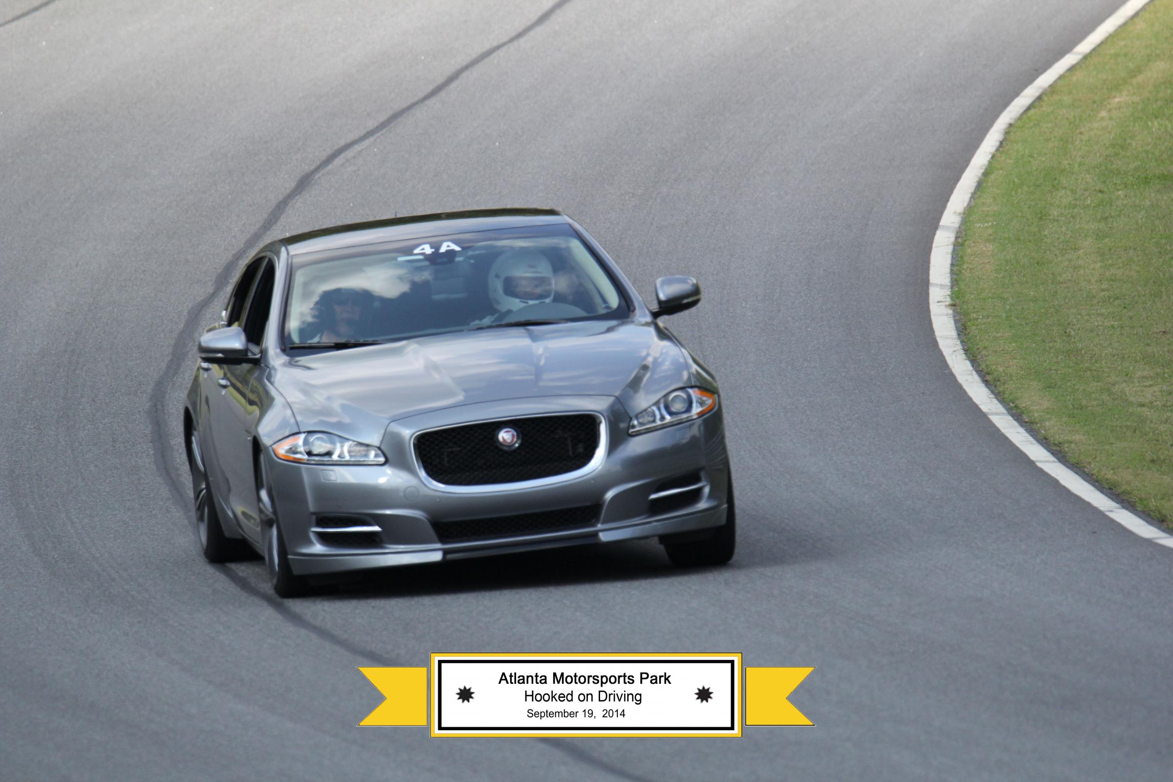

Hi Polarisnavyxj what tires and pressures are you running and have you had the alignment checked? According to your year and model it may have lighter springs and sway bars than were introduced on the 2013 models. If you have a good dealer and a helpful parts guy there ask them to check some of the part# available for later cars. The parts counter can plug in your VIN and find out what your car has now. Again I have found tire pressure (I run 38 to 39psi as is recommended for my model) and alignment are critical to the feel and handling of the XJ. I'll attach an alignment readout that my XJ is set to.
Attached Thumbnails Is there a way to stiffen the ride a bit-amp-group-3-520-copy.jpg
File Type: pdf

I think the 2013 models came out with lighter springs and dampers, per the factory brochures. I know because I had an ongoing ride issue with my 2012 and was trying the 2013s to see if they were different. No real difference in feel, however.
Your alignment values show some of the built-in understeer, that some people may feel as sloppyness. Generally, I would put more front camber into my cars than rear camber. That allows the car to turn in more precisely, quicker. Again, those values reflect Jaguar's conservative take on driving dynamics. Not only they place very small rear sway bars on the cars but, align the car with more rear camber than front. All of my last 5 Jaguars came with that bias. My preference in alignment would be around 1.2 - 1.4 neg camber in the fronts, and somewhat less, around 0.8 - 1.0 negative at the rears. Not sure why Jaguar places less camber in the front driver side. Perhaps that seem to compensate for the driver's weight and resulting suspension compression on that side. I always set all my cars the same left to right.
The best handling Jaguar in my last 5 is the 2010 XKR. Much less understeer than the regular XK or the sedans. The XF is second best, the XJL is third and the two XKs were bringing up the rear. Still, the XKR uses rear springs that are far too stiff, limiting exit traction from corners. Looks like they must have followed the same concept on the F-type as everyone mentions how tail-happy the cars are under hard cornering. Dropping the rear spring rates while increasing the sway bar sizes would do wonders for these cars.
On my XF the max. camber I could get on the driver front was -0.1 degrees. Not really enough for me but, that is all the adjustment gave me. The passenger side would go to -1.3. That is too much variation side to side. The rear cambers are non-adjustable for all late model Jags. (Not sure for the F-type)
