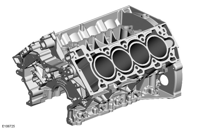

tbird6, I am curious why the motors do not have interchangeable parts. When I was in London talking with the Jaguar engineers, they were saying that the new 5.0L Jaguar engines are made in the same factory as the Ford 5.0L engines and what happens is there is a room in the back of the factory where the Jaguar specialist comes out and gets to hand pick the blocks and heads that he wants and then those parts go into the Jaguar room and the motors are then built there. I will admit that there are a few Jaguar specific pieces (ie, dual intake setup vs single intake for the Mustang, etc), but I think we will find that 99% of the parts are going to be identical. Hence why I am looking at some potential upgrades.
Doesn't make sense, the blocks look totally different
Jaguar 5.0
Ford 5.0

What on earth does the Jaguar AJ133 have to do with the Ford Mustang? Or any Ford product for that matter?
My understanding is the engine is built at a Ford engine plant in Brigend .... but other than that nothing.
That plant does not make Coyote motors. It makes Ford ecoboost 4 and inline 6 engines, and of course Jag engines. It would be foolish to make the Coyote in the UK as well as the Windsor plant in Canada considering all the cars that use it are manufactured in North America. They would have to pay for shipping back to Canada or the U.S. on every motor.
Chris,
There is some misunderstanding. The Jag engine and the Ford engine share virtually nothing in common. They are two completely different engine designs as can be seen in Avo's post. Aside from (maybe) some nuts and bolts, I'd be surprised to learn that any components are interchangeable.
It is true that the Jags tech do hand-select the components for each engine, but it would be fitting (for example) the best suited unique-to-Jag piston for each of the cylinders of the Jag-only engine block. I'm sure the spokesperson didn't mean that the Jag techs were sifting amongst Ford Coyote pistons for a Jag engine.

Certainly the Coyote and the AJ 5.0 d not use the same architecture ... unless you use that term very loosely. They are both 90-degree V8s with overhead cams and I suppose you could call that an "architecture" but if that is the case every modern gas V8 in the world except the Chevy engines share the same "architecture".
The Coyote is a derivative of the Ford modular V8 and I have done quite a bit of work on the modular engines. I am more familiar with those than I am with the Jag V8 but even through casual external view you can easily tell the two engines are completely different.
As for the Ford stickers, it is certainly built in a Ford plant currently. Now Jaguar (and to lessor extent some Jaguar owners) are specific that this is a "plant-in a plant" and that it is "Jaguar people" not Ford that is building the engines. I think a lot of that is semantics for the purpose of maintaining the aura of exclusivity. Ford darn sure isn't letting Jaguar build engines in their plant for free, so either they are leasing plant space or there is some kind of joint production arrangement between Ford and Jaguar. I would tend to think it is the latter as that would simplify the logistics and supply chain.
I will also add that while there are very few (if any) common parts between the Coyote and the AJ series engines there are many similarities and common parts between the Jaguar AJ engines and the mid 2000s Lincoln/Thunderbird AJ V-8s that were built in Ford's Lima Ohio engine plant. So Ford has produced V8 engines similar to this before for their own cars, the Coyote just isn't one of them..

True they are assembled in the same plant but they were designed by two different groups at two different companies a bunch of time zones apart.
I happen to own a 4.6L DOHC modular Ford engine which is the grandfather of the 5.0L coyote. When comparing it to the 4.2L in my S-type, grandfather of the Jag 5.0, it's hard to believe they have any corporate parentage at all.

I don't think any of the AJ V8s (3.9, 4.0, 4.2 or 5.0) and the Ford Modular V8s (4.6, 5.4 and 5.0 Coyote) have ever been built in the same plant.
The Ford modular V8s are all built in Romeo Michigan plant and the Windsor Ontario plant. With the Coyote specifically only being built in Windsor. In the 90s there were some Aluminum block castings made in Italy but these were still shipped to the Windsor plant for assembly.
I think the AJ V8s have all been built in either the Brigend UK plant and previously in the Lima Ohio plant for the T-bird and Lincoln.
What may be confusing people is there are other Jaguar/LR engines which are not only Ford sourced but are "mainstream" Ford engines. Those include the 2.0L petrol 4 cylinder turbo (AKA Ford Ecoboost) and the V6 through about 2011 (AKA Ford Duratec).
