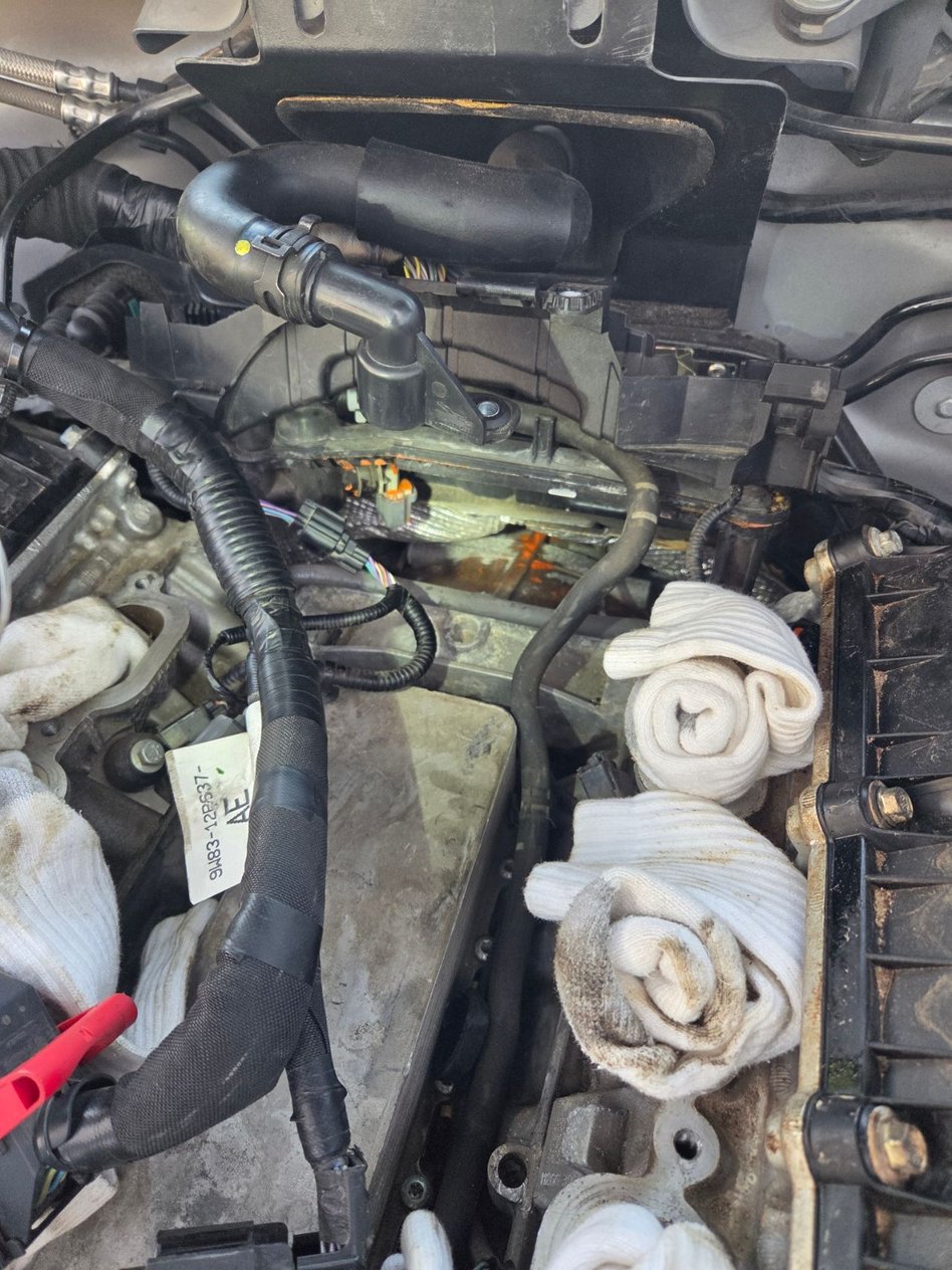

Well, happy to report the blower is off. My Good Night, what a sardine can. Just a brief refresher, I picked up this car as a replacement, insurance bought us this one. tough to find even in the LA market. it was shipped from Houston. I thought I was wise to look for one that had aluminum coolant replacement pipes, turns out only the front ones were done on this car, the rear is split and it looks like someone has put 10 gal of coolant in it, it looks like there is dried Florissant paint everywhere. Man I was hoping this was better cared for. What is the element behind the SC? Is it common practice to not put the 3 screws in that hold that unit back on? Also finding a lot of what seems to be loose bolts. I know I'll have actual questions but just a little tired right now

Hard to say? Can you post pictures? You have enough posts now.
If the plastic split that is common and does not point to a maintenance problem as all this plastic stuff is good until it is not! Hard to say when it will fail so when should it be replaced?

Hello again
Hopefully those with the knowledge I need will take a look at this tread again and give advise. I have pulled the plugs and without looking at the cylinders with a borescope, the #7 plug was wet. I can get ahold of a scope if I need to do more than just verify witch injector had gone. I have a compression gauge left over from the days of my 327 SS. I was able to use some copper tubing to extend the reach of the head to get a good seal on the plug hole. Please refresh the memory, I think we used to use a remote switch on the starter to check compression? In anticipation of replacing the valve cover gaskets, I puled all the connecters and the loom on both heads. I mentioned that because I'm not so sure about doing a compression test on a computer controlled engine, with all the sensors disconnected, is there a concern?
Another question, there is a module on the back of the blower, some kind of vacuum advance, trying to get an idea I looked at some utubes and saw folks pulling that before removing the blower, once out, it looks like all there was needed to let it come out together was an electric connector. Sense I have enough post to add pictures, I will.
And then this unit that attaches to the back of the SC. anyone have a name for it.
Other than the vacuum hose it wasn't mounted it was just hanging. would like to find bolts without having to go to the dealer. Also it was suggested to not use the tube to drain the oil, I don't have a lift so it's on jacks, is there a plug or do I need to get as new gasket?

The plastic part that split in your photos is the rear coolant/heater manifold, common for these to fail also and the aftermarket can sell you an aluminum replacement. Use the OE seals in my writeup earlier in this thread.
That black plastic hose assembly is the sound symposer, for "cosmetics" only and has nothing to do with engine performance. You'd need to block off the opening to the intake manifold with a laser cut plate if you want to fully delete it. Seriously, it makes no difference in the interior sound at all.

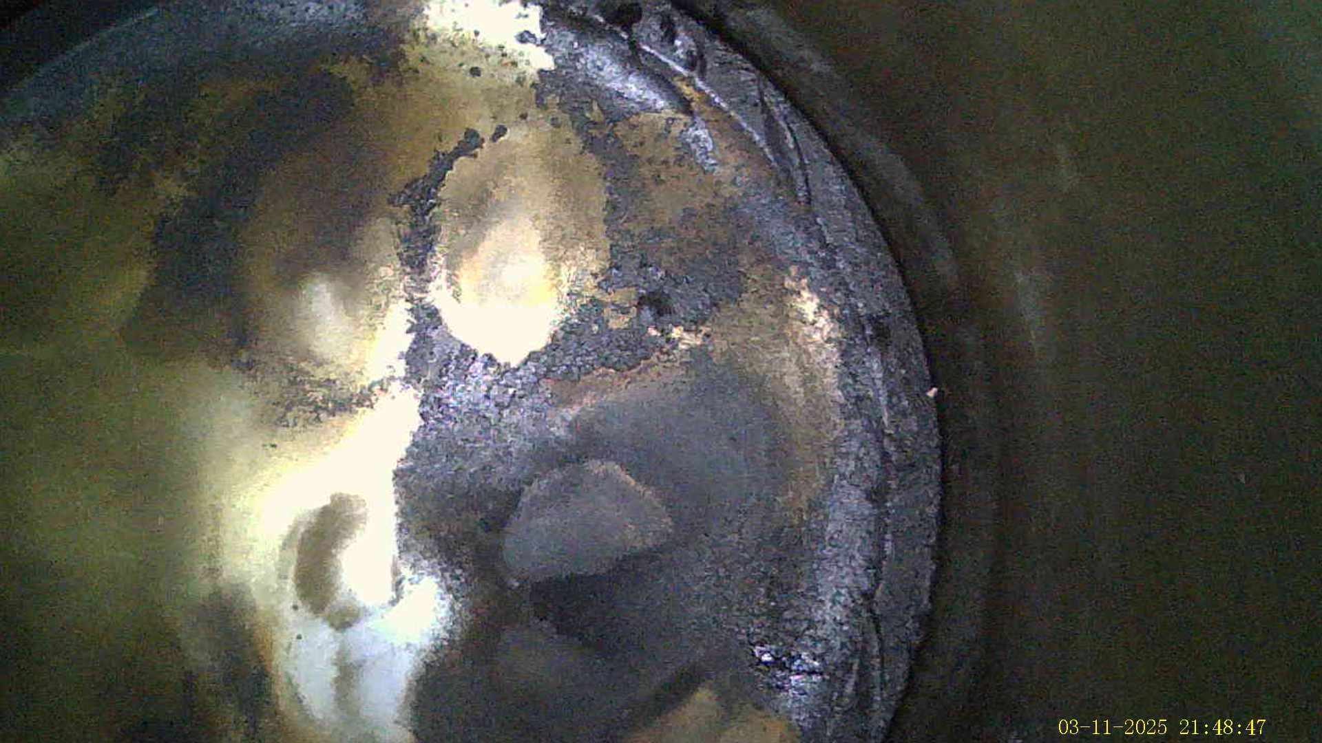

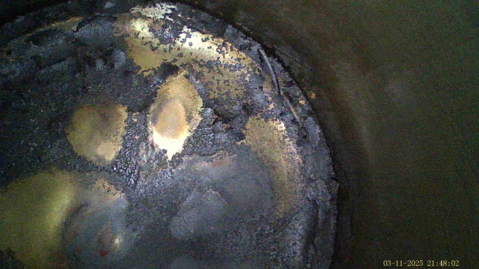

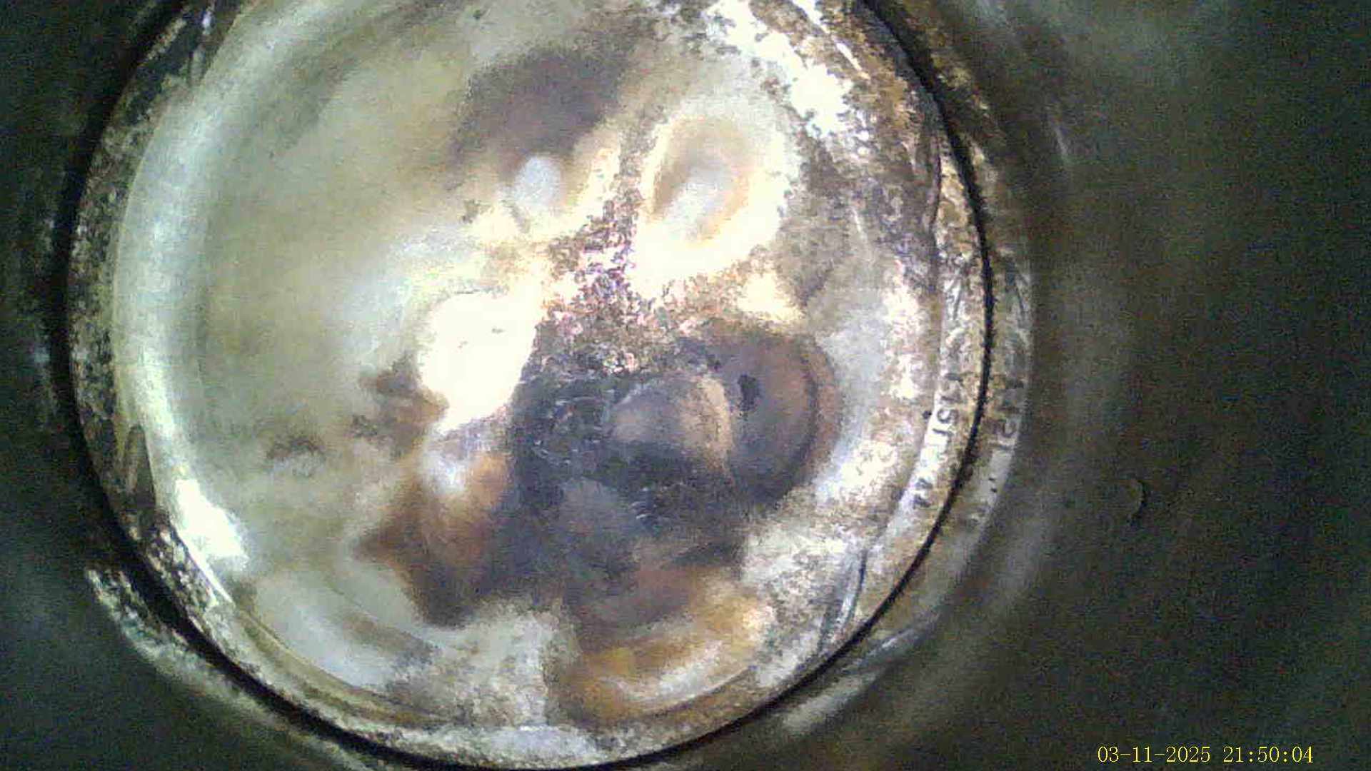

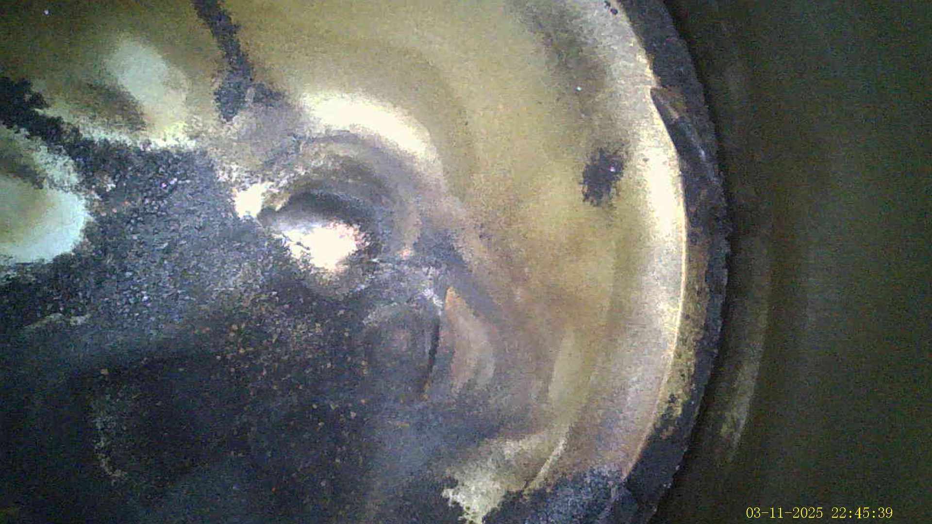

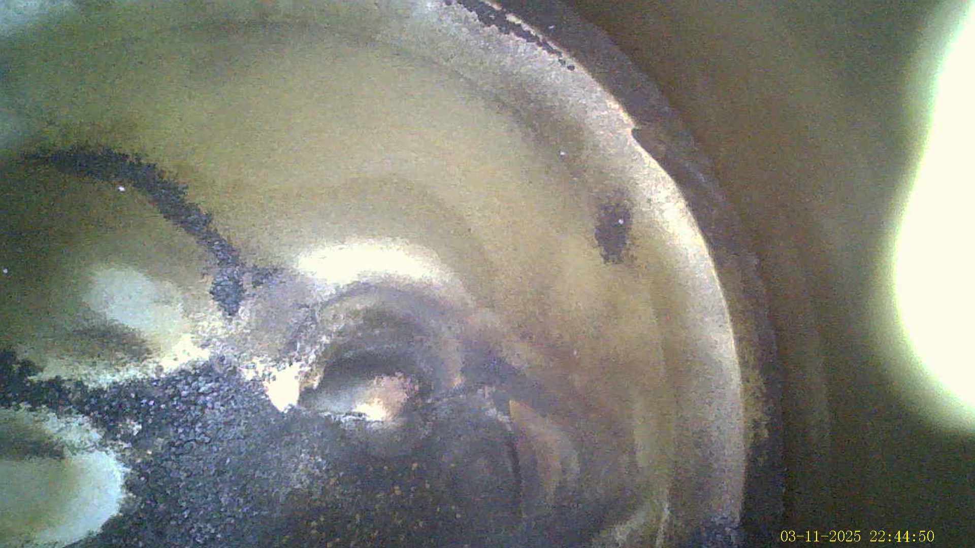

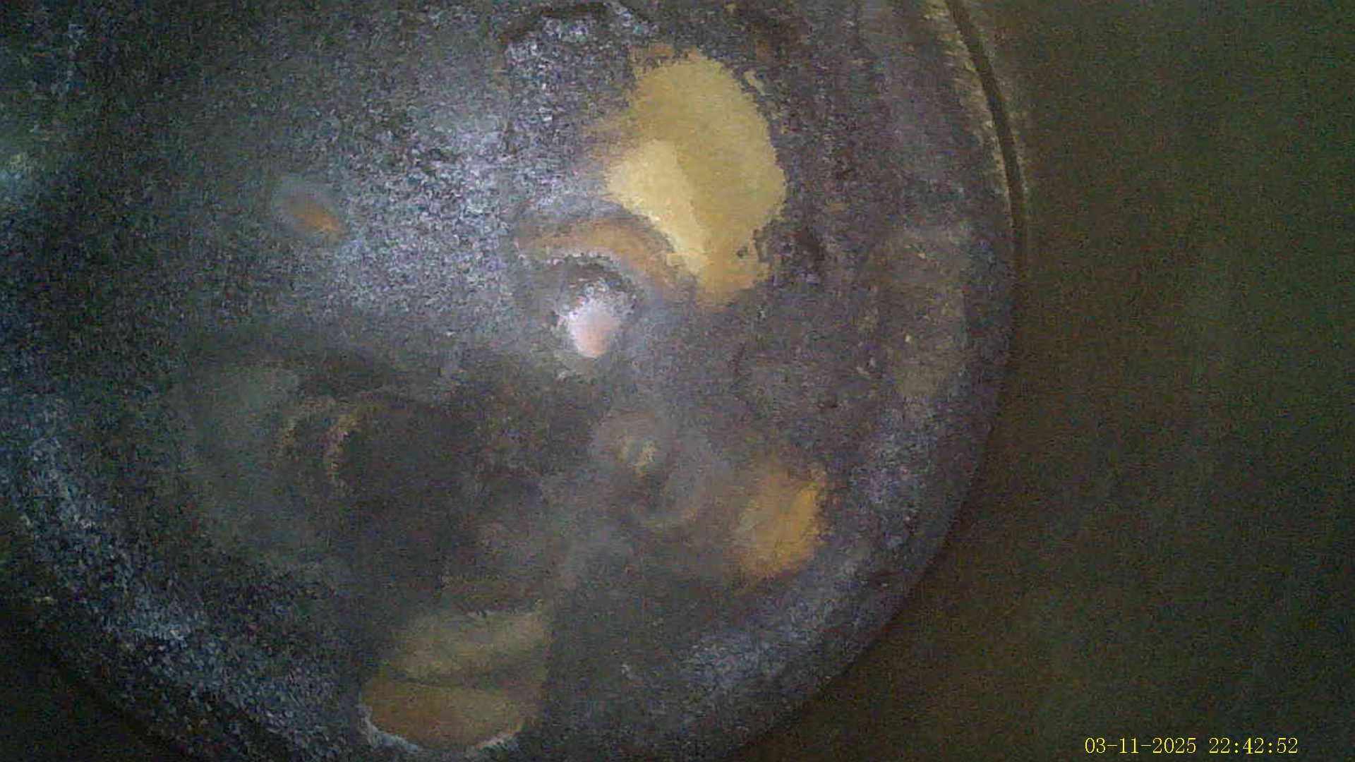

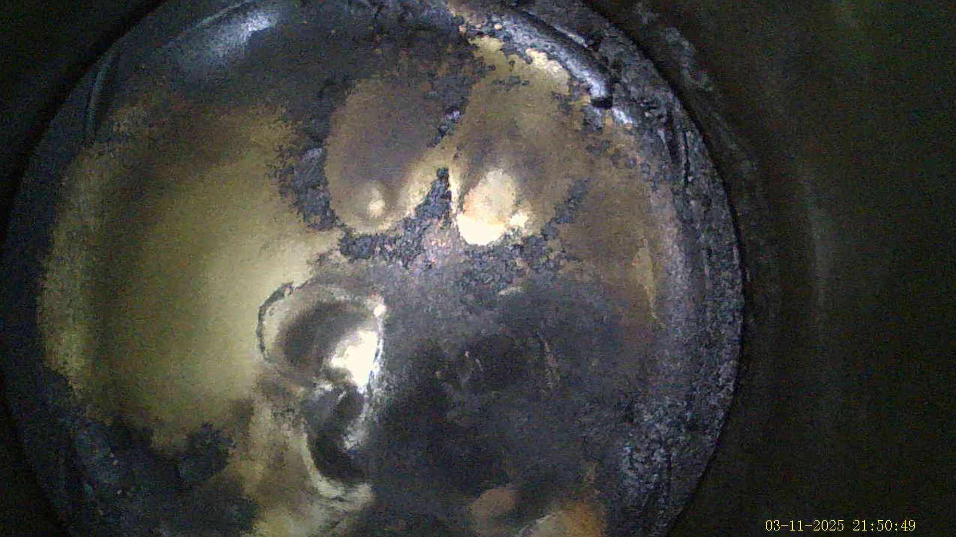

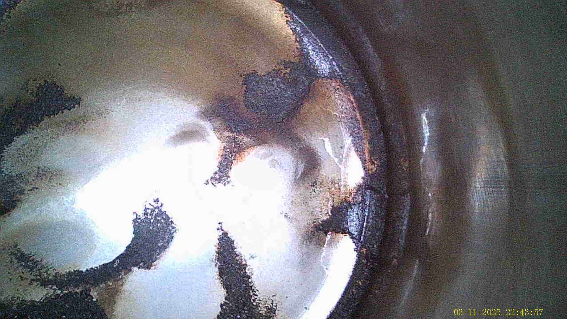

It still amazes me how much carbon builds up inside an engine. Here are pics from the borescope. Anyone want to render a guess on which pic is the cylinder that had the stuck injector?
Again this is not a car that I've had for very long. That said, Do you think if it was better maintained with additives it would be any cleaner?

So as I'm getting ready to run a compression test I thought to my self, maybe because I have the scope, before I squirt a bit of oil into the cylinders, just to give friction a break, I'll take a peek in on the other bank. here's what I found.
Does anyone think that #2 cylinder looks like #7 is the previous post? Has anyone ever heard of two injectors going at the same time? Sorry the images are so big. Any thoughts?

I was getting ready to run the test and report them to you, Trusting your advice could you take at my last post?

None of those pictures look especially concerning but does the car ever get driven hard or is it generally babied? It may be time for the good old Italian tune-up and I would run a can of BG44K through the fuel system also.

@CuteCat, as others have mentioned, there doesn't appear to be anything in the photos that suggests anything other than a stuck injector.
I'm sure you're aware that when one injector fails by sticking open, the other injectors then receive less fuel.
If you already have the vehicle on jack stands, it may be best to remove the lower engine cover and use the drain plug to change the oil to make sure any fuel present is removed. Also, once the engine oil is drained, it may be wise to also see if the vacuum pump at the front RH side of the engine is leaking. There is an aftermarket kit you can use to reseal the pump if the cover isn't distorted. A new pump from a JLR dealer is in excess of 600$US. Two different types of vacuum pumps were used, just make sure you order the correct parts to reseal it. Here is a link to the reseal kit: https://www.rkxtech.com/products/rkx...-rr-superchrgd
