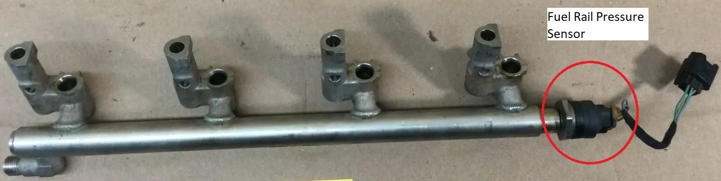

Most certainly not just a single injector or injector related directly at all.
This does not smell like another injector just failed—it smells like a fuel control / rail pressure / sensor logic problem that causes multiple cylinders to misfire, especially after a hot soak.
P0301 / 303 / 305 / 307
All odd-bank cylinders (Bank 1 on the V8)
That immediately points away from a single injector
Injectors fail randomly, not neatly in a bank pattern.
P0300 – Random misfireECM is losing control of mixture or combustion stability
P00C6 – Fuel pressure too low during cranking
This is the smoking gun, and people underestimate it.
This means:
The actual rail pressure didn’t match the commanded pressure
ECM is blind, confused, or lied to
The strong fuel smell matters a LOT. Low reported pressure + strong fuel smell =The engine is NOT fuel-starved
That means one of three things:
Fuel pressure is actually high, but the ECM thinks it’s low
Fuel is leaking after shutdown (internal or purge-related)
Fuel trims are being driven stupid by bad sensor data
High-pressure fuel rail pressure sensor (lying)
Very common on the AJ-V8s.
If the sensor:
Under-reports pressure, ECM commands more fuel, Cylinders flood, Misfires on restart, Fuel smell everywhere.
This ALSO explains:
P00C6
P0316
Multi-cylinder same-bank misfire.
Could be purge valve stuck open or HPFP control / rail bleed-down. This is less common than the sensor, but possible: pressure drops when hot, ECM overcorrects flooding on restart.

My 2 cent: Never trust an pressure (or temperature) sensor reading from system alone. Have external pressure meter attached and compare the readings.

Yes the engine has a fuel temperature and pressure sensor on the passenger side fuel rail at the rear of the engine.
There is also a low pressure fuel pump in the tank and that also has a fuel pressure sensor.
I agree with measuring the fuel pressure separately but with these DI engines that is not a simple task and I don't have a 2000+ psi gauge either. So not exactly sure how to do it other than using SDD.
Is the car blowing clouds of white smoke out the tail pipes?
One thing that Jaguar always did when this happened under warranty was to replace all the injectors on that side of the engine. Even if you only getting codes for one or two cylinders. Not sure why but JLR was consistent in that. Note your miss fires are all on the odd numbered cylinders which is the passenger side bank. I would change all 4 injectors on that side.
Can you post pictures of the counterfeit injectors? They can only be counterfeit if they have been replaced before?
Can you measure fuel pressure in any way? I would not worry about too much pressure as all those type of things will set various codes.
Is the car still showing the above codes after you have cleared them?
We want to chase what the car thinks is going on.

That OEM fuel pressure sensor is unobtainium. I replaced mine with a superceded Bosch part number available on RockAuto but the OEM part number I cannot seem to find.
Or, as some of us do, another option is used from eBay, especially if you can verify that the vehicle came off of was. Good rule of thumb, if it's sitting in the junkyard but wrecked, it was running just before that incident. I very often buy parts like this from eBay for all of my vehicles, including my four jags, and I can't think of but one single instance where there was a problem from the get-go and it was an easy return. When we live in a world and drive vehicles where so many OE parts are unavailable, new any longer, to me. Anyway, the super cheap price and OE equipment is a better gamble than even a good name. Aftermarket for most things, not everything. Mind you but most things.
For the AJ133 from VIN V39427, the JLR part number is C2Z22844. The earlier VINs use JLR part number AJ812513.
