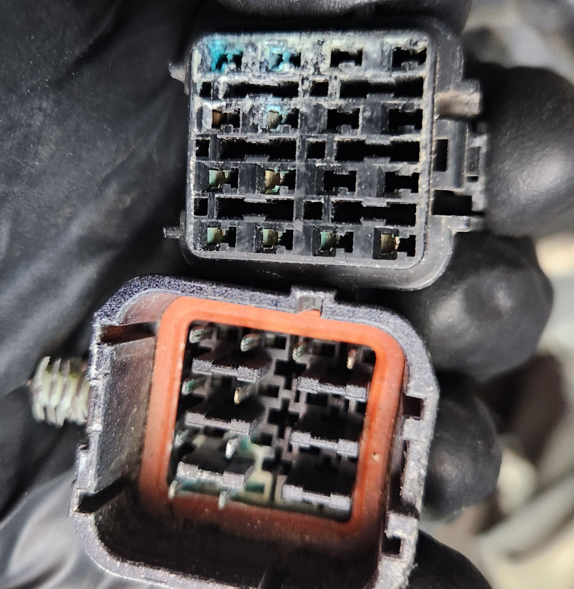

May not be your problem but my 2015 XJL had a TPS warning from the time I purchased the car. The problem was the connector that is located under the front left side fender liner. (Driver side on US car) The connector had gotten water in it and caused the system to fail. That connector connects the front TPS receivers and front proximity sensors. Once I cleaned it, everything started working.
